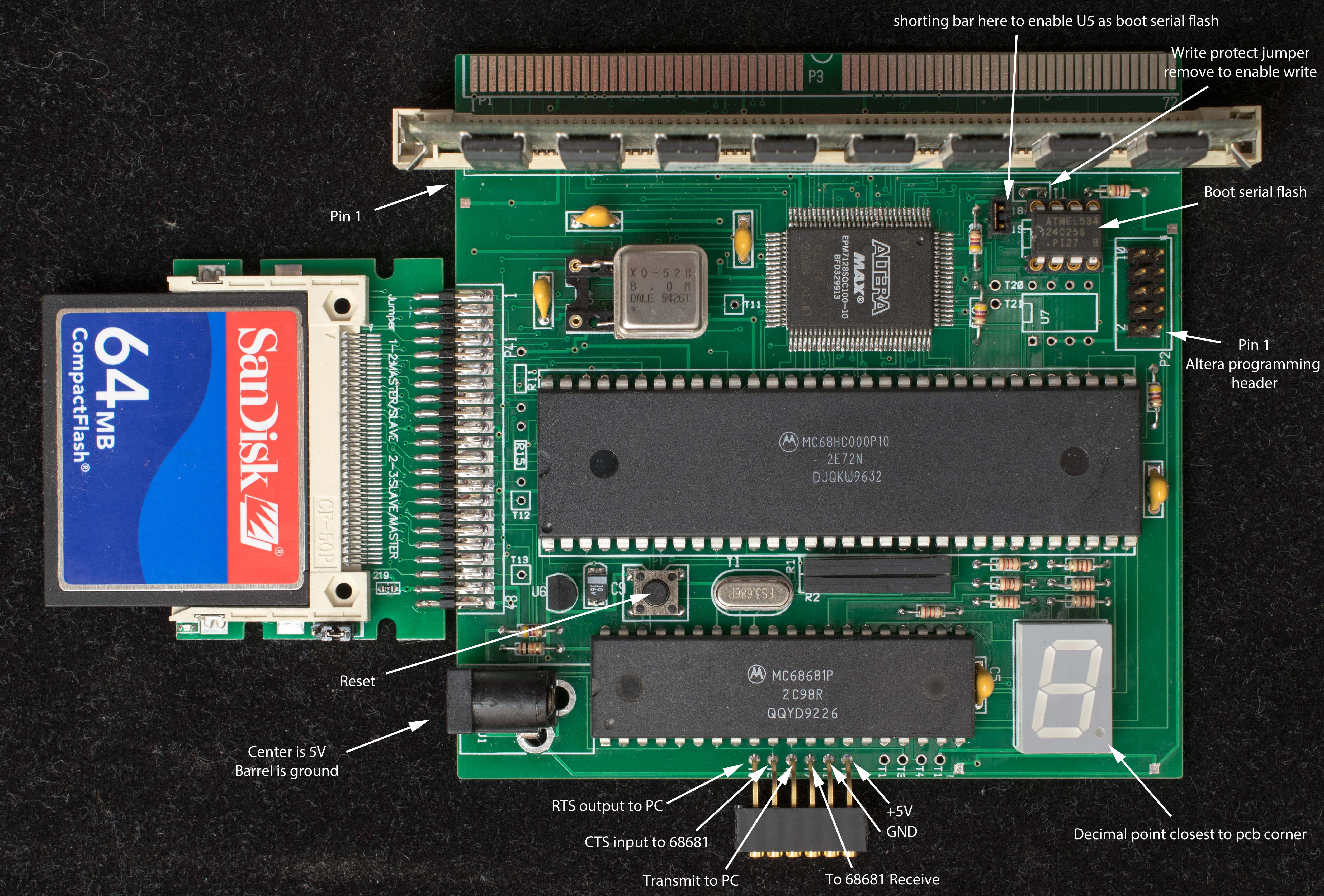

Tiny68K is a high-performance yet low-cost single board computer based on the Motorola 68000. Tiny68K has two unusual features:
- The entire 16-megabyte memory space of 68000 (except the top 32Kbyte of I/O space) is filled with RAM,
- The boot software residesin a 32Kbyte serial flash that is copied into the lowest 32Kbyte of the DRAM when powered up or with a reset. The RAM-resident boot software can be modified just like any data in RAM but is overwritten on the next power cycle or with a reset.
Figure below shows an assembled Tiny68K.

Photo below is an annotated assembled board

Apply 5V to the board via the 2.5mm power jack, the center is 5V, barrel is ground. The nominal power consumption at 8MHz system clock is 500mA. When powered is applied, the 7-segment LED will display '8' for a second and then '6'. While waiting for console command, the outer segments of the 7-segment display will flash for 1/2 second, one segment at a time, in a circular sequence. If the display indicate a static '4', it is waiting for hardware handshake signal to assert. Be sure the terminal program has RTS/CTS hardware handshake enabled.
