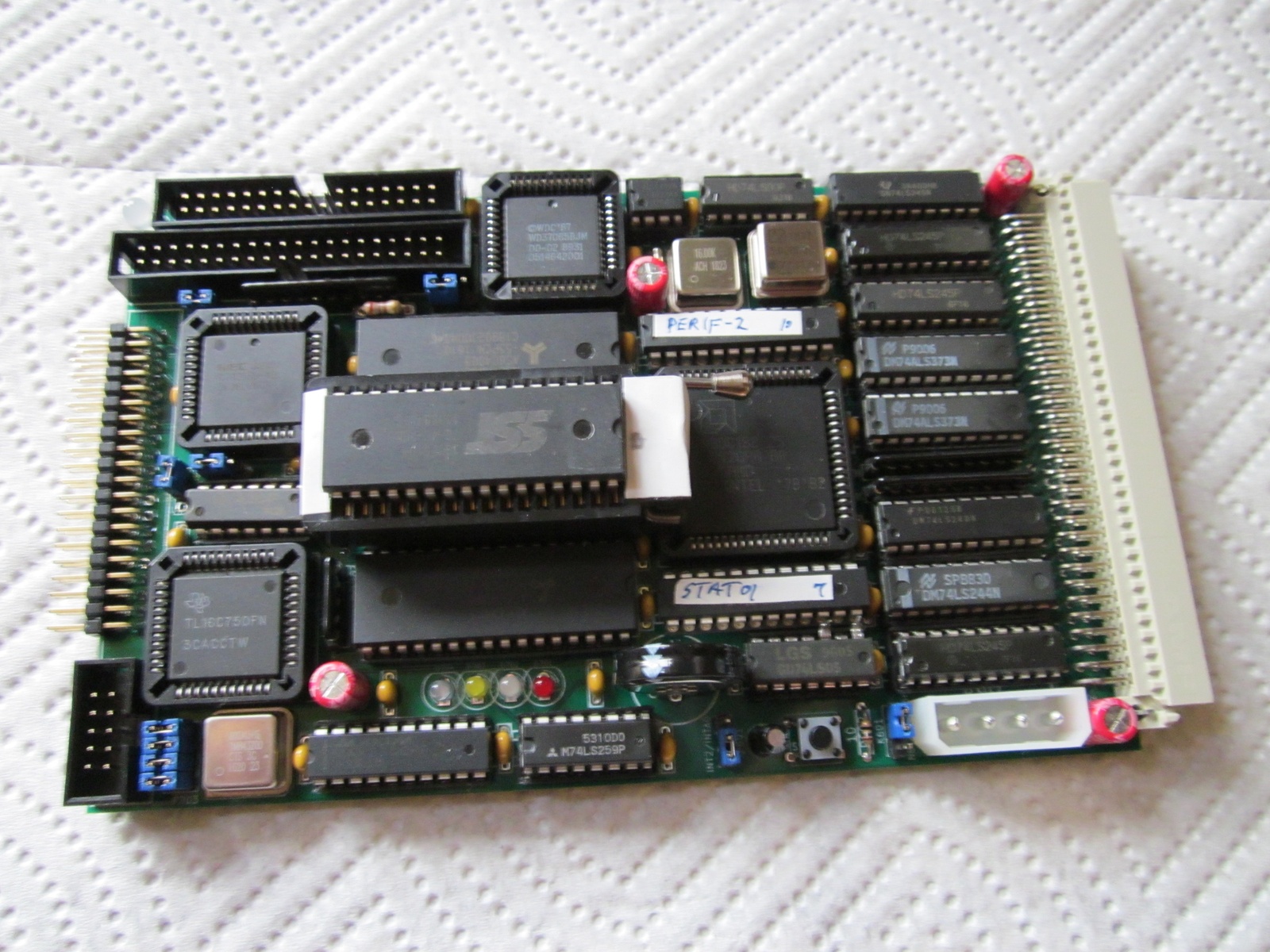

Here is the completed 3.2 version of the board:

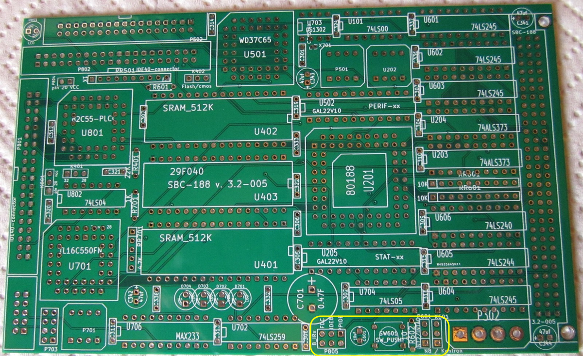

The bare 3.2 board layout, showing updated area:

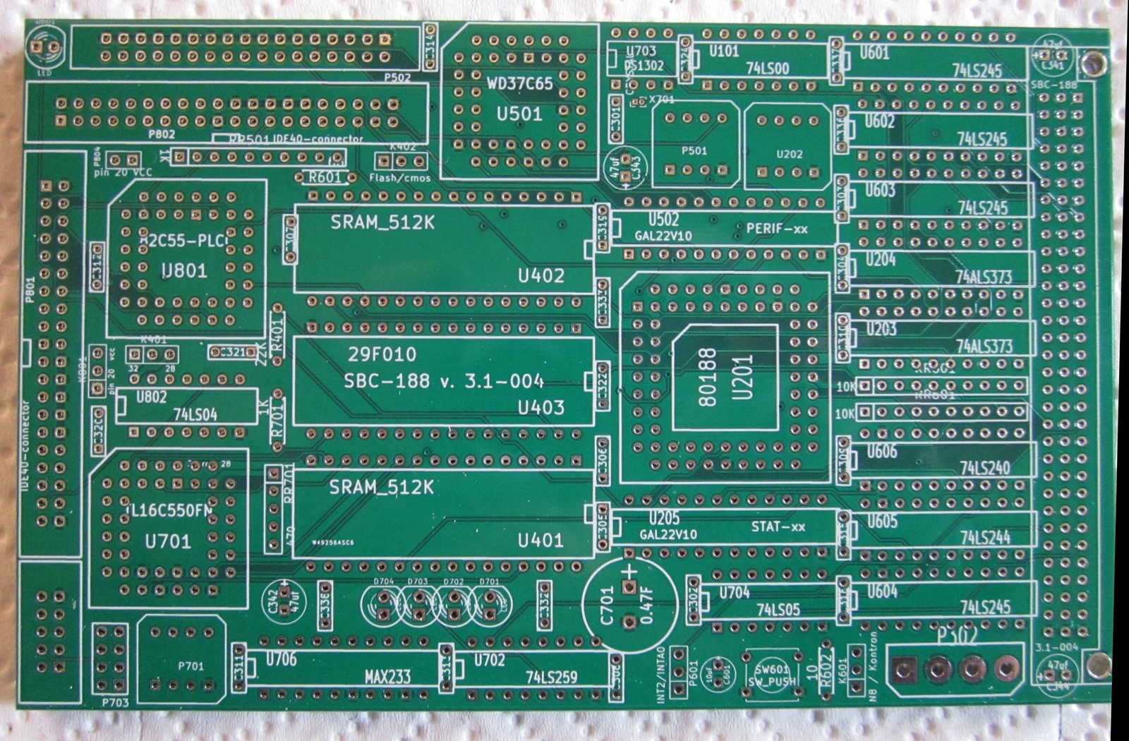

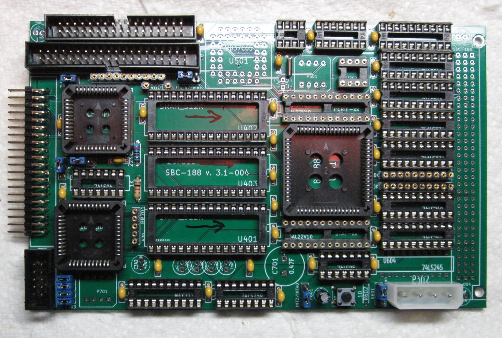

The 3.1 Bare Board
Finished board, ROM in raised ZIF socket for BIOS development & checkout:

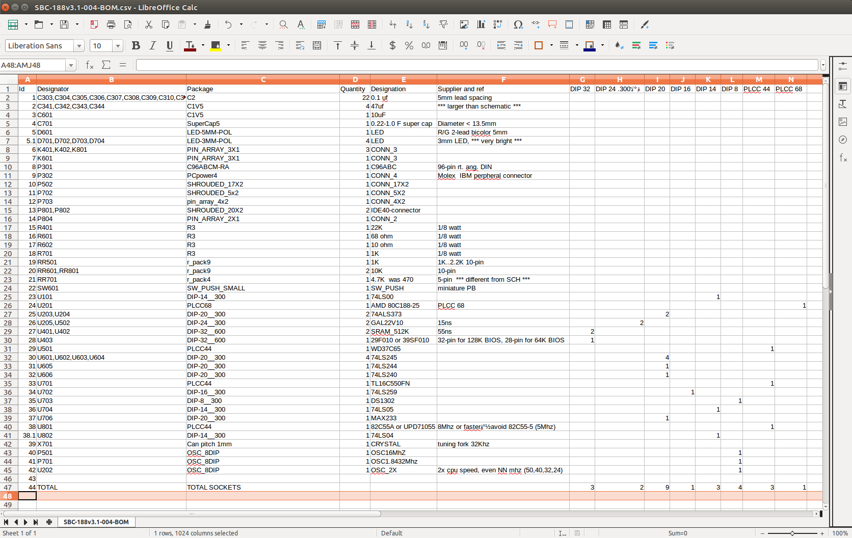

The BOM for the 3.1 and 3.2 boards are the same except for the addition of the 3×2 pin_array.

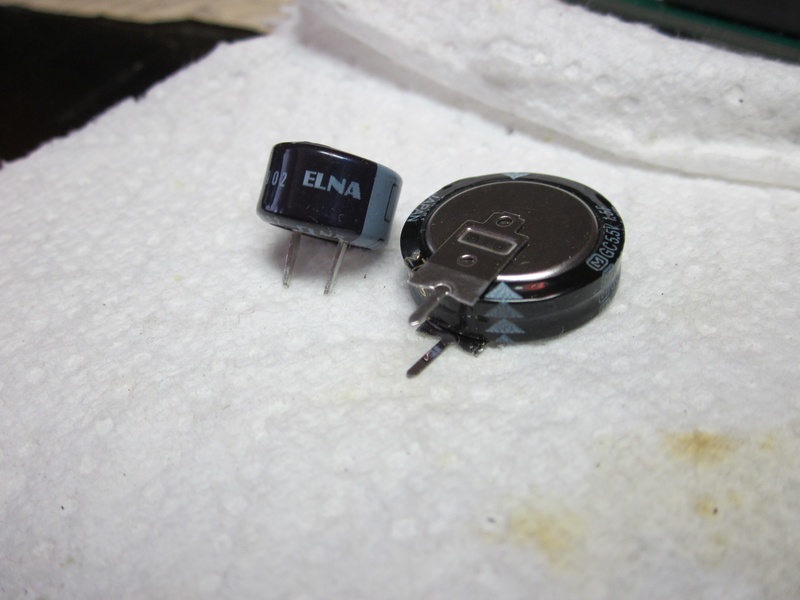

The two types of Super Capacitors may be used for the RTC/NVRAM backup. Second photo shows 13.5 mm diameter cap; third photo shows a vertical mount. I used this 1.5F cap, and consider that value too large: I had to leave the board powered up overnight to get enough charge in the cap to bring the voltage above 2 volts. The good range would be 0.22F up to 0.47F. The cap in photo 2 is 0.33F.

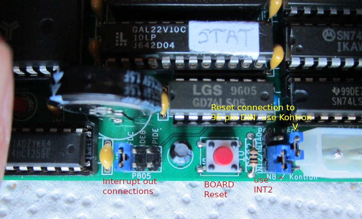

Left photo shows the normal jumper setting for the RS-232 interface to allow RTS/CTS line protocol. The right photo shows an alternate setting which crosses RTS-CTS to DTR-DSR. This is for terminals that use the obsolete DTR/DSR line protocol. However, the programming within the UART is still RTS/CTS. If you have any doubt about which setting to use, use the one on the left.
The left photo shows a rather odd jumper (P601) labeled “INT2/INTA0”. It should always be set to “INT2” (1-2); the other setting (2-3) is for a possible future use. In the middle is jumper (K601), the “Legacy/Kontron” Reset setting. In the Legacy setting (1-2) reset is put out on DIN pin C31; with the Kontron setting, DIN pin C31 is a Reset switch input to the CPU board, and the Reset signal is correctly put out on DIN pin C26 (RESOUT). All peripheral boards should also use the Kontron setting. (Kontron, a German firm, manufactured one of the earliest Zilog Z80 computers that used the 96-position DIN connector, and this was the intended pin usage.) The right photo shows the rearranged area for the 3.2 board. The INT2 and Kontron jumpers are to the right. The 3 possible interrupts that may be generated may be connected or disconnected at the 3×2 header to the left (right photo, 3.2 board). The FDC interrupt is connected if the Floppy Disk controller is present. The two IDE interrupts are generally not connected since the current BIOS code does not look for those interrupts. They are available for use by software other than the BIOS. The presence of the 3×2 header removes the need on the 3.1 board to bend pins up on the 74LS05 to disconnect these last 2 interrupts.
The middle and right photos also show the IBM peripheral connector, which may be used to power the board as a truly Single Board Computer, SBC-188.
The above jumpers are common to the 3.1 and 3.2 boards and are in the exact same locations.

The left photo shows a rather odd jumper (P601) labeled “INT2/INTA0”. It should always be set to “INT2” (1-2); the other setting (2-3) is for a possible future use. To the right is jumper (K601), the “Legacy/Kontron” Reset setting. In the Legacy setting (1-2) reset is put out on DIN pin C31; with the Kontron setting, DIN pin C31 is a Reset switch input to the CPU board, and the Reset signal is correctly put out on DIN pin C26 (RESOUT). All peripheral boards should also use the Kontron setting. (Kontron, a German firm, manufactured one of the earliest Zilog Z80 computers that used the 96-position DIN connector, and this was the intended pin usage.)

The updated area on the 3.2 board is shown. P601 (INT2/INTA) is moved to be next to K601 (N8/Kontron). P805 (FDC, IDE8, PPIDE) takes over where P601 was located. It connects the interrupt outputs to the corresponding interrupt inputs on the CPU. FDC jumper is installed if the FDC controller is installed. If there is no FDC controller, then this jumper should be left off. If the IDE8 or PPIDE interfaces use interrupts, then the corresponding jumpers will need to be installed. Since the BIOS does not use interrupts on these interfaces, the normal setting will be with the jumpers off, as shown. This jumper block, P805, eliminates the 3.1 board errata, which requires disconecting the interrupts by bending up pins on U705 (74LS05).
