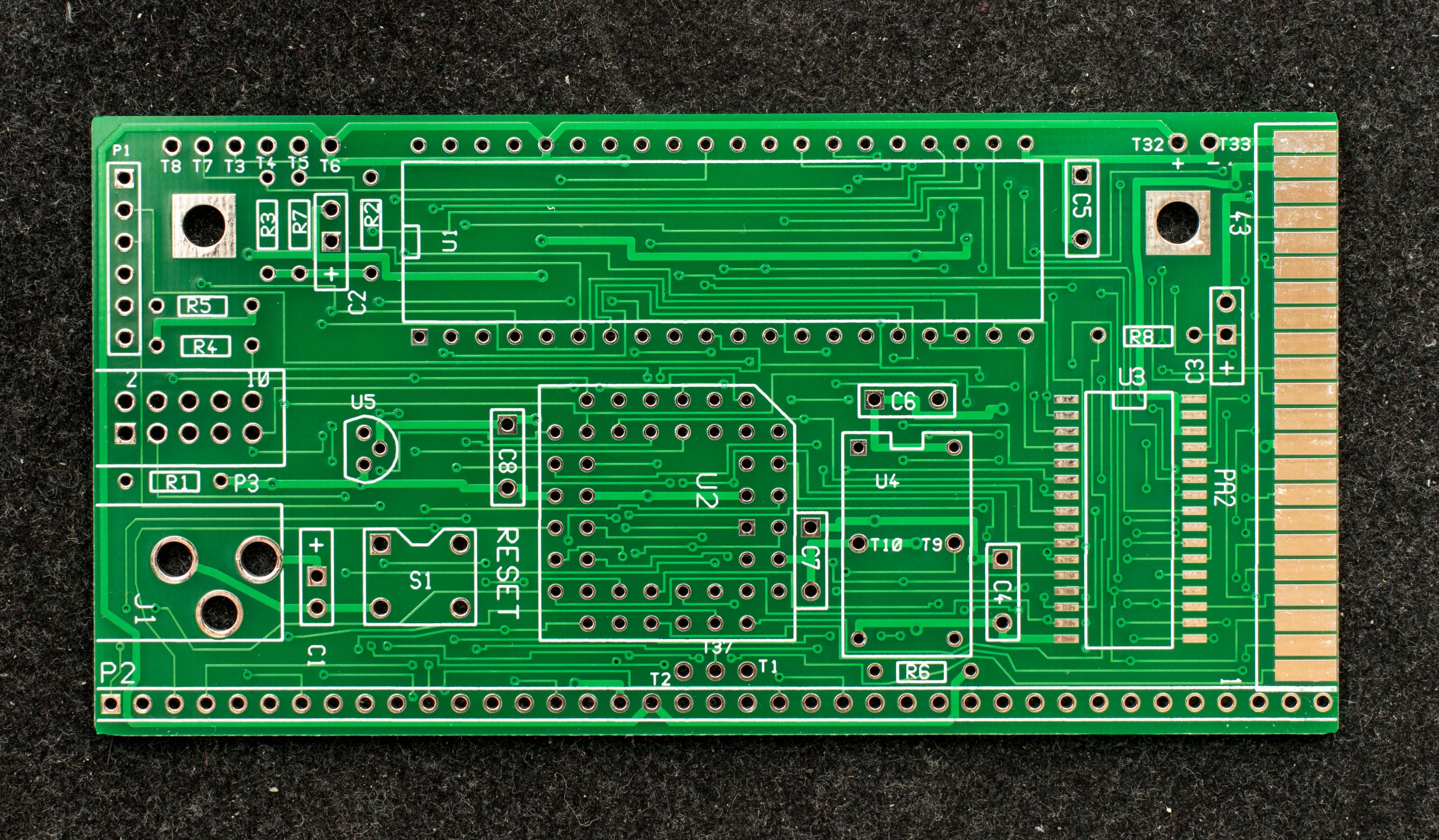

Blank board, component side.
www.retrobrewcomputers.org_lib_plugins_ckgedit_fckeditor_userfiles_image_builderpages_plasmo_crc65_assembly_dsc_62880121.jpg
Blank board, solder side
www.retrobrewcomputers.org_lib_plugins_ckgedit_fckeditor_userfiles_image_builderpages_plasmo_crc65_assembly_dsc_62890121.jpg

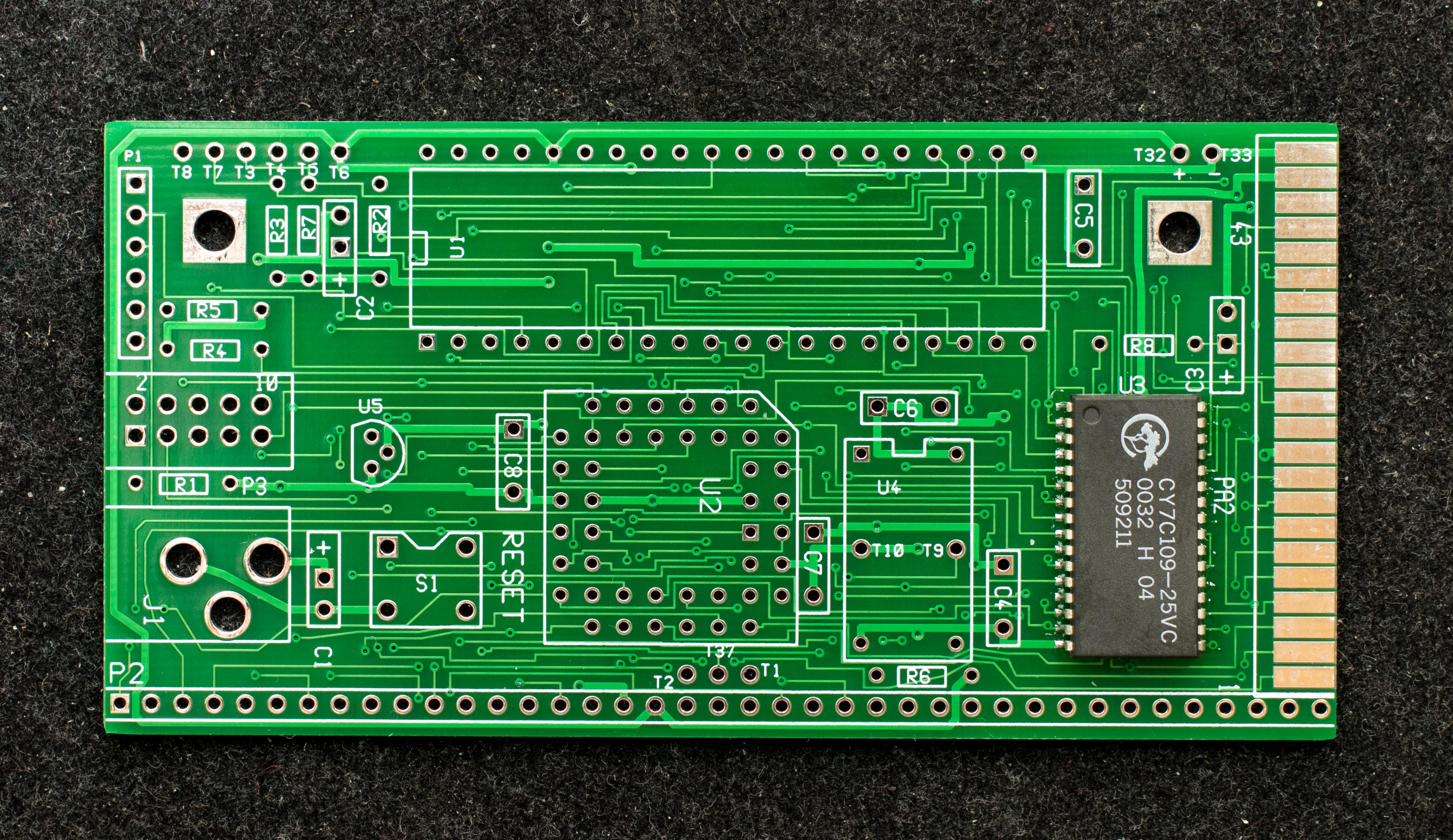

Assemble the SOJ32 CY7C109 RAM first,
www.retrobrewcomputers.org_lib_plugins_ckgedit_fckeditor_userfiles_image_builderpages_plasmo_crc65_assembly_0dsc_62910123.jpg

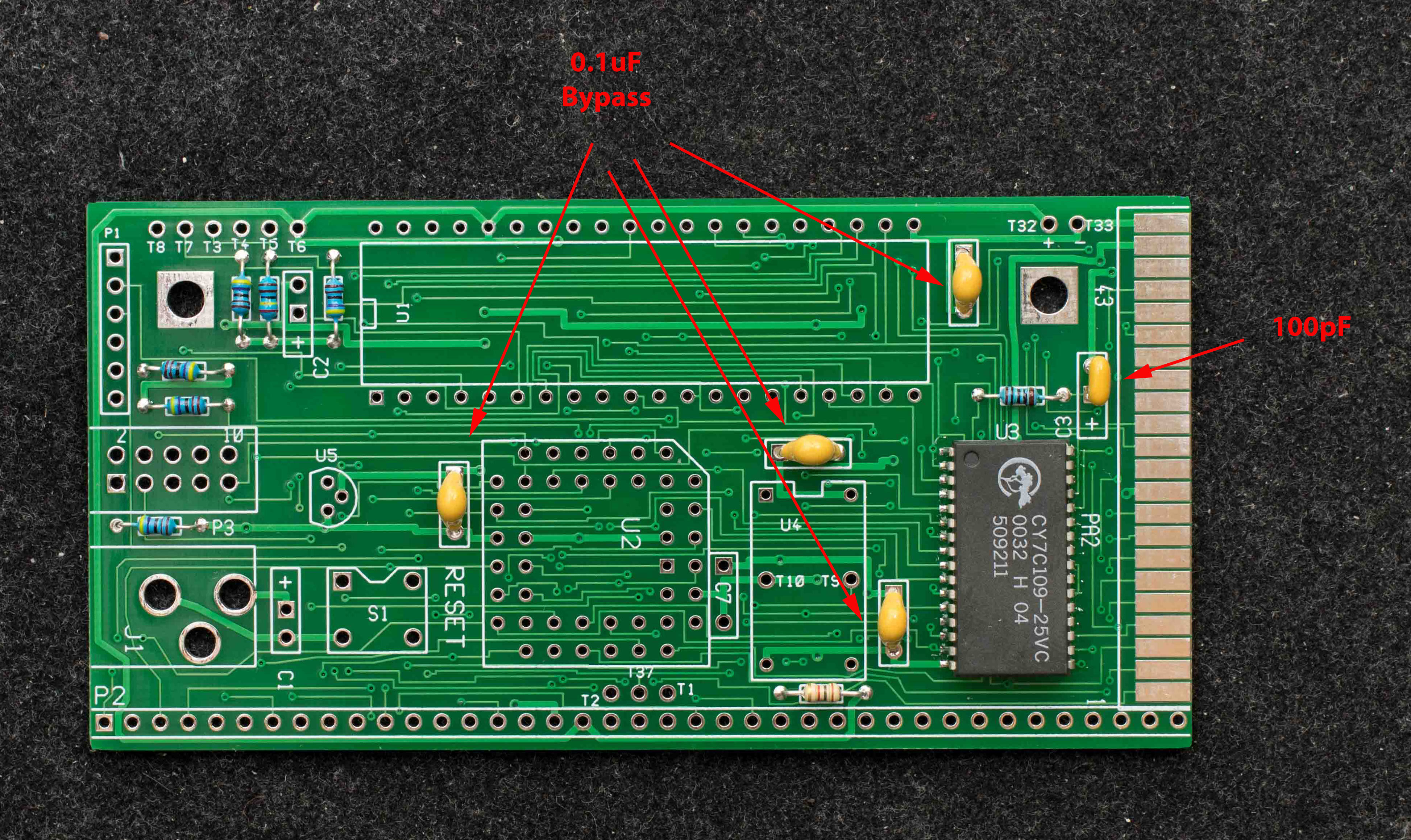

Assemble bypass caps and 100pF ceramic cap,
www.retrobrewcomputers.org_lib_plugins_ckgedit_fckeditor_userfiles_image_builderpages_plasmo_crc65_assembly_dsc_62930123.jpg

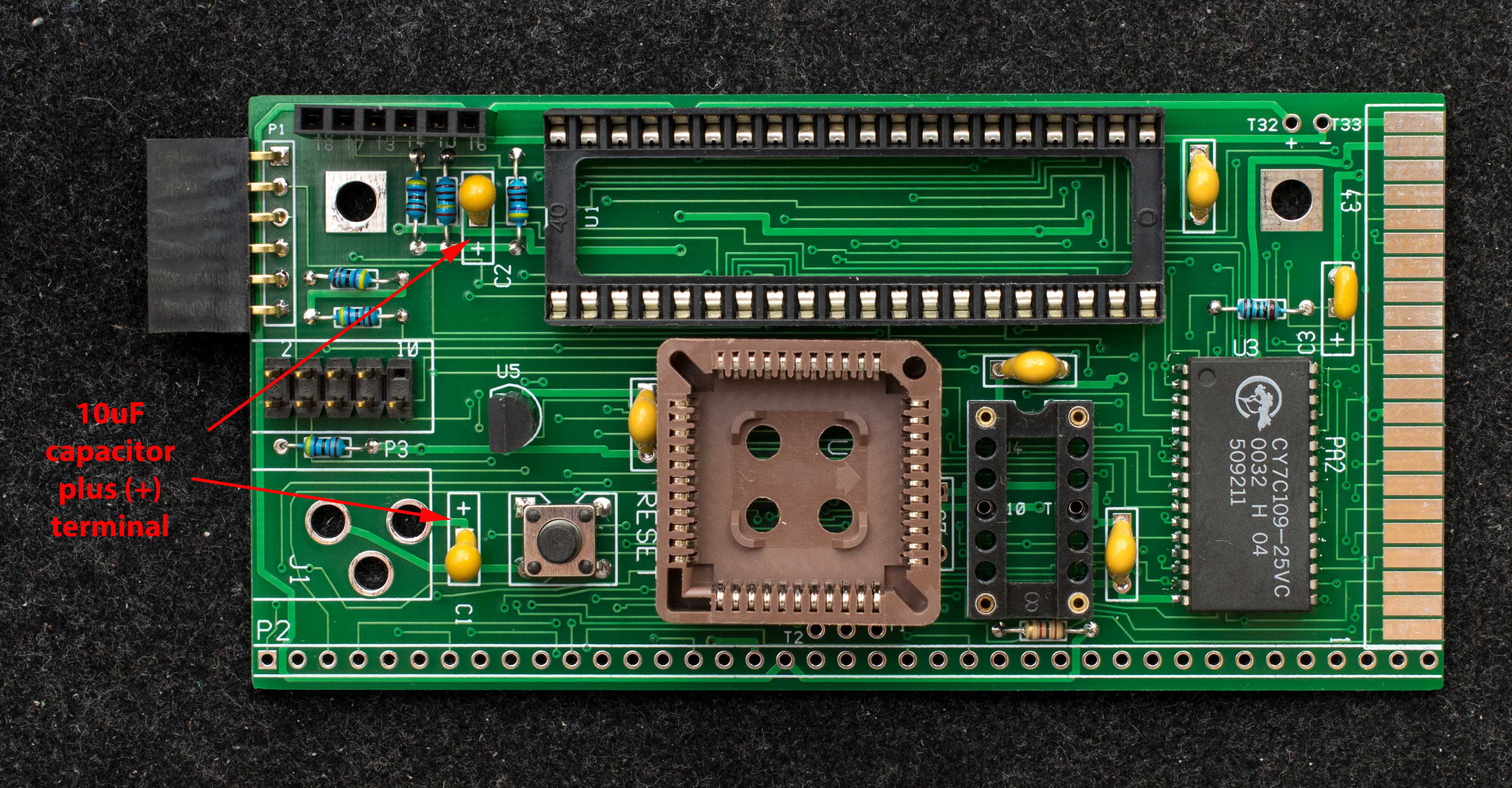

Assemble the 10uF tantalum capacitors. Observe the polarity of the capacitors,
www.retrobrewcomputers.org_lib_plugins_ckgedit_fckeditor_userfiles_image_builderpages_plasmo_crc65_assembly_dsc_62960123.jpg

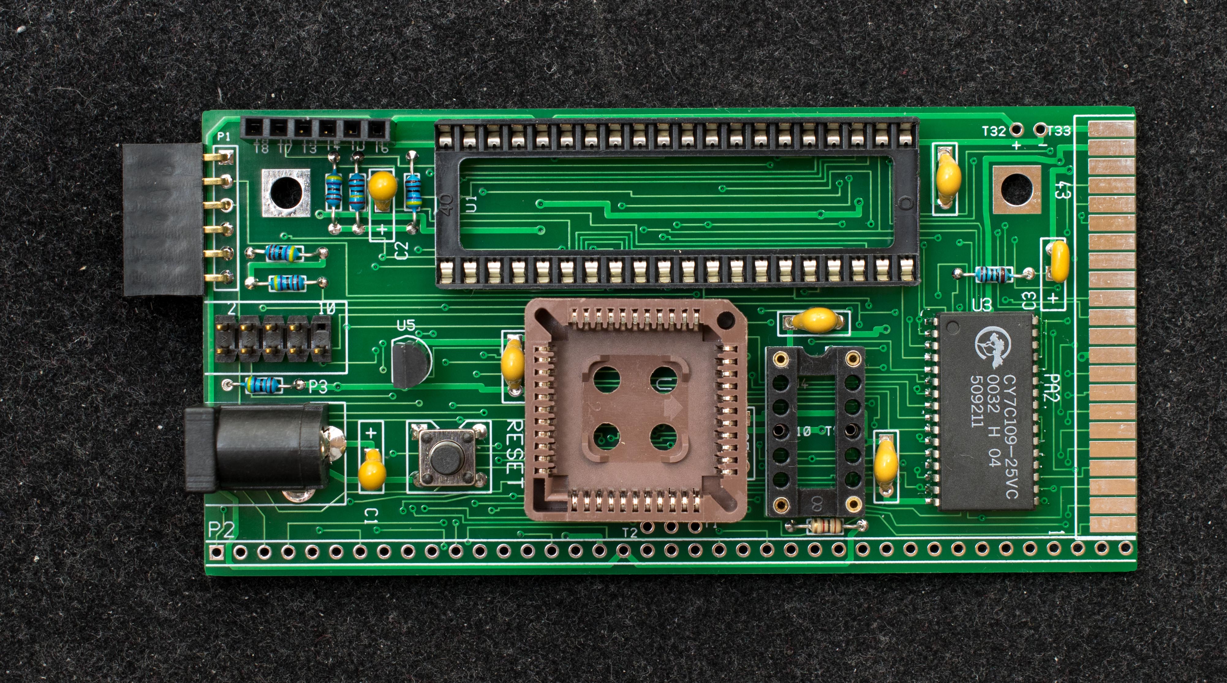

Finish up except the compact flash adapter.
www.retrobrewcomputers.org_lib_plugins_ckgedit_fckeditor_userfiles_image_builderpages_plasmo_crc65_assembly_0dsc_62970123.jpg
