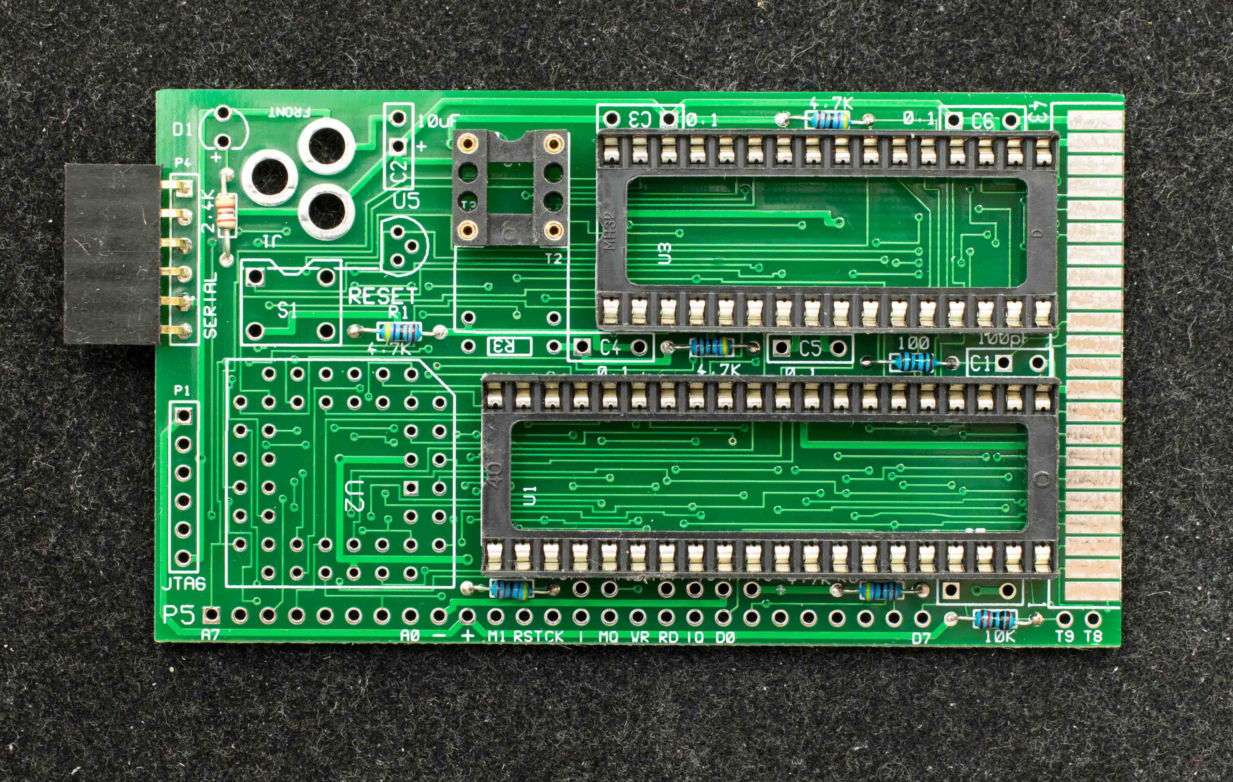

For ease of assembly, the lowest height components are installed first.

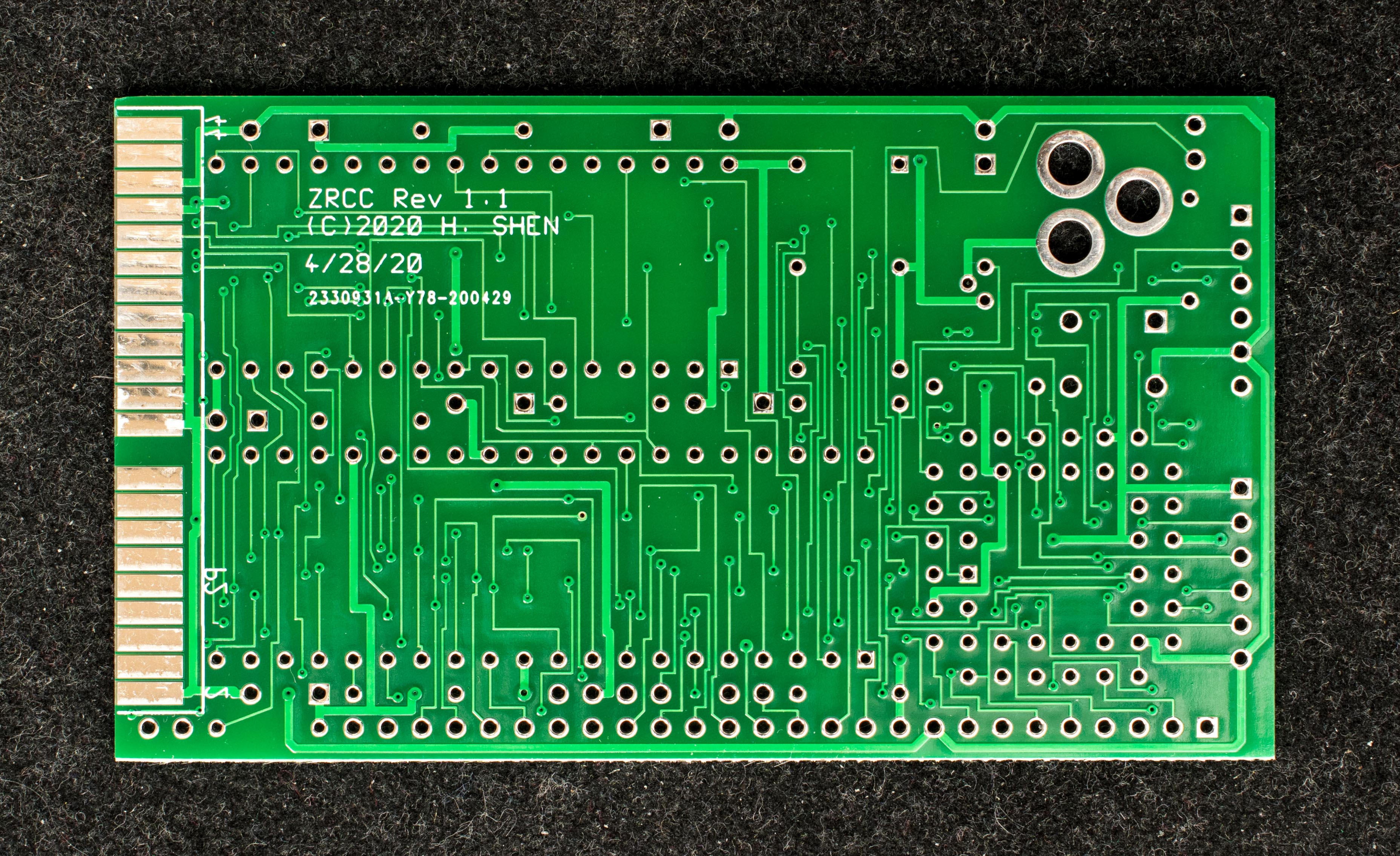

Bare PC board
Component side
Solder side
Install resistors first
Install IC sockets next
Install capacitors
Observe the polarity of 10uF Tantalum capacitor and LED
Install remaining hardware
Install PLCC socket last
