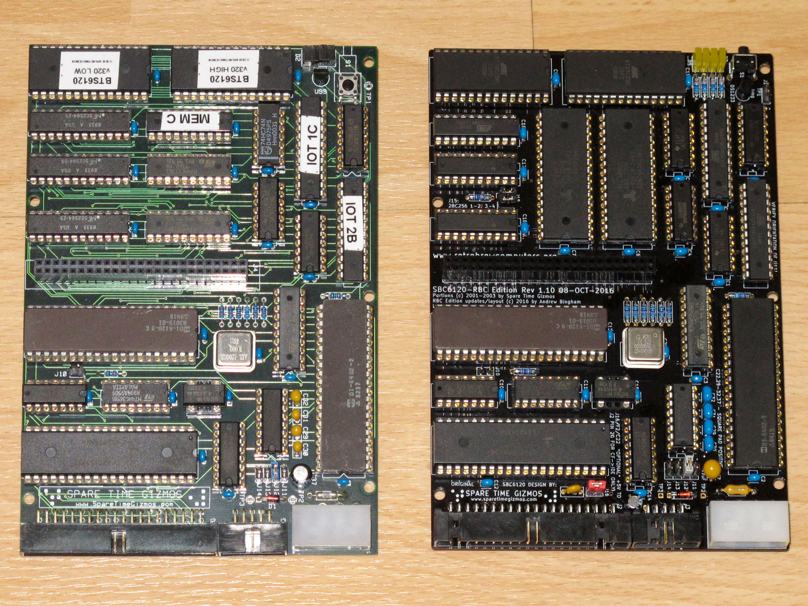

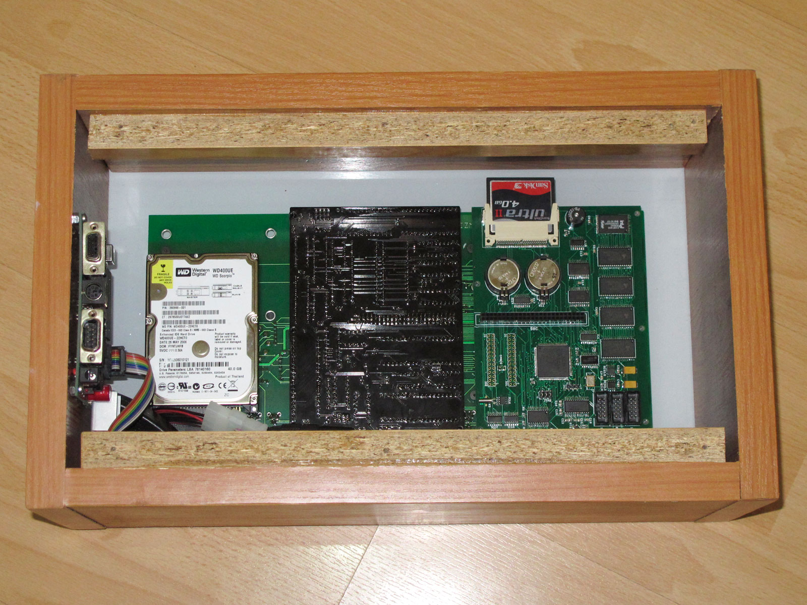

2 intrepid testers have completed construction of Rev 1.10 final PCBs, one of which was tested with an original STG FP6120 & and IOB6120 at the same time:

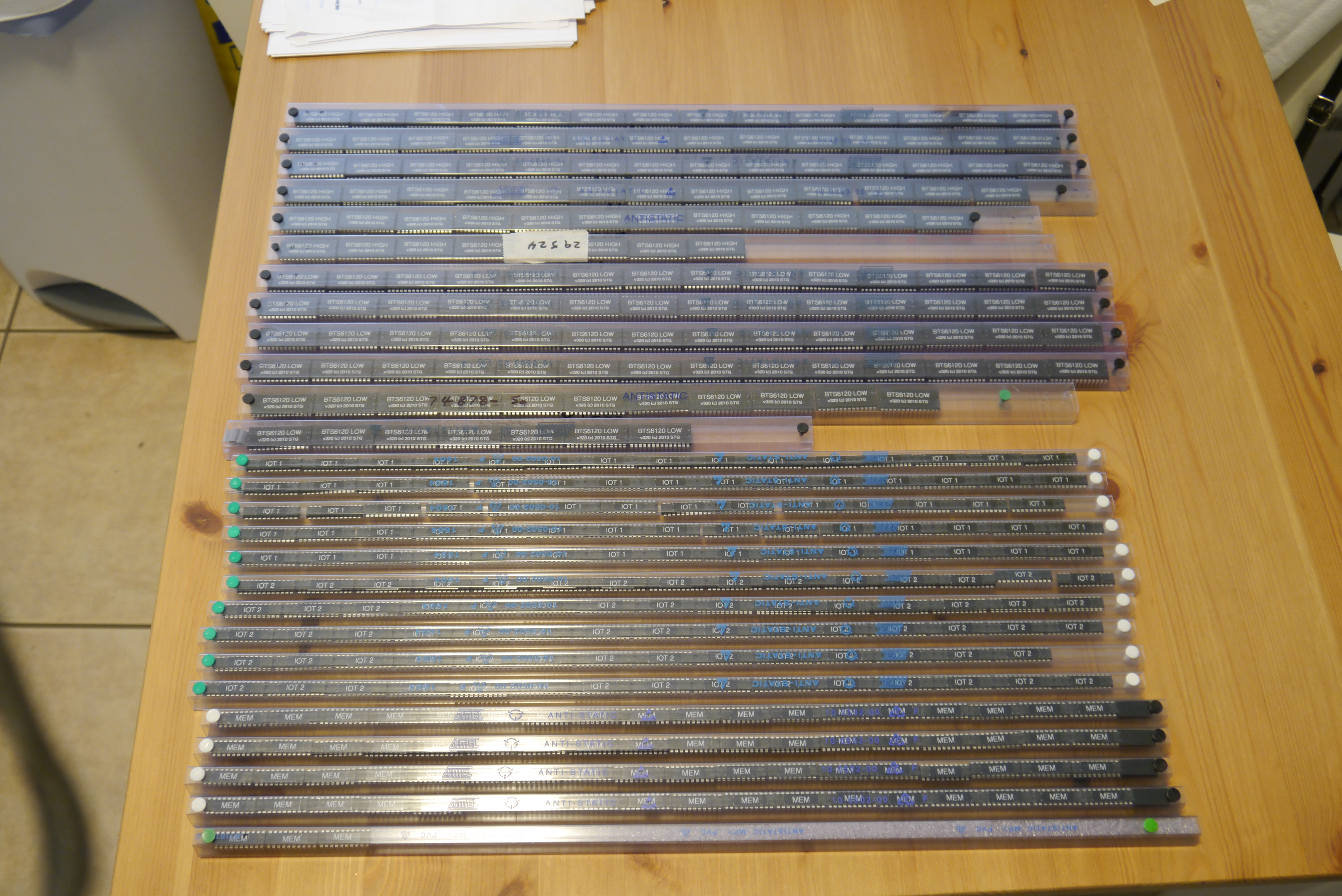

The following have been completed:
- All HD-6120s tested
- All EEPROMs programmed/verified & labeled
- All MEM, IOT 1, and IOT 2 GALS programmed/verified & labeled
- CDs for documentation ink stamp labeled
- Finalized strategy for packaging

- Test each set of ICs as a kit (also testing HD-6402s at the same time) & package

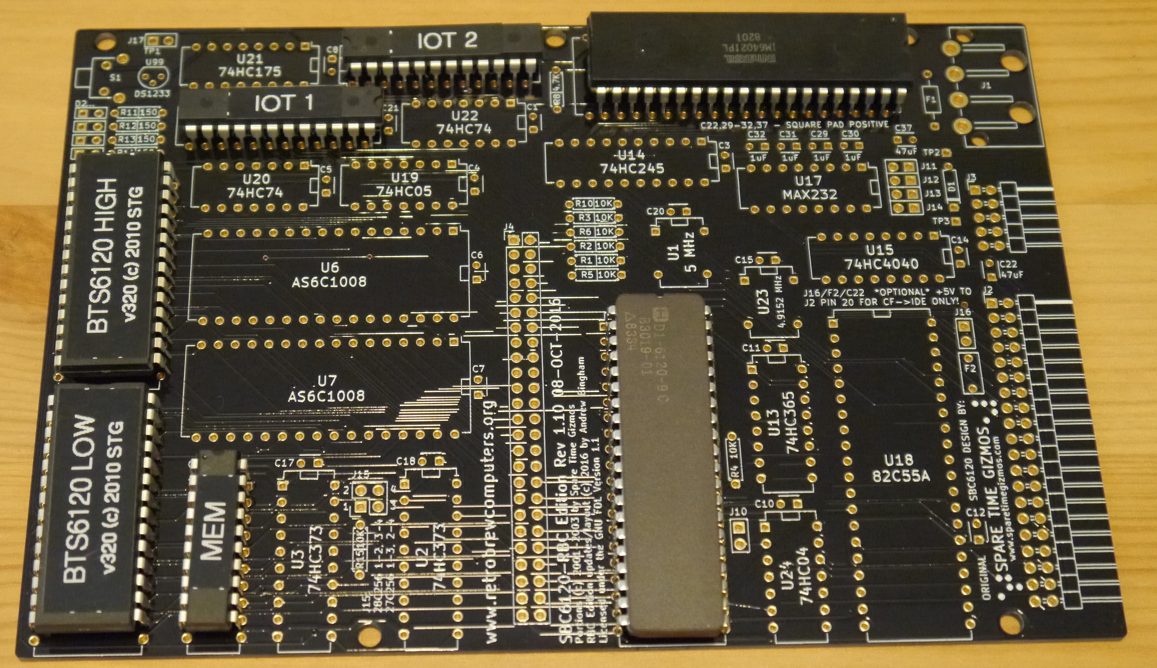

Rev 1.0 prototype board completed testing with an original Spare Tim Gizmos FP6120. The only copper layer change made to Rev 1.1 was the addition of 1 capacitor to add some decoupling when powering a CF→IDE adapter. This was done manually in KiCAD without changing anything else on the board. So Rev 1.1 boards are good to go!

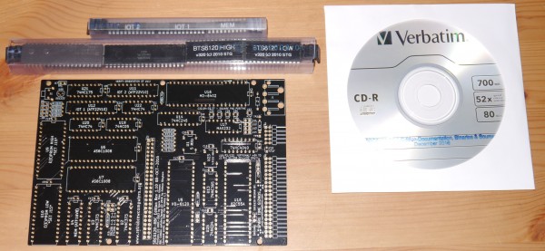

The following items are being offered:
- PCBs - $20 USD
- 'Hard to Find' IC Kit with HD1-6120 microprocessor, 6402 UART, 3 programmed GALs, and 2 programmed EEPROMs - $90 USD
Each order will also include (1) CD with license information, documentation, binaries, and sources. See below for representative photos of these items. Shipping cost is an additional charge, see notes below.

IC Kit Testing
I have individually tested every HD1-6120 to verify that:
- The BTS6120 ROM monitor boots
- OS/8 starts from a CF→IDE adapter
- The OS/8 version of Adventure starts and runs successfully (this is a relativly complex program that takes ~1 minute, 15 seconds to load from the CF card)
- Board-level current draw was in family with all other chips in the lot
All chips in the lot passed these tests (a handful received cosmetic damage to the ceramic packaging in shipping and those won't be used in satisfying the original group by list; I may offer them to people on the waiting list with prior agreement).
The GALs and EEPROMs were verified by the programmers during their programming process.
I have also tested every kit of chips as a set immediately before final packaging to verify that:
- Board-level current draw was in family with other kits
I have tested everything as described above, which has resulted in 2x tests for the HD1-6120, GALs, and EEPROMs (individually and with the final kit) and 1x test for the 6402's (with the final kit).
Because completion of a board depends on the soldering/electronics skills of the end user & chips could be damaged by handling or electrical issues, I cannot offer any warranty/guarantee on the IC kits other than that they have been tested as described above and are received without any shipping damage. ICs will be shipped in anti-static tubes packages in ESD safe bags, the same way I receive new ICs from Digi-key.

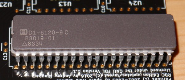

HD1-6120 Chip Condition
The HD-6120 ICs that I purchased from China were 'refurbished' by the vendor so they all have a consistent appearance. They have been remarked and the IC leads have been retinned. They have the correct CERDIP packages & I have no reason to think that these are anything other than original chips that were 'pulled' and cleaned up. See below for a picture of one of the chips: \\

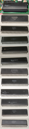

6402 Chip Condition
The 6402 ICs that I purchased are a 'mixed lot'. Some appear to have been remarked or refurbished with re-tinned leads. Others appear to have original markings. Some chips have cosmetic damage to the plastic encapsulation including minor to moderate scuffs, scrapes, etc. All chips have been tested as part of the final testing of their respective kits as described above. Click on the thumbnail below for pictures of some of the 6402's.
