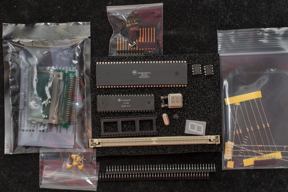

Kit #2 contains a partially assembled pc board where SMT resistors and capacitors are assembled and Altera EPM7128 is assembled and programmed. Included with Kit #2 are also bags of resistors, capacitors, hardware, and active components as shown in the photo below.
A high-resolution photo of the partial assembled board is below for reference

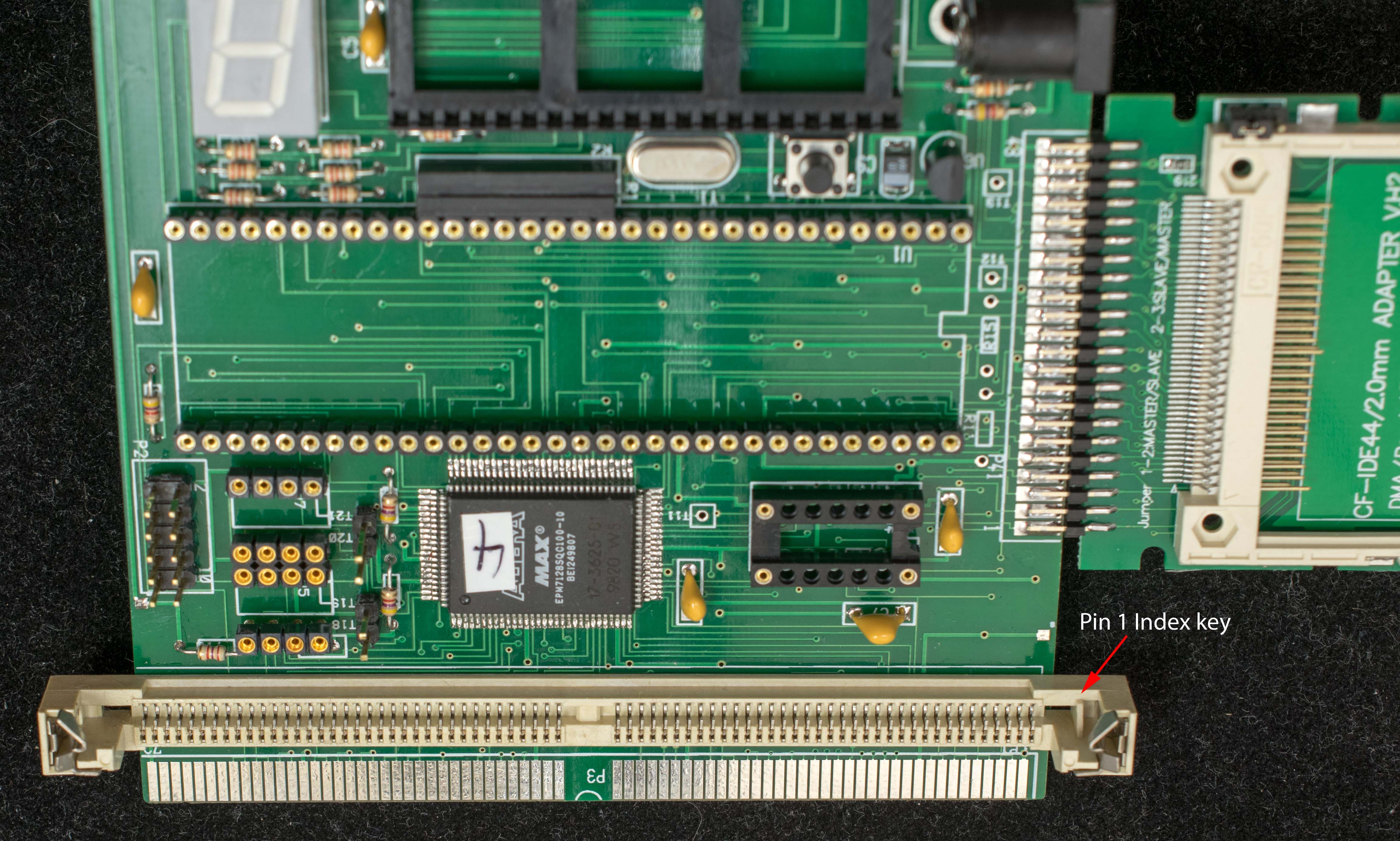

- Install SIMM72 socket, P1. Observe the polarity of the SIMM socket: The pin 1 index key of the socket must line up with pin 1 of silkscreen. Refer to the photo below for index key of the socket.

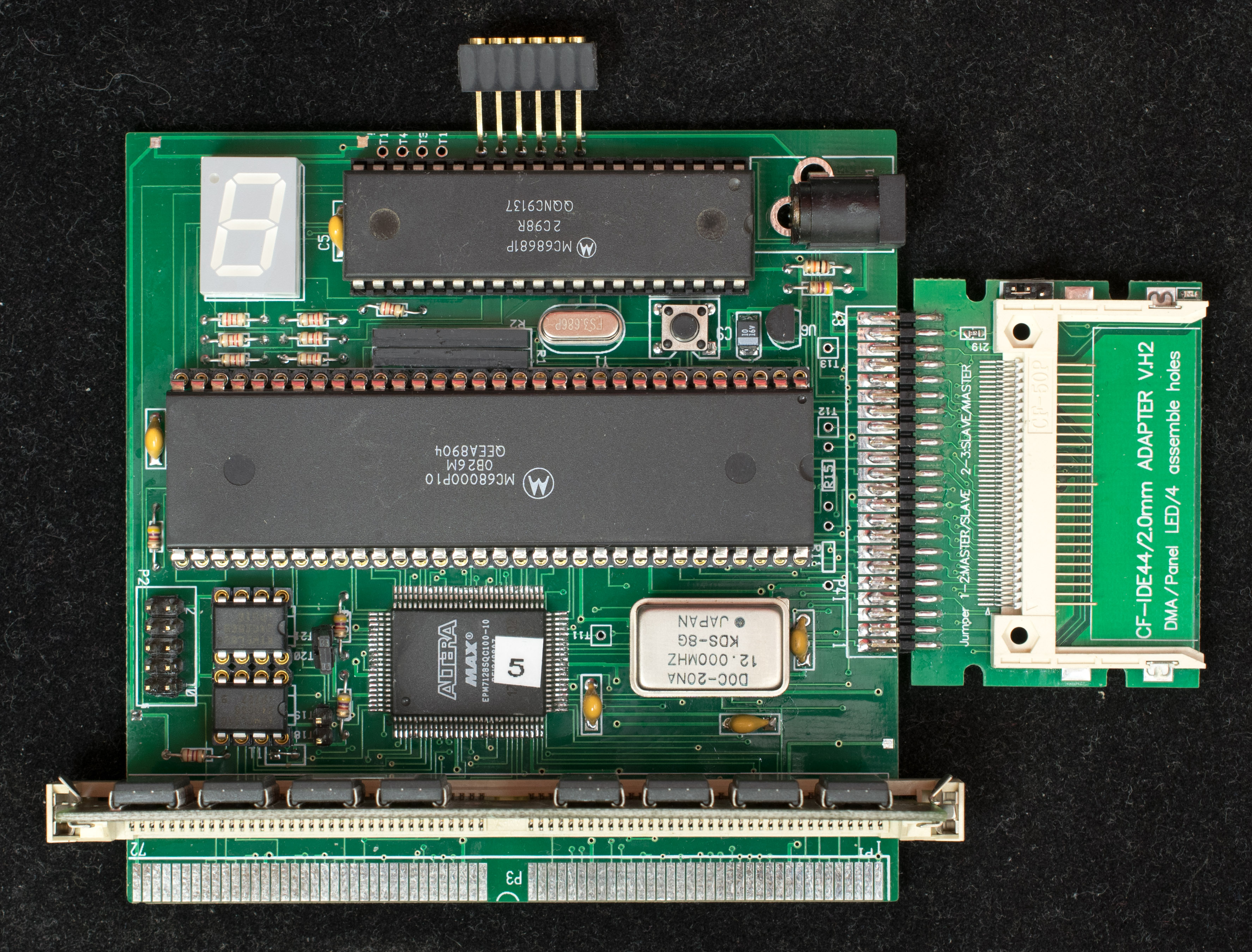

- Install 44-pin IDE-CF module, keep the module at the same level (another word, in the same plane) as the board before soldering. The assembly of Tiny68K is completed!
completed Tiny68K board with empty sockets
Photo shows the proper orientation of the SIMM socket

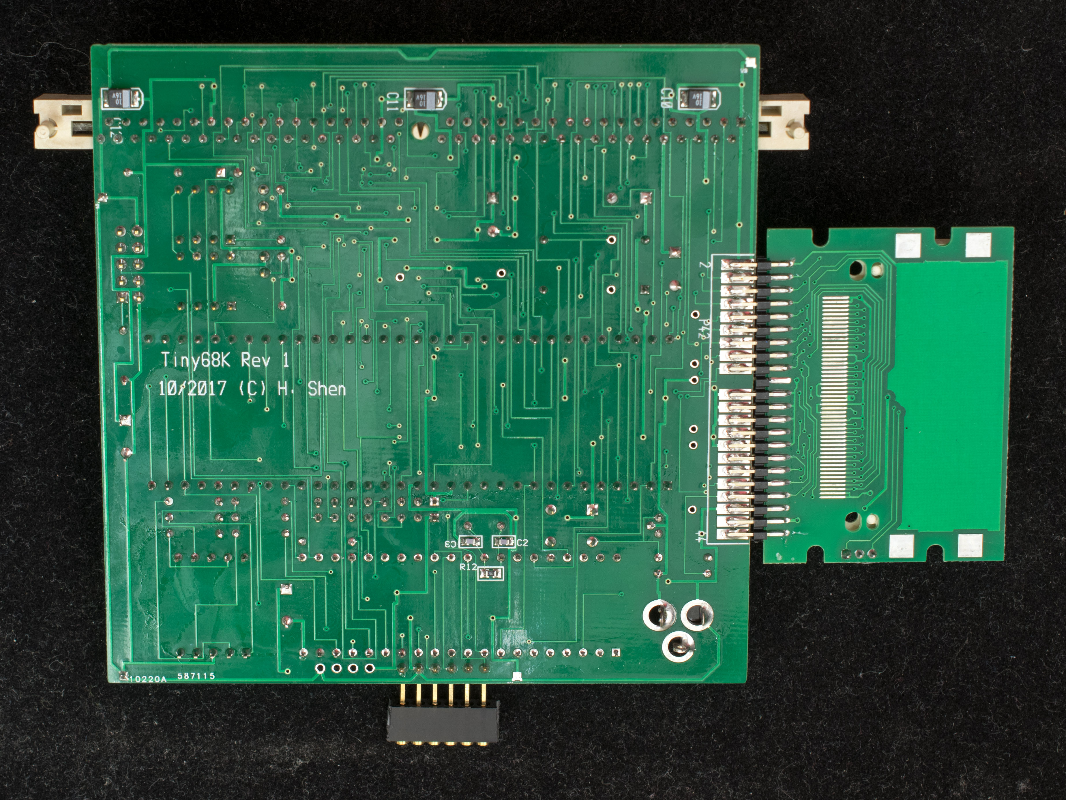

Completed board with components, solder side
