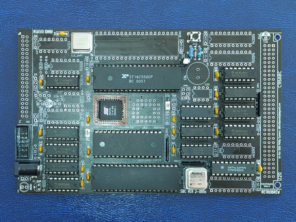

Pictures
Board
Kicad files can be found here but may not be the most recent.
Gerbers for SBC V2-005c, which have been built and tested. here.
Current revision is SBC V2-005i
Gerbers for SBC V2-005i, currently untested here.

Parts List
| Reference | # | Value | DIP8 | DIP14 | DIP16 | DIP20 | DIP32 | DIP40 | PLCC32 | |
| C1,C3-C23,C29,C30,C32,C33,C35 | 17 | 0.1uF | Ceramic Capacitor | |||||||
| C2 | 1 | 10uF | Electrolytic Capacitor | |||||||
| C24-C27 | 4 | 1uF | Electrolytic or Tantalum Capacitor | |||||||
| C28 | 1 | 10uF | Electrolytic Capacitor | |||||||
| C31 | 1 | 22uF | Electrolytic Capacitor | |||||||
| C34 | 1 | 0.22F+ | Super Capacitor | |||||||
| D1 | 1 | 5mm LED | Red/Green Bicolor | |||||||
| D2 | 1 | 1N4148 | Diode | |||||||
| K9-K12 | 4 | 1×3 | Pin Header 3 position 2.54mm | |||||||
| JP1 | 1 | 2×3 | Pin Header 2×3 position 2.54mm | |||||||
| JP2, LS1 | 4 | 1×2 | Pin Header 2 position 2.54mm | |||||||
| P1 | 1 | 2×20 | 40 pin IDC vertical socket. | |||||||
| P2 | 1 | 2.1mm | Barrel Jack Socket | |||||||
| P3 | 1 | 2×5 | 10 pin IDC vertical socket. | |||||||
| P4 | 1 | 4/8Mhz | CPU Clock 5V Active crystal oscillator square socket | 1 | ||||||
| P5 | 1 | 1.8432Mhz | UART Clock 5V Active crystal oscillator square | |||||||
| Q1 | 1 | 2N3906 | PNP Transistor | |||||||
| SW1, SW2 | 2 | 6x6mm | Mini Push Button Switch DIP 4pin | |||||||
| R1 | 1 | 10R | 0.25w resistor | |||||||
| R2,R11 | 2 | 10K | 0.25w resistor | |||||||
| R9 | 1 | 100R | 0.25w resistor | |||||||
| R12 | 1 | 4K7 | 0.25w resistor | |||||||
| R13 | 1 | 3K6 | 0.25w resistor | |||||||
| R14 | 1 | 1K8 | 0.25w resistor | |||||||
| R15 | 1 | 120R | 0.25w resistor | |||||||
| R16 | 1 | 470R | 0.25w resistor | |||||||
| R17 | 1 | 100K | 0.25w resistor | |||||||
| RR1, RR3 | 2 | 1K | SIP-6 Resistor array | |||||||
| RR2 | 1 | 4K7 | SIP-6 Resistor array | |||||||
| U1 | 1 | 16550 | UART DIP40 socket | 1 | ||||||
| U2 | 2 | 39SF040 | Flash 512kb PLCC32 socket | 2 | ||||||
| U3 | 1 | 74LS08 | Quad 2-in AND Gate DIP14 socket | 1 | ||||||
| U4 | 1 | 74LS10 | Triple 3-Input NAND Gate DIP14 socket | 1 | ||||||
| U5 | 1 | 74LS125 | Tri State Quad Bus Buffer DIP14 socket | 1 | ||||||
| U6 | 1 | 74LS139 | Dual 1-of-4 Decoder/De-multiplexer DIP16 socket | 1 | ||||||
| U7,U27 | 2 | 74LS14 | Hex Inverter/Schmitt Trigger DIP14 socket | 2 | ||||||
| U10 | 1 | 74LS243 | Quad Bus Transceiver DIP14 socket | 1 | ||||||
| U8,U9,U11 | 3 | 74LS245 | Octal tri-state bus transceiver DIP20 socket | 3 | ||||||
| U12,U13,U18 | 3 | 74LS174 | Hex D-type flip flop with clear DIP16 socket | 3 | ||||||
| U14-U16 | 3 | 74LS32 | Quad 2-input OR gate DIP14 socket | 3 | ||||||
| U17 | 1 | 74LS244 | Octal Driver Tri-State DIP20 socket | 1 | ||||||
| U19 | 1 | 8255 | Programmable Peripheral Interface DIP40 socket | 1 | ||||||
| U20 | 1 | C96ABC | DIN 41612 Connector, 96 pin plug, right angle. | |||||||
| U21 | 1 | DS1302 | Maxim Trickle-Charge Timekeeping Chip DIP8 socket | 1 | ||||||
| U22 | 1 | MAX232 | Maxim Multichannel RS-232 Drivers/Receiver DIP16 socket | 1 | ||||||
| U23 | 1 | AS6C4008 | 512Kb x 8 RAM DIP32 socket | 1 | ||||||
| U24 | 1 | Z84C00 | Z80 CPU DIP40 socket | 1 | ||||||
| U25 | 1 | DS1210 | Maxim Nonvolatile Controller Chip DIP8 socket | 1 | ||||||
| U26 | 1 | 74LS06 | Hex inverter buffers/drivers DIP14 socket | 1 | ||||||
| U28 | 1 | 74LS74 | Dual D-Type Positive Edge Triggered Flip Flop DIP 14 socket | 1 | ||||||
| X1 | 1 | 32.768KHz | 3mm Crystal 6pF | |||||||
| Sockets | 3 | 11 | 5 | 4 | 2 | 3 | 2 |
Minimum Build
Excludes Sound, RTC, IDE interface, Battery Backup controller and super capacitor, RS232 TTL converter, ECB bus interface, 2nd Flash ROM
| Reference | Component |
| C2 | 10uF |
| C3, C4, C9, C11-C17, C19-C23, C30, C32 | 0.1uF |
| D2 | 1N4148 |
| JP3-JP4 | SOLDER BRIDGE |
| JP4-JP8 | SOLDER BRIDGE |
| P2 | BARREL JACK |
| P3 | IDC SOCKET |
| P4 | 4-10MHz XTAL + SOCKET |
| P5 | 1.8432 XTAL |
| U1 | 16550 |
| U3 | 74LS08 |
| U4 | 74LS10 |
| U6 | 74LS139 |
| U7 | 74LS14 |
| U12, U13, U18 | 74LS174 |
| U14, U15, U16 | 74LS32 |
| U17 | 74LS244 |
| U23 | AS6C4008 |
| U24 | Z80CPU |
| U26 | 74LS06N |
| U28 | 74LS74 |
| U29 | 39SF040 |
| K10 | Pin Header, 1-2 BRIDGED |
| K11 | Pin Header, 1-2 BRIDGED |
| R1 | 10R |
| R2 | 10K |
| RR1, RR2 | 10K |
| RR3 | 4K7 |
| SW1 | Push Button |
SBC Build
Excludes ECB interface
| C6, C18, C33, C35 | 0.1uF |
| C24-C27 | 1uF |
| C28 | 10uF |
| C34 | 0.22F-0.47F Super capacitor |
| D1 | BICOLOUR LED |
| JP1 | PIN HEADER |
| JP2 | PIN HEADER |
| JP3-JP4 | REMOVE SOLDER BRIDGE |
| JP5-JP8 | REMOVE SOLDER BRIDGE |
| JP9 | PIN HEADER |
| K9 | PIN HEADER (not requires version f+) |
| K12 | PIN HEADER, 2-3 BRIDGED |
| LS1 | PIN HEADER |
| P1 | IDC SOCKET |
| Q1 | 2N3906 |
| R9 | 100R |
| R11 | 10K |
| R12 | 4K7 |
| R13 | 3K6 |
| R14 | 1K8 |
| R15 | 120R |
| R16 | 470R |
| R17 | 100K |
| U2 | 39SF040 |
| U5 | 74LS125 |
| U19 | 8255 |
| U21 | DS1302 |
| U22 | MAX232 |
| U24 | DS1210 |
| U27 | 74LS14 |
| SW2 | Push Button (Revision f+) |
Full Build
| C1, C5, C7, C10, | 0.1uF |
| C31 | 22uF |
| U8, U9, U11 | 74LS245 |
| U10 | 74LS243 |
| U20 | DIN EURO MALE RA 96 |
