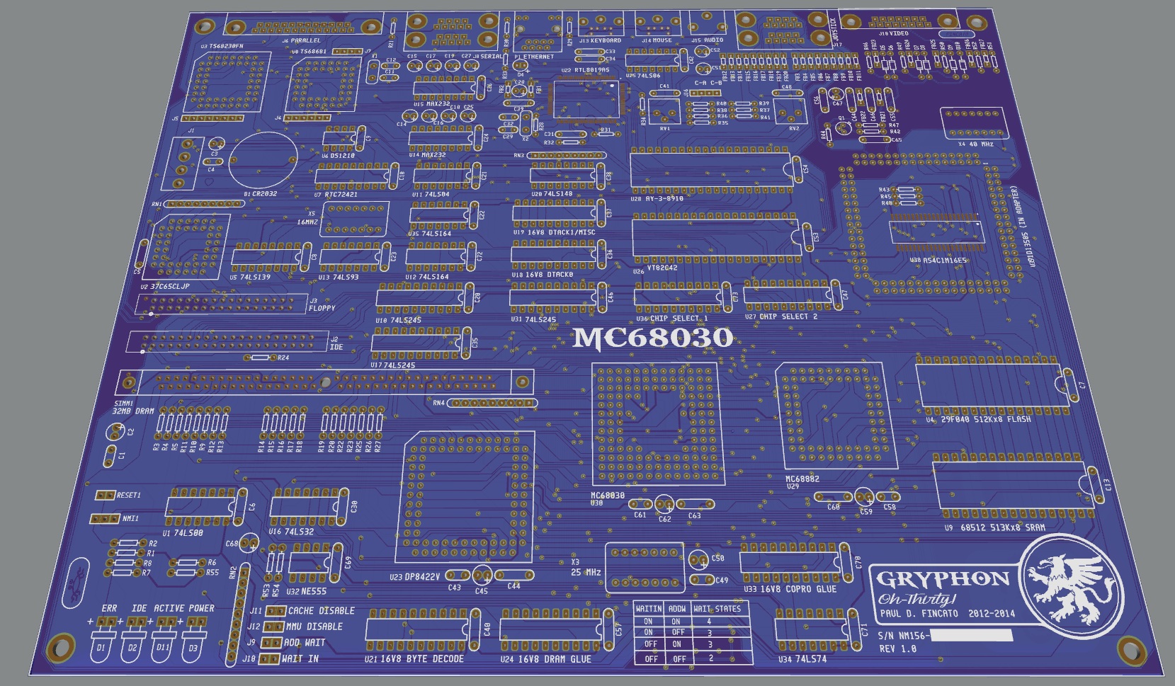

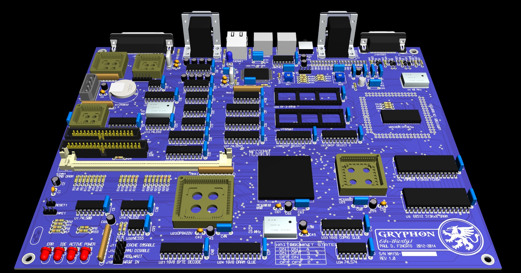

The goal of the Gryphon project is to create a 32 bit single board computer that would have been state of the art - in the late '80's or early '90's. Design goals were to use through hole components and to use “period correct” function specific chips as much as possible, and programmable logic limited to 16V8GALs. Deviations from this were primarily on memory density, ethernet and video to keep the board size down.
The 68030 was chosen as the CPU for various reasons:
- The 68K/CPU32 instruction set is generally acknowledged as one of the better ISAs
- A lot of folks have a fondness for the 68K - the heart of Amigas, Ataris, Macs and others, and a time when we cut our teeth learning computers
- The '030 is the last of the Motorola line that is relatively easy to work with
- Clock speed of 25MHz is probably the limit of 2 sided PCB designs before entering RF voodoo land
Other design decisions:
- Why is the video on a daughterboard? The S1D13505 chip has 0.5mm spacing. Cost for the whole board goes up to accomodate the one chip. A decision was made to use an adapter board to help control costs.
- Why the S1D13505? The Epson chip has the most thorough documentation of anything I could find and it met the design goal of at least 800×600 color video
- Why a floppy disk interface? A true anachronism. I just thought it would be neat to understand how FDDs work. No other reason.
- Why are you doing this when you could (emulate, buy eval board, hack other 68k systems, etc)? You already know the answer or you wouldn't be on this page. It's a hobby and a learning experience.
- Why is there an image of you on the back of the board? Are you an egomaniac? This started out as a personal project. It was only after I had the gerbers ready to send to production that I decided to share the project. This is my contribution to the free hardware/software community for so much that I have benefited from over the years. Rev1.1 will not have my image.

Specifications
- MC68030 @ 25MHz
- MC68882 @ 25MHz
- 32M DRAM via 8422V Controller
- 512K SRAM (to help get it initially running)
- 512K FLASH
- Parallel Port
- 2 Serial Ports
- 8242 Keyboard/Mouse Controller
- AY-3-8910 Sound
- 37C65 FDC
- IDE interface
- RTC 72421 Clock
- RTL8019AS Ethernet
- S1D13505 Video (800×600) - (In a TQFP-128 to PGA-128 SMT Adapter)
Bold items have been verified operational or basic testing performed as of latest update. Datasheets for all of the components & example code/development utilities for the Epson S1D13505 are found here.
