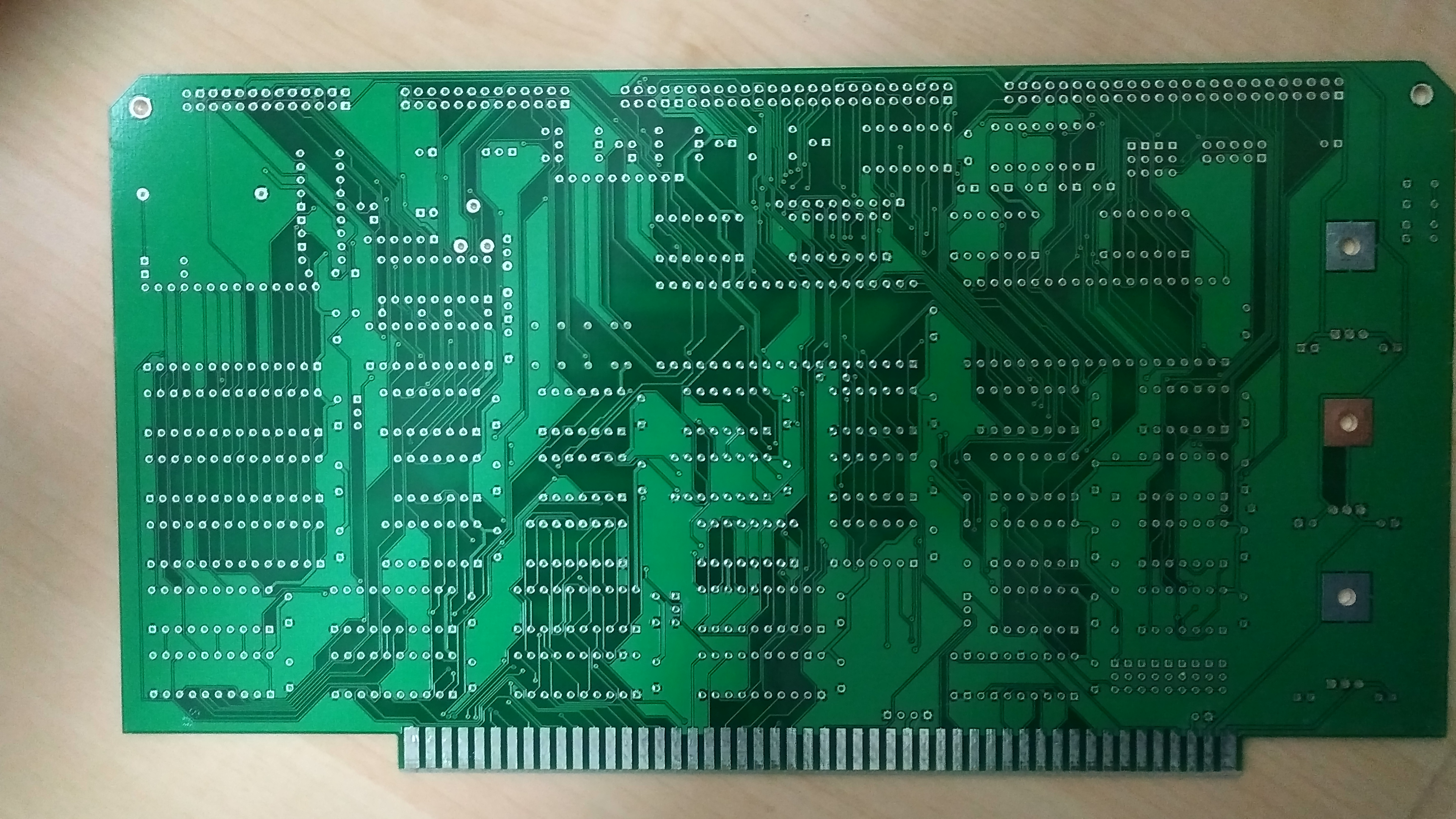

S100 Utility 02 - MSX2 peripheral board.
This is a board to add some MSX peripherals to a S-100 system:
-Cartridge port slot.
-System expansion port (MSX bus system)
-MSX2 system clock
-SRAM and ROM
-MSX keyboard port
-Data cassette tape recorder port
-Centronics (14 pin) parallel printer port
-Serial port
The system needs a S100 VDP board to provide MSX graphics, sounds and game ports, and a Z80 cpu board with the ability to disable its ROM.
Prototype version 02 is re-designed to include the Neil Bredeen's revisions.
