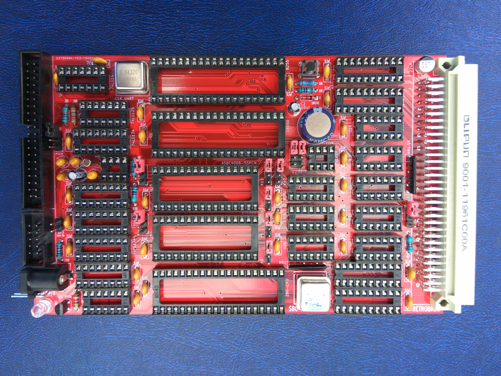

SBC-V2-004 This has been my biggest project so far. I took the SBC-V2 and added on board PPIDE circuit, added a simple sound circuit, on board super capacitor and standardized the serial connector with the Mark IV board. This was the the first real routing I have done and my original intention was just to correct the original reset flaw in the SBC-V2-003 and it grew from there. Contributed schematic for the AS6C4008 schematic to Kicad library.
This is the next iteration with clock divider circuit for switchable speeds. Intended for MSX compatability but not sure how useful it will be.
