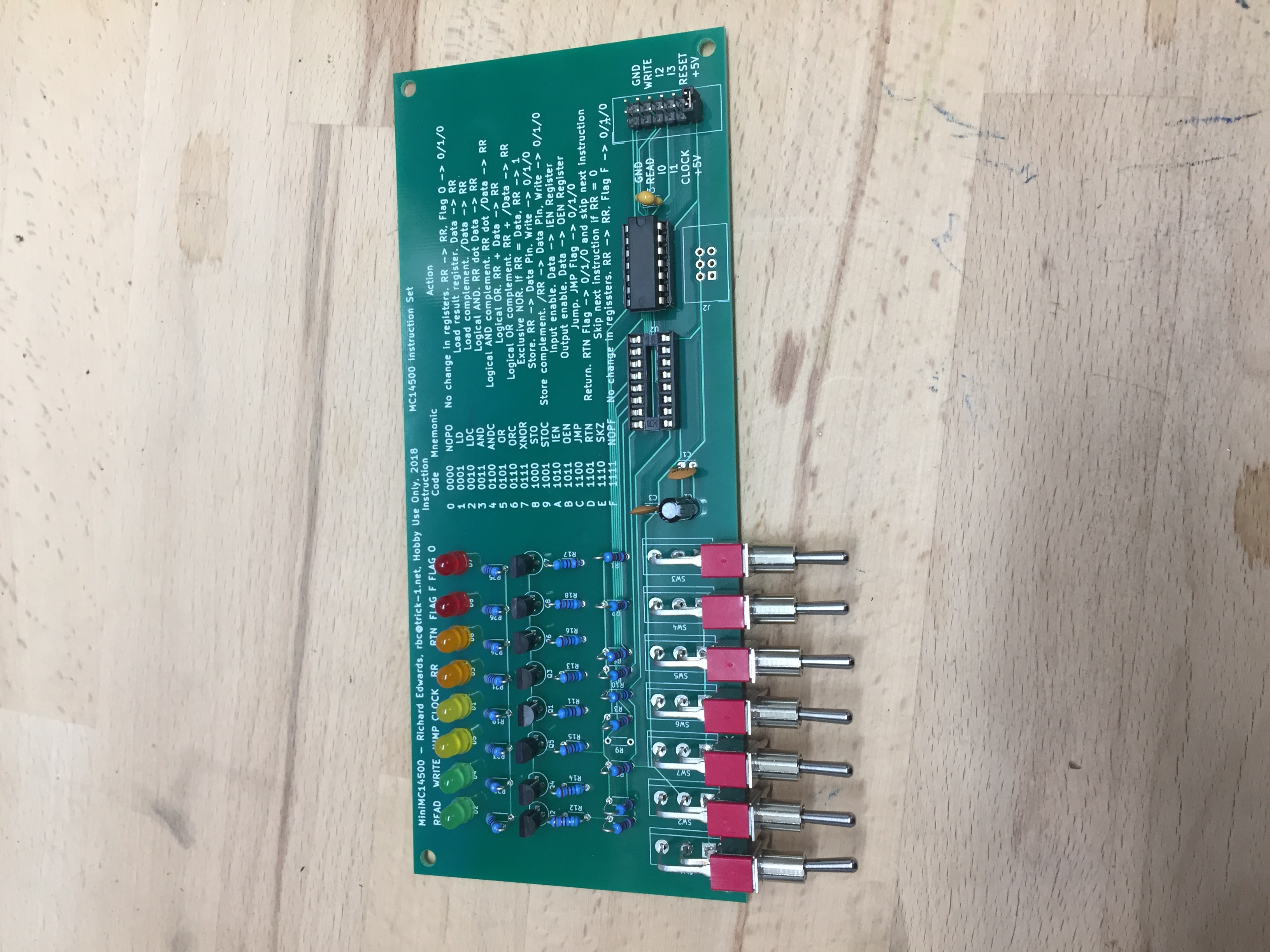

The Mini MC14500 SBC is a very simple board built around the Motorola MC14500B ICU (Industrial Control Unit) https://en.wikipedia.org/wiki/Motorola_MC14500B. The impetus for this board was an article on the VASTOR processor that was built at the University of Toronto. The following article explains that processor http://www.dissonance.com/archive/journals/Loucks82.pdf. This board is not a VASTOR processor but a single ICU proof of concept based on reference design from Motorola.

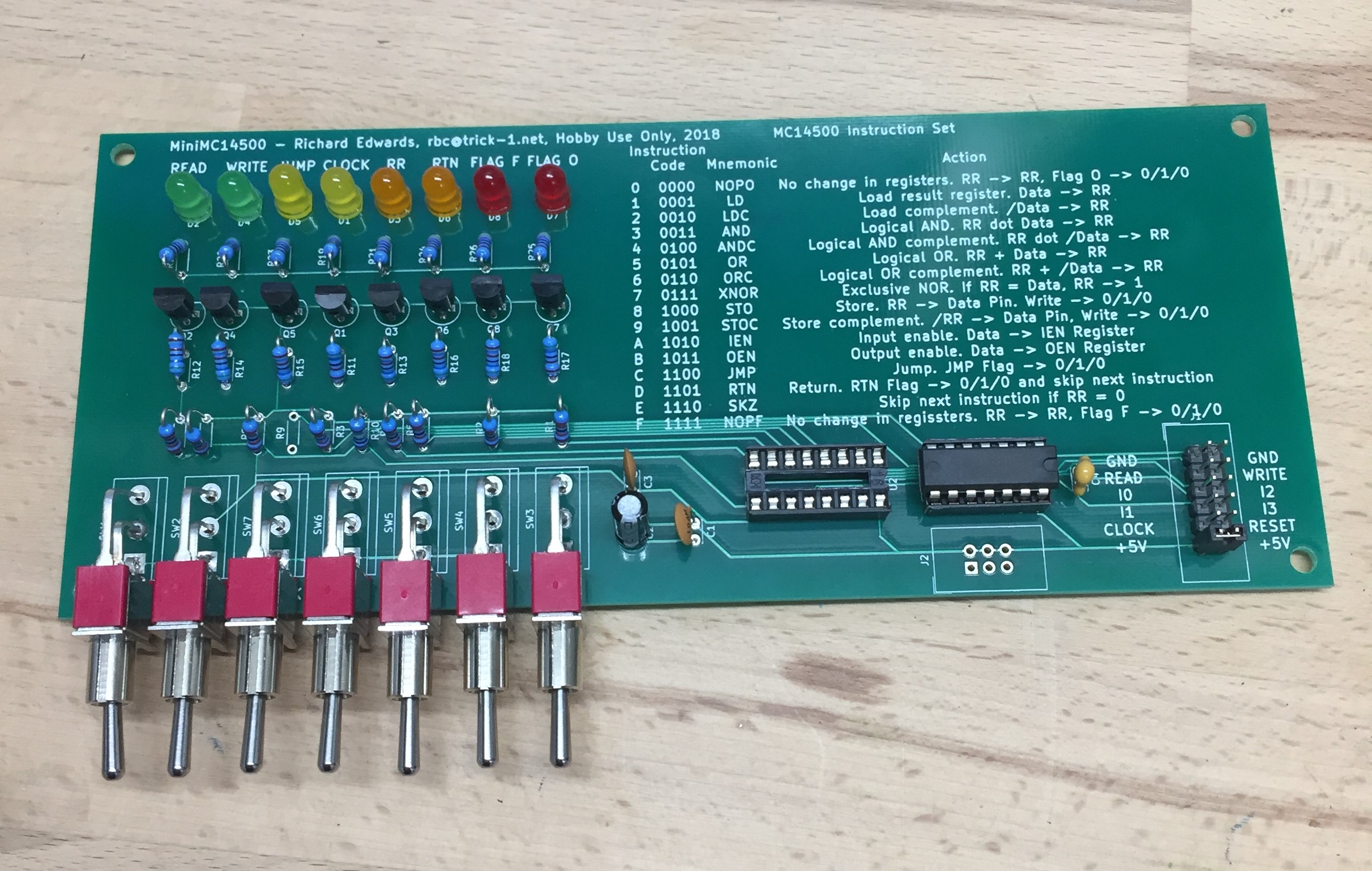

All Data, Instruction and Clock entry is done via switches.
The Mini MC14500 board has the following features
- 8 LED's for state output
- 6 Switches for programming and data input
- Expansion header to allow direct connection to say a parallel port for control by another CPU.
- The silk screen for the board has all of the OP codes for quick reference
Board: mini mc14500 Board Layout

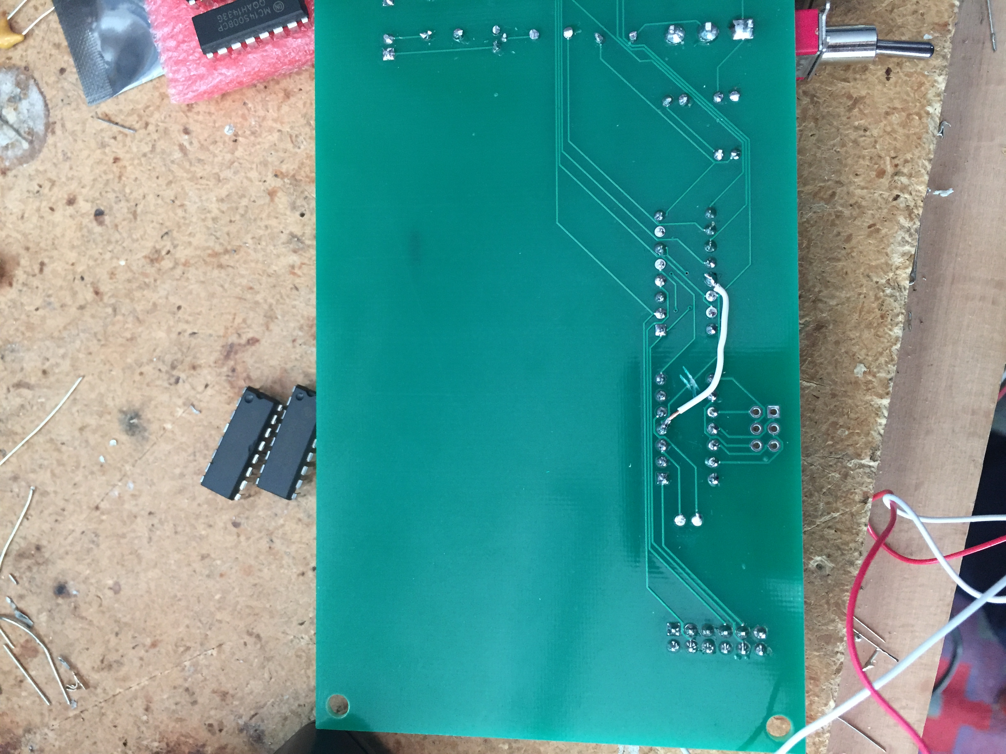

Note the currently manufactured board has a single erata that requires the cutting of one track and soldering of one wire between 2 points. The build files have not been updated.
The build is very simple. Install
- Resistors and capacitors
- Transistors and IC sockets
- LED's
- Switches
- Undertake the required modification as per the erata photo
