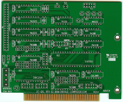

XT-IDE REV 02
Note: Optional UART hardware not fitted in top photo.
The XT-IDE board allows a modern IDE hard drive or CF card to be used as a storage medium on vintage IBM PC XT and compatible computers. It also includes provision for an additional serial port, which can be used to serve files off a modern host computer.
Features include:
- Works “as you'd expect” as a functioning IDE controller for 8-bit ISA slots. Just attach up to 2 PATA hard drives to a cable and start using it.
- No drivers to load. All HDD support is added through the onboard boot ROM (technically, a 'BIOS expansion ROM').
- Onboard boot ROM (EEPROM type of ROM) can be flash upgraded. No ROM programmer required.
- Supports drives of any size. There are restrictions in the operating system though (DOS 6.22 limits drive size to 8.4Gb)
- The UART (optional) allows the card to boot over a serial link from a high speed modern computer, reading and writing to an .IMG file that represents a bootable hard disk image.
- Supports most Compact Flash devices attached to CF→IDE converters.
- Supports most DOM devices. (see test results page below)
- Adds a boot menu (optional) to your machine- Boot to any drive attached to your computer, including the B: drive!
- Onboard power connector for powering either CF devices (5 volts) or standard HDDs (12 volts) for machines without spare wiring from the power supply (such as the IBM model 25).

Some notes for building the card:
- SIP resistors are mounted with the printing facing down, toward the ISA connector.
- The 14 decoupling caps are not polarity sensitive.
- The 5 caps around the 232 driver IC are polarized. Note the + mark on the PCB must match the + on the cap.
- The single large cap is also polarized.
- The LED is polarized. It has one side flattened to indicate polarity. Match the flattened side of the LED with the PCB silkscreen.
- Pin 1 for the IDE connector is down, closest to the ISA connector.
- Pin 1 for the 9 pin serial header is on the left side (look for the square hole on the back of the PCB).
- The card can self-program the EEPROM, so don't worry about needing an EEPROM burner to get a complete card. In fact the card can actually function AS an EEPROM programmer; the XTIDECFG flash program available with the BIOS allows for ROMs between 8 and 64k to be written.

P9 Jumper
P9 near the IDE connector is a power enable/disable jumper to pin 20 (Vcc) If you are using a DOM or other low power device that can accept 5 volts on pin 20 to power the device itself, put a jumper on P9. Then you won't need an external power cable.
Resistor R6
A design error in the XT-IDE revision 1 card, which carried through to the revision 2 card, concerns the 'cable select' functionality (CS) of the IDE specification. Discussion of this design error in the XT-IDE appears in the XT-IDE thread starting here.
For a lot of XT-IDE users, that won't be a problem, because the IDE device in use will probably be set to 'master', not CS.
If the IDE device that you attach to the XT-IDE does not have master/slave/CS jumpers, then it is possibly using CS. Note that a lot of IDE-to-CF adapters have master/slave jumpers.
Should you wish to correct the design error, replace R6 with a wire link (photo), or bridge the ends of R6 using a piece of wire.
