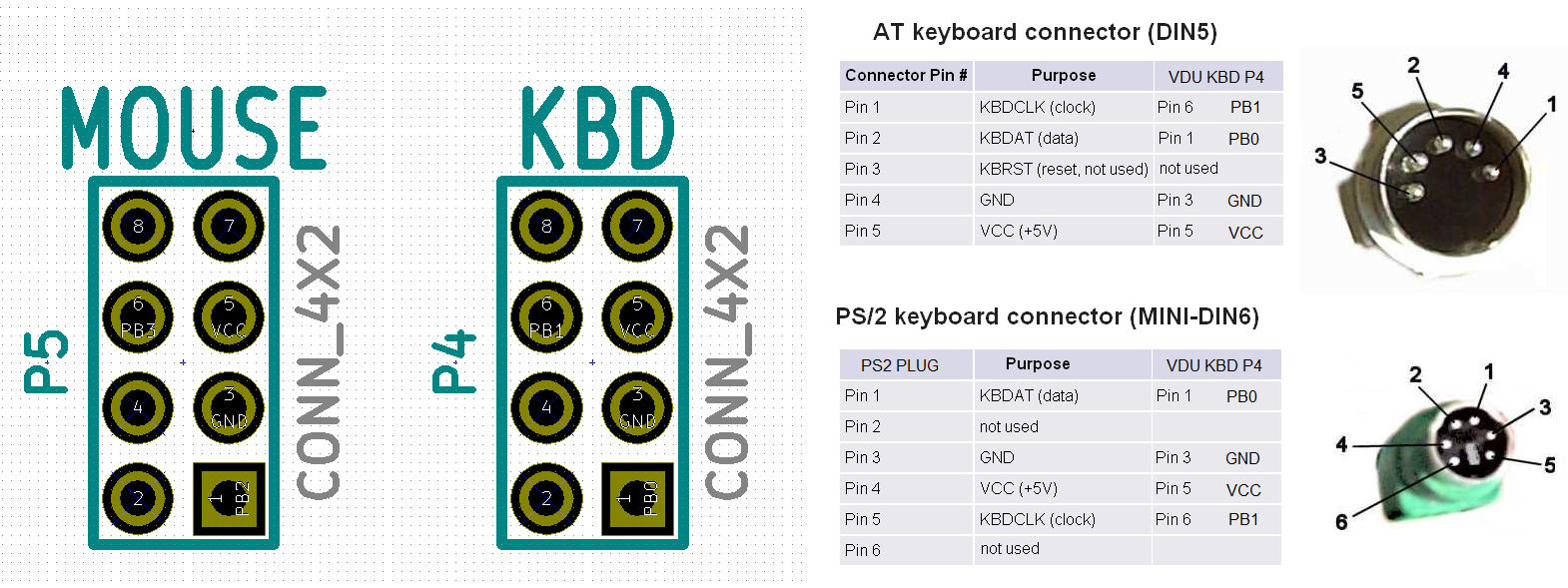

Keyboard wiring
Version 1
Version 1a / 2
| PS/2 Plug (MINI-DIN6) | Purpose | VDU KBD P4 |
| Pin 1 | PB0 - KBDAT | Pin 3 |
| Pin 2 | Not Used | - |
| Pin 3 | GND | Pin 5 |
| Pin 4 | VCC (+5v) | Pin 7 |
| Pin 5 | PB1 - KBCLK | Pin 8 |
| Pin 6 | Not Used | - |
