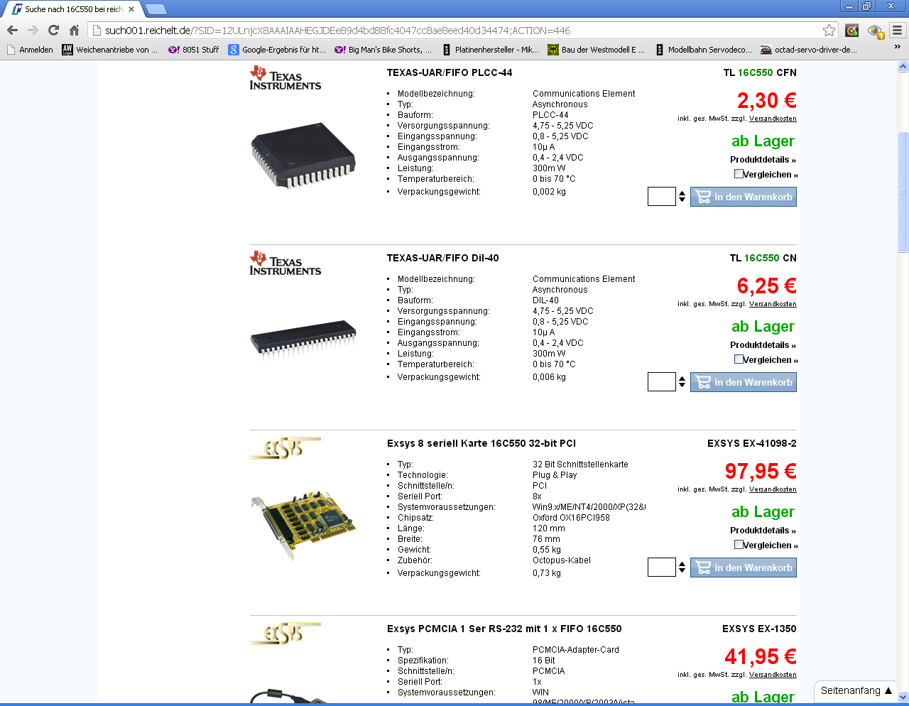

Am 02.02.2013 12:28, schrieb Martin Boháč:
Hi !
I am from Slovakia in Europe and i cannot obtain 16550(TL16C550CN) and AY-3-8910 are there some similar parts what can i use ?
Thanks for answer
Martin

Hi Martin,
You may by them via EBay:
http://www.ebay.de/sch/i.html?_trksid=p5197.m570.l1313&_nkw=AY-3-8910&_sacat=0&_from=R40
http://www.ebay.de/itm/IC-BAUSTEIN-16C550-TL16C550AN-u-a-19218-152-/130757564508?pt=DE_Elektronik_Computer_CPUs&hash=item1e71c2185c#ht_1674wt_1186
The 16C550 You by at REICHELT a German Distributor
Regards
Wolfgang
PS: For the AY-3-8910 is no substitution. For the 15C550 You may use 16C450. But this chip is only usable with reduced speed because the is no FIFo inside
