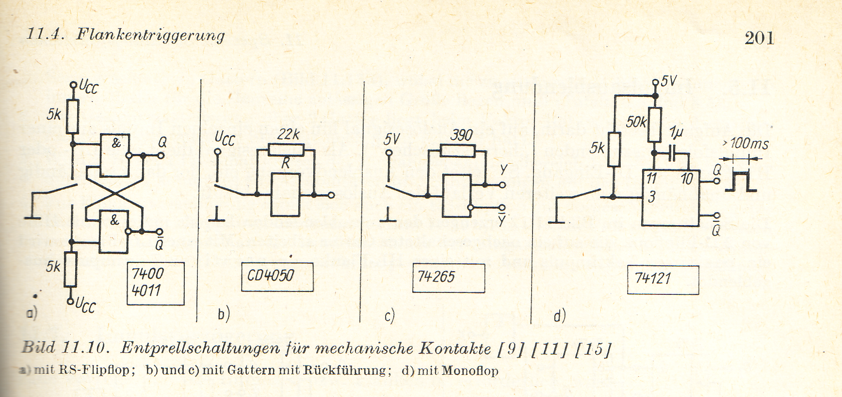

On 9/8/12 11:50 PM, Sergey wrote:
This diode
in the configuration shown on the diagram is useless.
It does look backwards. A common POR circuit has a R/C
in series, with a diode across the R so that when power
is removed the C discharges through the diode. Sometimes
a reset switch is added which can also discharge C.
     +V
   _ |
   ^ R
   +-+---- to Schmitt trigger input
     C
     GND
Hello friends,
these methods are working
Regards
Wolfgang
