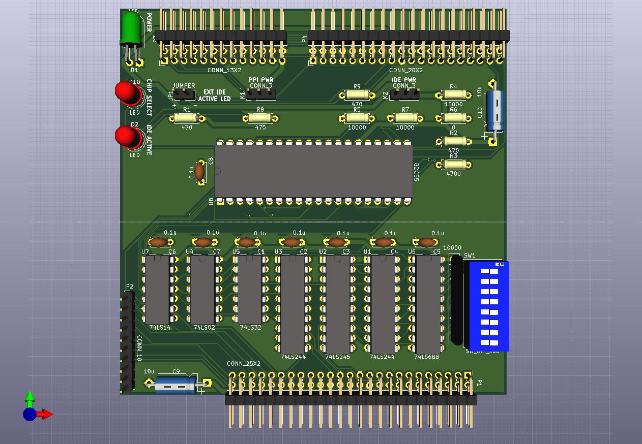

Z80 PPIDE
/forum/index.php?t=getfile&id=2187&private=0
update: readying board for order. Will post Gerber files when available
update: ordered PCBs, posted Gerber files
update: ordered parts from Jameco, should arrive next week
update: PCBs arrived, Jameco parts arrived, starting build. Still awaiting some parts (connectors) from eBay
update: Z80 PPIDE board build and partially tested. Still missing connectors but all other parts installed or ready to install. Have 8GB CF and IDE to CF adapter board. Board responds to IO port queries from dbgmon and seems reasonable but testing limited without remaining connectors
[Updated on: Thu, 24 June 2021 09:32]

Z80 PPIDE seems to work fine. Tested with PPIDETST (Thanks Max!) and it seems to be working well. Finishing up DSKY ng and it seems to be working with TSTDKSY (Thanks Wayne!) so I am pretty happy.
/forum/index.php?t=getfile&id=2213&private=0
I still have one remaining full set of PCBs if anyone in the US would like them. Please let me know and I'll send them to you.
