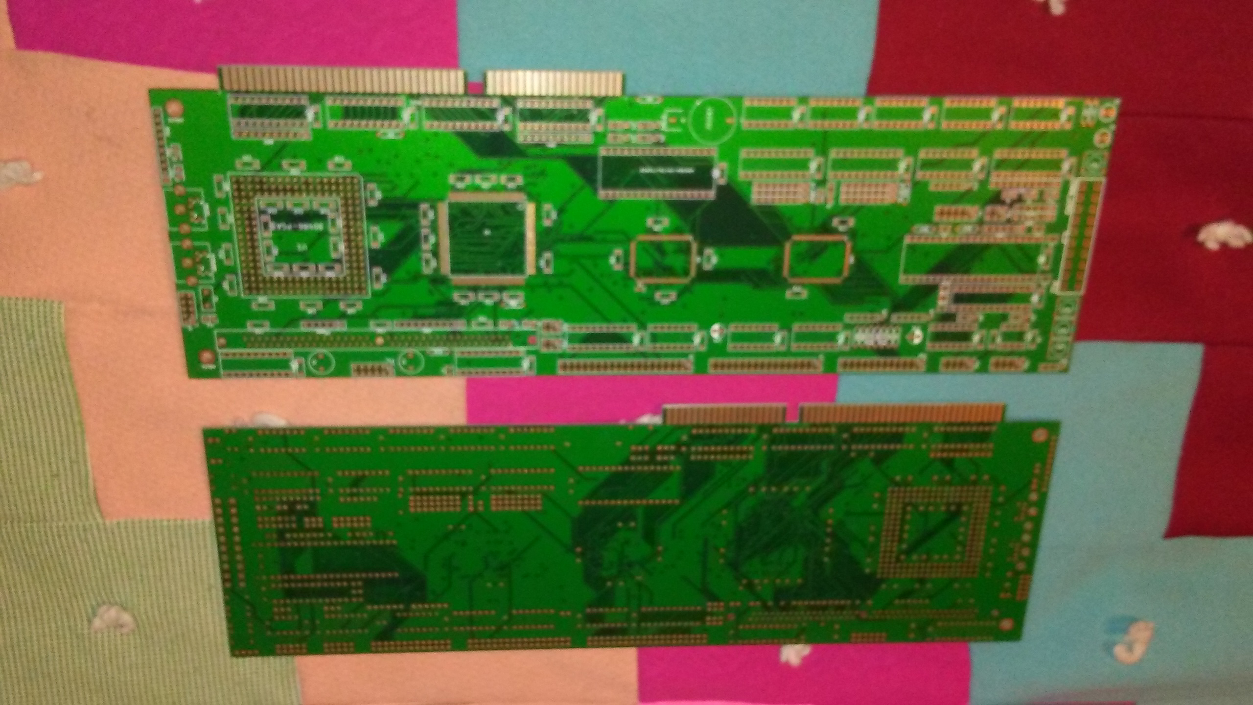

Re: Linux capable home brew SBC project [message #2842 is a reply to message #2829] Sat, 20 May 2017 05:27 Go to previous messageGo to next message
One sort of weird thing which happened is easyEDA.com sent me 6 boards when I ordered only 5. Not quite sure why but I am holding the board assuming there is a "surprise" in store and someone will need a replacement board. I suspect they had to do a second run and these were the best of the 10 or maybe there was something marginal in one of the boards. Or maybe they were just feeling generous. Who knows?
index.php?t=getfile&id=439&private=0
[Updated on: Sat, 20 May 2017 05:45]
Re: Linux capable home brew SBC project [message #2845 is a reply to message #2842] Sat, 20 May 2017 05:48 Go to previous messageGo to next message
Oh, as a note of caution. This is an initial build and test. Don't assume anything! Use all the precautions you normally would with a first time build like check the power rails, install only the components you need to test, etc. Slow careful step wise build process. I was as careful and thorough as I could be with Derpy but it is an ambitious project and Murphy is going to have a field day!

I received mine on Saturday, but haven't had a chance to do anything with it, yet.
- Alex

Received my board yesterday, pretty fast!
Still searching for some of the components. If someone found the chipset please share the link Very Happy
Re: Linux capable home brew SBC project [message #2885 is a reply to message #2884] Wed, 24 May 2017 04:38 Go to previous messageGo to previous message
There are some vendors listed on the wiki dev page under "general/brainstorm". Please feel free to update the wiki page. Thanks Andrew Lynch
https://www.retrobrewcomputers.org/doku.php?id=dev:boards:li nux-sbc:start
