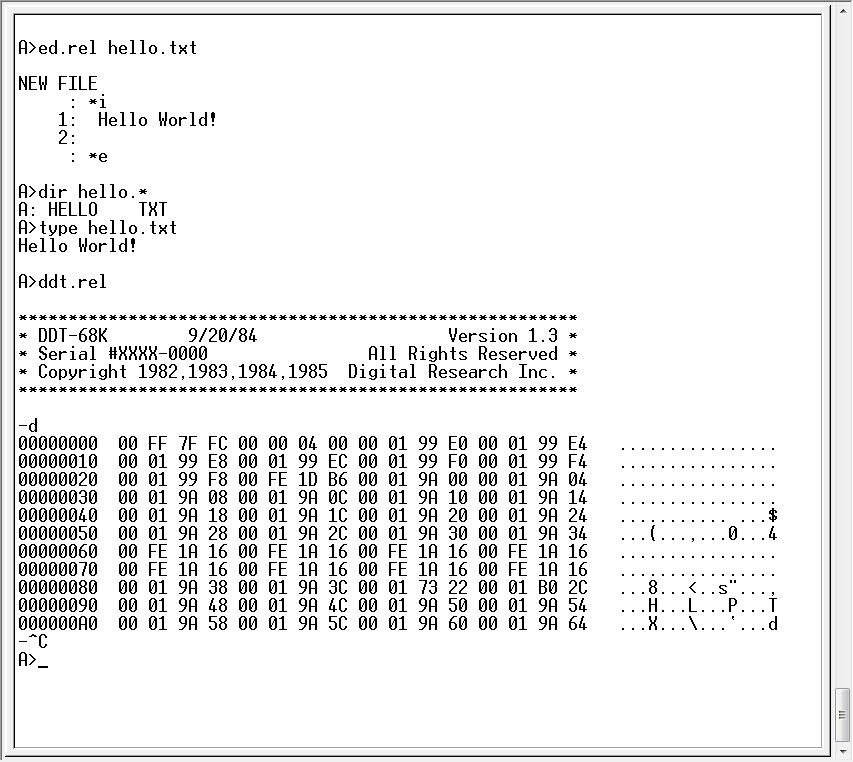

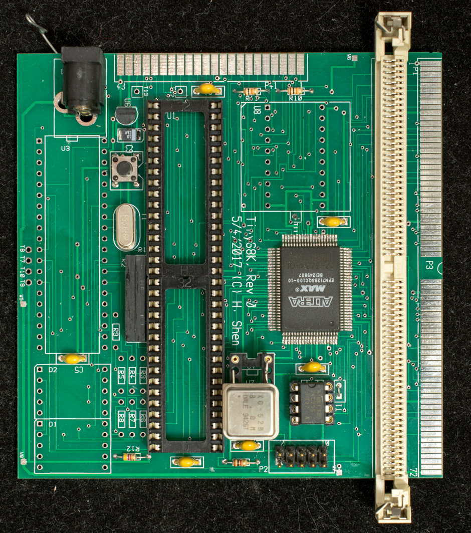

Received the pc board back. The turn-around time is 7 days. Built up the first board to develop CPLD equations. The state machine for serial EEPROM loader is somewhat complex and I don't have a simulator so I'm using the actual hardware to test out the CPLD code. It was going pretty well until my USB Blaster die right in the middle of the testing. It'll be a couple more weeks before I have the replacement.
All the Tinyxxx will run Lee Davison's Ehbasic. I'm impressed with Prof Chuck Kelly's EASy68k toolchain so I make them compatible with EASy68K. I have not tried CP/M 68K, mainly because I don't have IDE interface up till now. Tiny68K has the 44-pin CF IDE interface and 16megabyte of RAM, so I'm looking forward to port CP/M68K.
index.php?t=getfile&id=430&private=0

Re: Plasmo's 68k pathfinder projects [message #2942 is a reply to message #2813] Wed, 31 May 2017 17:20 Go to previous messageGo to next message
This is embarrassing!
I received the replacement Altera USB Blaster last week. It works just fine so I'm ready to assemble the rest of the board, so I thought. Imaging my surprise when I realized DIP64 68000 is NOT 600mil wide! Embarrassed Instead it is 900mil wide. After a bit of denial and cursing I decided I can just solder one row, tilt the 900mil 68000 45 degree and connect the other row via wires. I don't suppose anyone would be interested in this version of the pc board now.
index.php?t=getfile&id=487&private=0
The good news is that I used the time waiting for USB Blaster to learn about Altera Quartus' native simulator. It is actually pretty decent and more than adequate for CPLD designs of modest complexity. I'm able to check out most of the serial EEPROM loader functionalities. It appears to be working--I'm able to load a small NOP loop code in serial EEPROM into DRAM, release reset and have 68000 execute it endlessly. A simple memory diagnostic checking part of the 16meg DRAM also works fine.
Between the DRAM controller, serial EEPROM loader, and address decoder I used up 95% of the logics in EPM7128--121 flip flops out of 128 available.
I program the 24C256 use a $5 USB CH341A serial EEPROM programmer. The toolchain for developing serial EEPROM bootcode in 68000 assembly is:
write & assemble code in EASy68K-->convert S Record to binary file with EASyBIN-->load the binary file with CH341A.exe and program the AT24C256 serial EEPROM.
EASy68K & EASyBIN are downloaded from easy68k.com
CH341A can be found from the download link of this youtube instruction on how to use EEPROM programmer:
https://www.youtube.com/watch?v=L0ChYNwunUE
[Updated on: Wed, 31 May 2017 17:35]

Re: Plasmo's 68k pathfinder projects [message #2945 is a reply to message #2943] Thu, 01 June 2017 08:47 Go to previous messageGo to next message
I designed with what I have and I have a number of 68000 in DIP64. Now I remembered it is 900 mil wide, I think I can actually save board space because the CPLD and DUART can fit under the chip freeing up the other half of the 100mm x 100mm board for video and Ethernet.
Yes, it is a 33 ohm serial terminating resistor at the source (address strobe) on pin 6. Early on I thought I had a possible glitch due to reflection, but it was instrumentation error.

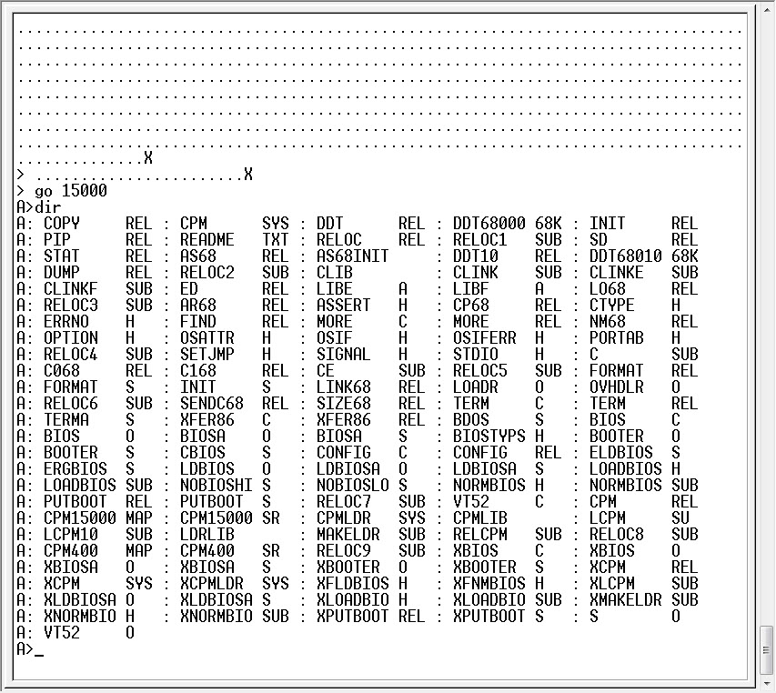

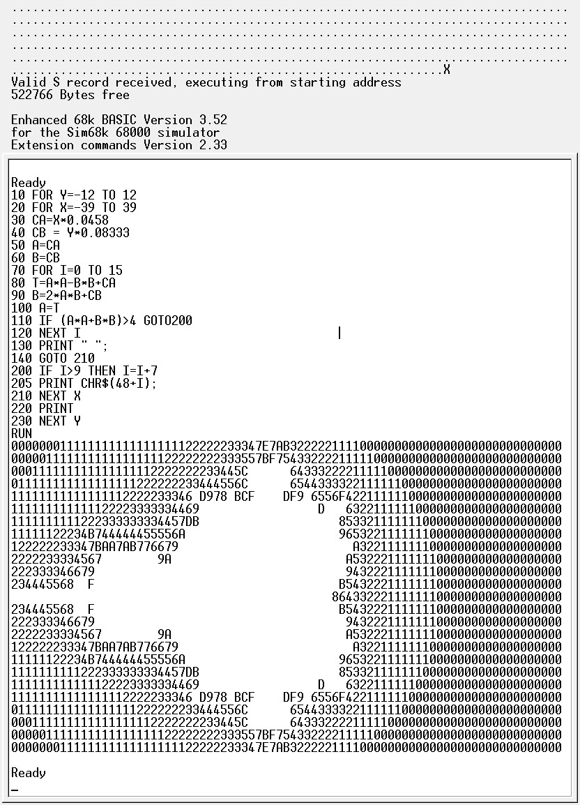

Re: Plasmo's 68k pathfinder projects [message #2968 is a reply to message #2945] Mon, 05 June 2017 17:35 Go to previous messageGo to next message
Its alive!
index.php?t=getfile&id=491&private=0
All 68000's 16 megabyte memory space is taken up with a 16meg SIMM module except the top 32K bytes which are allocated to 68681 (DUART), IDE, and the expansion edge connector. The DRAM should be fast enough to run at zero wait for the fastest 68000 (20MHz). I have a 68HC000P10 running at 8Mhz right now. The refresh logic is CAS-before-RAS running automatically invisible to the the 68000 by inserting wait state to DRAM access during a refresh cycle. The monitor is about 11K bytes. The serial EEPROM loader loads half (16K bytes) of the AT24C256 into low memory of DRAM at powerup or reset. The serial clock is 500KHz so it takes about 300mS to load the monitor, barely noticeable.
The monitor uses EASy68k trap #15 services for I/O so Lee Davison's EhBasic runs with very little modifications-- two changes: org to 0x4000 & disable DUART interrupts. I got the ASCII art program from tobster's hackaday page and I use it as a performance benchmark. The program takes 102 seconds to run on the 8MHz Tiny68k. It takes 29 seconds on Tiny030, 22MHz 68030.
index.php?t=getfile&id=492&private=0

Hey, I may have a CP/M 68K v1.3 working on my Tiny68K!
pictured here: https://www.retrobrewcomputers.org/forum/index.php?t=msg& ;th=152&goto=3022&#msg_3022
"DIR" gets me this listing:
index.php?t=getfile&id=526&private=0
"ED.REL Hello.txt" and "DDT.REL" get me this:
index.php?t=getfile&id=527&private=0
I've never had a CP/M computer so I'm unfamiliar with the various commands and functions. I feel like a kid on Christmas morning opening his first computer.
I'm following the instructions of "CP/M-68K operating system System Guide", modifying the sample BIOS to fit my serial device and CompactFlash and uploading the BIOS along with cpm15000 S-Record. The kludgy part was moving CP/M distribution files downloaded from http://www.cpm.z80.de/download/68kv1_3.zip into a CompactFlash and convert into CP/M directory format on my Tiny68k.
Still many things to check out, but I've cracked open the door and the world beyond bckoning!
  • Attachment: cpm1.jpg
    (Size: 201.23KB, Downloaded 1814 times)
  • Attachment: cpm2.jpg
    (Size: 137.33KB, Downloaded 1808 times)
Re: Plasmo's 68k pathfinder projects [message #3138 is a reply to message #3137] Sun, 02 July 2017 16:52 Go to previous messageGo to next message
Some performance specs:
- The 68000 is running at 8MHz, serial port is 38.4k baud.
- Power consumption is 350mA at 5V.
- Memory access to the 16meg DRAM is zero wait state.
- Compactflash IDE is bus connected with 1 wait state access.
- CF (SanDisk as pictured) read access is 250K bytes/sec, write access is 45K bytes/sec.
- All 9 floppy disks from the CP/M v1.3 are copied into drive A which is 8 megabyte, block size of 2048 bytes and 512 directory entries.
- I allocated most of the 16meg memory for TPA which is from 0x20000 (just above CP/M) to 0xE20000, about 14 megabytes.
- Since this is my first CP/M machine, I have no speed reference. "DIR" command responds immediately, the bottleneck is the 38.4kbaud serial port. Is there a benchmark I can run against?
- I have not figured out how to block/deblock 128 byte/sector of CP/M into 512 byte/sector of the CF, so each 128-byte CP/M sector takes a full 512-byte CF sector--very wasteful, something to work on in the near term.
