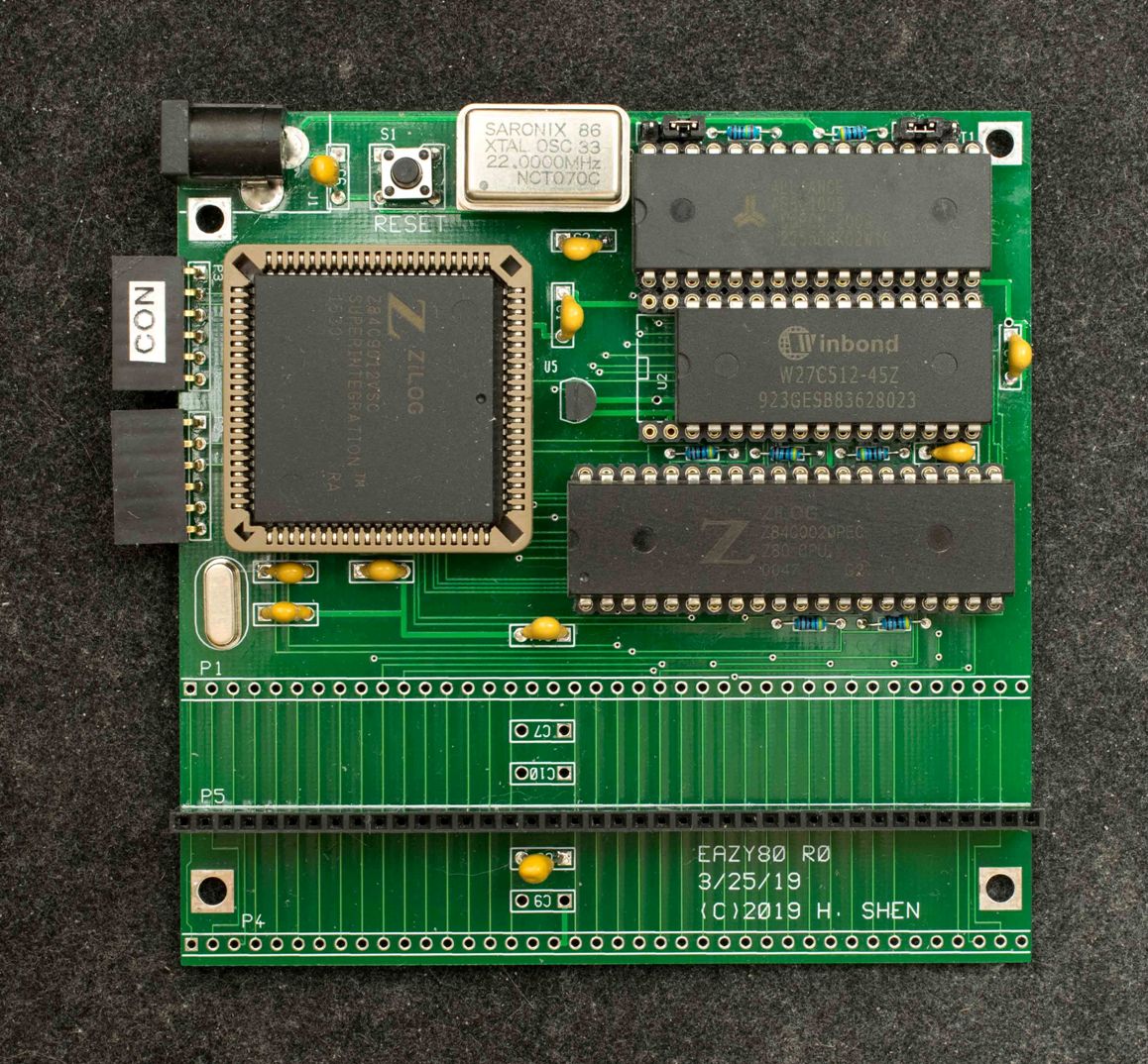

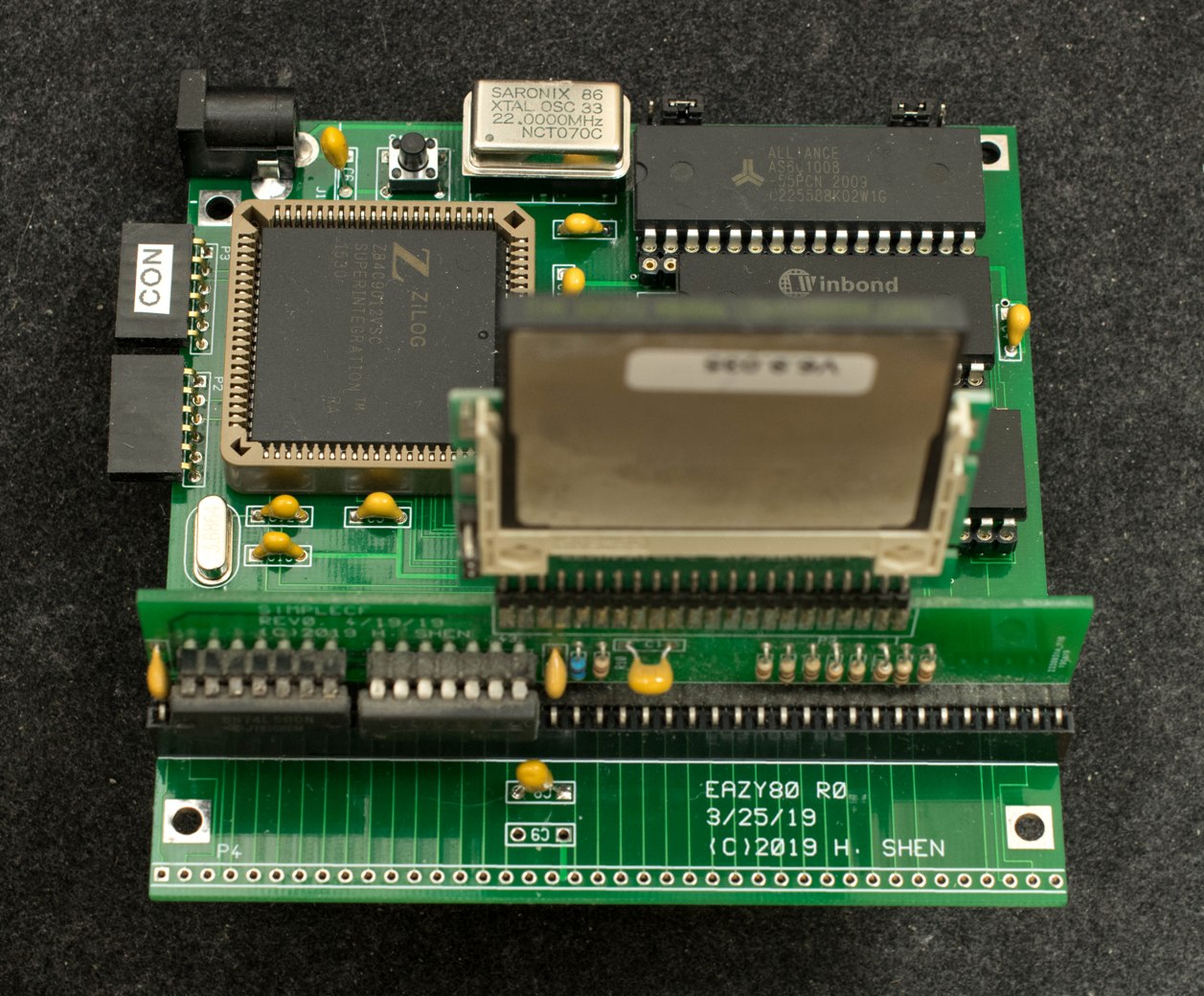

EaZy80 was a 4-1/2 year pc board design that was forgotten. It was not assembled and powered up until recently when I rediscovered it while rummaging through pc boards. The design approach was a glue-less Z80 SBC very similar to Simple80 but used KIO (Z84C90) for I/O. KIO is much faster than Simple80's SIO thus can run at much higher CPU clock. The nominal operating frequency of EaZy80 is 22MHz, but it has been overclocked to 31MHz successfully. Second picture shows it working with Simple80's CF board to run CP/M.
I generally design with CPLD, but this is one of few designs without CPLD, so it is easy to find parts and put one together. While the parallel CF interface is faster, KIO has plenty of IO lines to bit-bang SD disk and talk to DS1302 RTC, so a CP/M computer can be created without any glue logic.
EaZy80 has 128K of RAM. The 2nd bank of 64K is accessible by manipulating KIO's PC0 output. Bank sharing routines are installed at high end of both RAM banks, so data can be shared between two banks. Ladislau Szilagyi has enhanced HiTec C and TE editor for Simple80 based on these bank sharing routines. I believe the same routines will also work for EaZy80.
Another thing to explore is replacing the 128K RAM with 512K RAM and port RomWBW to it. However, I don't know how to do that with 8 banks of 64K RAM, but with the addition of a quad OR gate (7432), 16 32K banks are possible which definitely will support RomWBW.

Eazy80 rev0 has been updated to rev1 which corrected all bodges in rev0 pc board. It is functionally same as rev0, but the three RC2014 expansion connectors are replaced with prototype area to facilitate experimentation with KIO. Homepage for rev1 of Eazy80 is:
https://www.retrobrewcomputers.org/doku.php?id=builderpages: plasmo:eazy80:eazy80r1pcb:eazy80r1home
One feature added to Eazy80 rev1 is an uncommitted 14-pin DIP for experimenting with 512K RAM and RomWBW. I have demonstrated that RomWBW can be ported to Eazy80 by replacing 128K RAM with 512K RAM, adding a SD card, and wiring in a 74HCT32 in the 14-pin DIP location. The RomWBW conversion is documented in this section of the homepage:
https://www.retrobrewcomputers.org/doku.php?id=builderpages: plasmo:eazy80:eazy80r1pcb:eazy80r1home#eazy80_modifications_ for_romwbw
