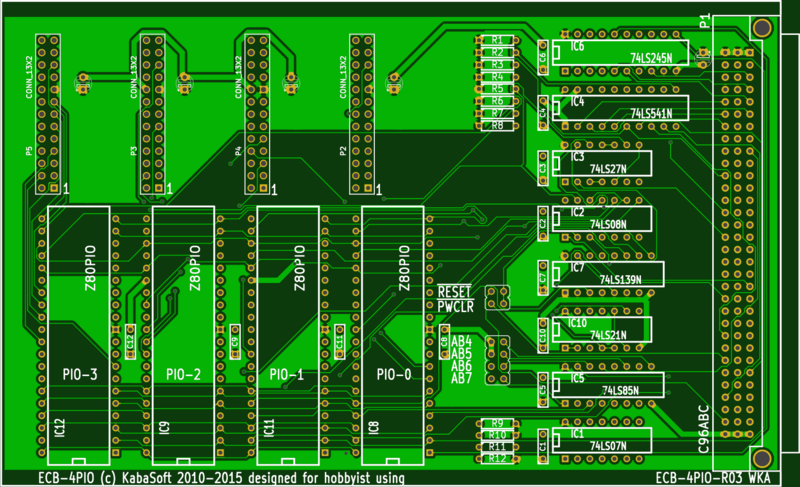

The ECB-4PIO is a digital input and output interface board. It's a 100x160mm Eurocard Kontron compatible board designed to work with the Z80 SBC V2 processor board.
Revision 3 board:
Revision 3 board (port 90h Kontron reset):

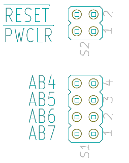

The board occupies 16 I/O addresses. Jumper S1 defines the start address. Jumpers for A4 to A7 of S1 define the upper 4 bits of the start address. Refer to the address guidelines to identify available address for your system.
A4 7-8 POSN 4 A5 5-6 POSN 3 A6 3-4 POSN 2 A7 1-2 POSN 1
The default settings for the ECB-4PIO is a base address of 0x20h:
A4 7-8 ON A5 5-6 OFF A6 3-4 ON A7 1-2 ON
For address setting is important to note that “ON” is a zero and “OFF” is a one (The switches are set to GND!).
Jumper S2 is the board reset select option. Jumper position 1 (1-2) to set legacy mode. Jumper position 2 (3-4) to select Kontron mode. All board in your system should be set to have matching settings. Check the SBC V2 Errata notes if you are intending to run on Kontron compatibility mode.
3-4 set to /RESET (C31, N8VEM) 1-2 set to /PWRCLR (C26, Kontron compatibility)

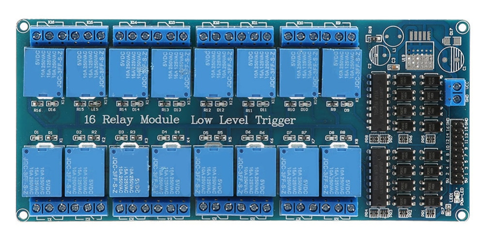

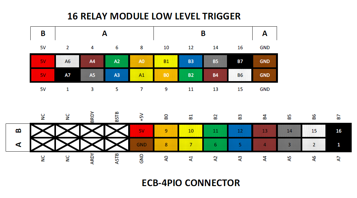

Example connection to a 16 bit relay board:
