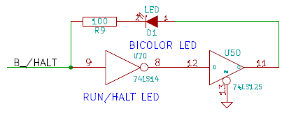

According the to circuit diagram it's a  BICOLOR LED.  See the attached snip.

> Is it? on the parts list it says its Jameco Part # 253833 which is a "LED
> Uni-Color Green" Single color LED.
> cheers for the info though.
> On Monday, September 24, 2012 4:37:33 PM UTC+9:30, opticpow wrote:
>> Hi Lucas,
>> I has the same issue putting mine together. The issue comes from the fact
>> that it is a dual colour led, so if you get it wrong, the colours will just
>> be swapped. Looking at my photo, I believe the flat side on the led goes
>> towards the power connector to get the Red / Green colours around the right
>> way.
>> Cheers,
>> Wayne.
>> On Monday, September 24, 2012 4:24:16 PM UTC+10, LucasFraser wrote:
>>> Just wondering which way LED's and diodes and such should go on the
>>> SBC-V2? after some google'ing some say the square pad is positive and some
>>> say the round pad is, so which way is it for the SBC?
