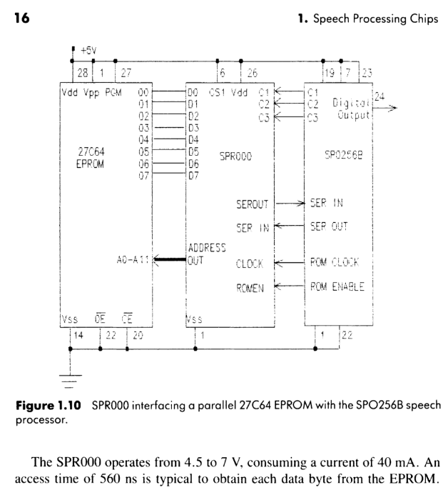

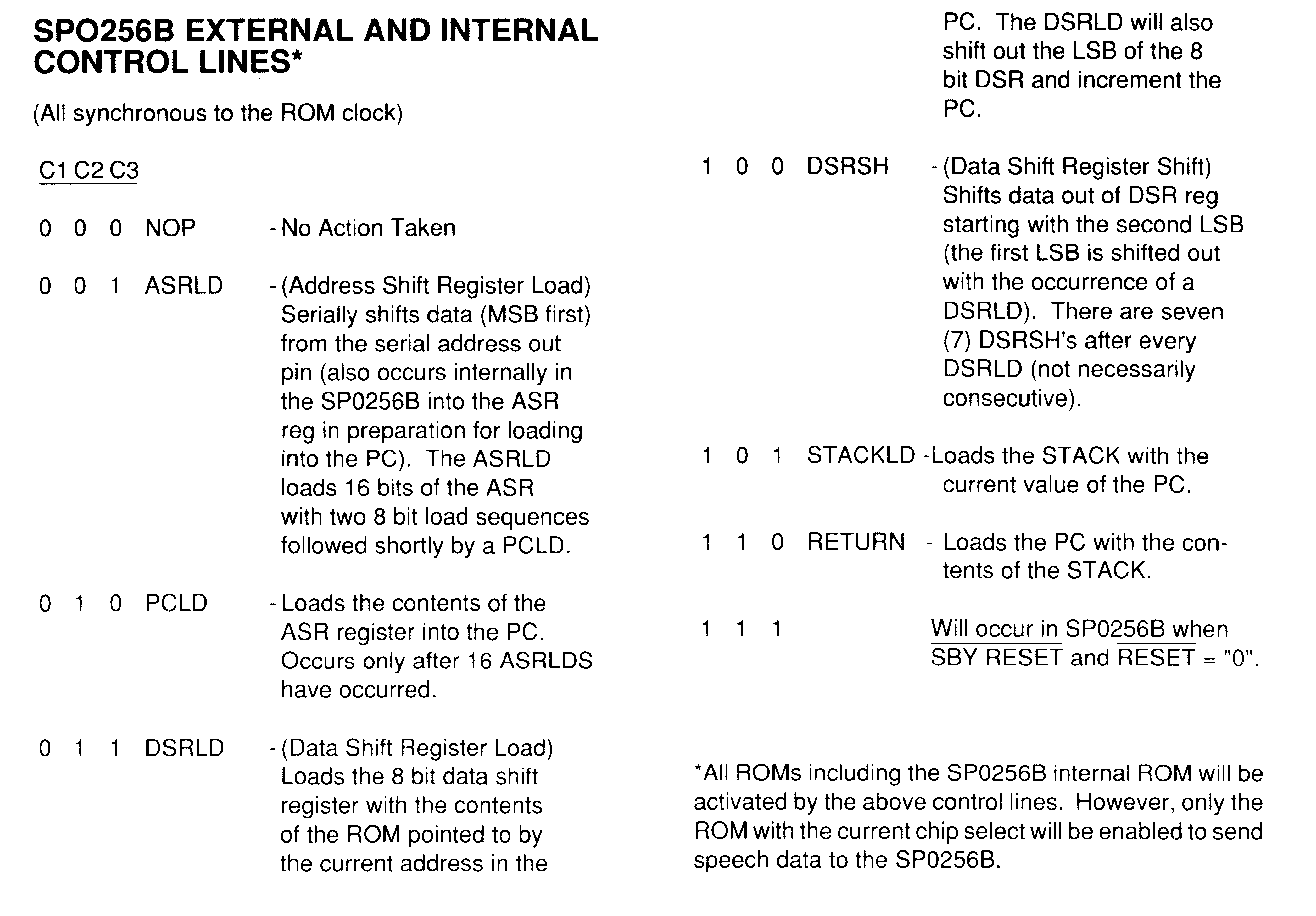

Re: Theoretical Method to read a SPR-xxx External Rom with an Arduino [message #10717 is a reply to message #10687] Tue, 16 April 2024 11:23 Go to previous messageGo to next message
Hi Jay
Check this out, the datasheet for SP0256B has an important clue. Look on page 2 under test modes. One of the test modes tell the SP0256 to ignore its on-board ROM and use the external serial speech ROM via SPR000. All I need now is a datasheet for the SPR000 and/or SFD2000 and I can build a board to emulate a SP0256 using an external ROM.
I might also possibly have a line on an ancient SFD2000. Maybe the owner will sell it to me for some reverse engineering. Possibly but I wouldn't bet big money on it.
Also, with some analysis, actually replace the SPR000 with something different (eventually). Pretty cool eh?

Re: RPi Pico W wrapped around a SP0250 or SP0256 [message #10720 is a reply to message #10718] Wed, 17 April 2024 04:10 Go to previous messageGo to next message
Hi Jay
The info in the SP0256B datasheet is useful whether you use an SPR000 or a custom replacement to interface the serial speech ROM to parallel memory. I think the ideal long term solution would be to recapture the SPR000 design as a CPLD. I think that's doable. I'd really like to implement an SPR000 as discrete components first but that's probably unlikely. The real benefit is there seems to be a clear path ahead for getting the SP0256 to use external ROM for it's info. It might not even require custom CTS256 firmware depending on how you read the datasheet. In theory, any SP0256 could be made to use external ROM and ignore whatever junk was programmed in its internal ROM. That would reintroduce many parts back on the market as usable SP0256s. The marketplace is flooded with surplus "junk" SP0256s with data other than the 59 allophones like the -AL2.

Actually, I think the SPR000, treated as a unknown black-box boundary, can be reverse engineered relatively easy; as a parallel effort to TTL and CPLD. I've been focusing on the SP0256 and SPRnnn serial ROM documentation. While the documentation has serious gaps, I think there is enough information in the bitsavers.org links to General Instrument documents to deduce the interface, at least close enough to converge with some experimentation.
I'm composing a message to explain its basic operations as far as I can at this time... that might help someone else to see the next missing piece or help them first-design more accurately at a SPR000 design target.
As General Instrument designed both parts, they could have (and seem to have...) taken many advantages, such as reading the next ROM/EPROM byte while the previous byte is shifting out toward the SP0256. That's something that needs to be in a TTL or CPLD circuit version, to maintain the speedy transfer. For example, most documentation seems to suggest that the ROM/EPROM data read-in, would be from blocks of sequentially addressed data, that the SP0256 serializes internally to load its registers, maybe even as a parallel load to a set of registers or all registers. So an auto-incrementing address counter, could be starting the next ROM/EPROM read as soon as the previous read was latched into the DSR (Data Serial Register) to be clocked out to the SP0256. The pre-read timing should be implemented into the TTL and CPLD circuit for best realization of the SPR000; emulating serial ROMs with bytewide memory.
Loading the ASR (Address Serial Register) would only need to be done for the first address of the data block to be read and transferred to the SP0256. Thereafter as each subsequent ROM byte is available and transferred into the DSR (Data Serial Register), the ASR is incremented and the next ROM address access time begins. These 'sweet' efficiencies can be designed into GI-to-GI components... and would be enough circuitry to justify the single chip SPR000 to do the same task, at speed, to bytewide memory.
This also fits GI's market strategy at that time; designing single chip replacements for semi-standardized common circuits in TV and other electronic appliances, in an age before pick&place assembly was available. GI's single chip standard circuits improved an electronic appliance companies' manufacturing, inventory, service repairs, design time, and reduced errors characteristic to numerous components being manually insertion to circuit board. There are also advantages of less tuning needed when all components are on the same IC circuit, when compared to numerous discrete components with individual performance within wide specification ranges.
This is why I need to compose that more detailed operations message, so the TTL and CPLD parallel efforts can more closely take the same sort of transfer time advantages that GI likely took. I think after doing that, I might wrap an Arduino around a SP0256 and emulate the upstream and downstream interface to it in software. Useful for testing and converging on a reverse engineering design for the SPR000; but I'm NOT suggesting an using Arduino as a SPR000; it's just a lab-tool.
Note: The SP0256 has, 'effectively,' a single address stack. It seems to be available so a sequential block being read, can be pause and its program counter saved on the stack, to insert a read of another commonly useful addressed sequential block, or segment that block, elsewhere in ROM. This could be used to insert phrases used over and over again.

Re: Arduino lab tool wrapped-around a SP0256 to reverse engineer an unobtainium SPR000 [message #10746 is a reply to message #10745] Wed, 01 May 2024 17:09 Go to previous messageGo to next message
There is really good information in the SPR016 datasheet which helps explain how the SPR000 *should* work. There is a block diagram showing the information flow. Basically substitute a parallel EPROM (2732) for the internal mask ROM and you're there.
The SP0256B datasheet has some good information on the SP0256 serial ROM command sequences and also timing diagrams.
I think there is enough information to piece together a SPR000 workalike but not enough to reverse engineer the SPR000 itself. Still no pinout information.
I am hoping to purchase or borrow an SFD2000 and use my VOM to ohm out the PCB and using datasheets for the other chips (74LS138, SP0256, 2732) deduce the SPR000 pinout sufficient to make a test board. Maybe that will work but it is dependent on a series of miracles happening. It's a rather dicey proposition at this point.
The timing requirements of the synchronous 1.56 MHz clock pretty much rules out the MCU approach. Maybe a Raspberry Pi Pico coded in assembler might be fast enough -- maybe -- but it also has to be 5V tolerant at least. I think the CPLD approach is probably the highest probability of success but that's no slam dunk either. The information in the SPR016 and SP0256 datasheets is pretty sparse and may be missing important details.
Best of luck! Thanks, Andrew Lynch
PS, the best info I have on the internal guts of the SP0256A-AL2 found here: http://spatula-city.org/~im14u2c/sp0256-al2/

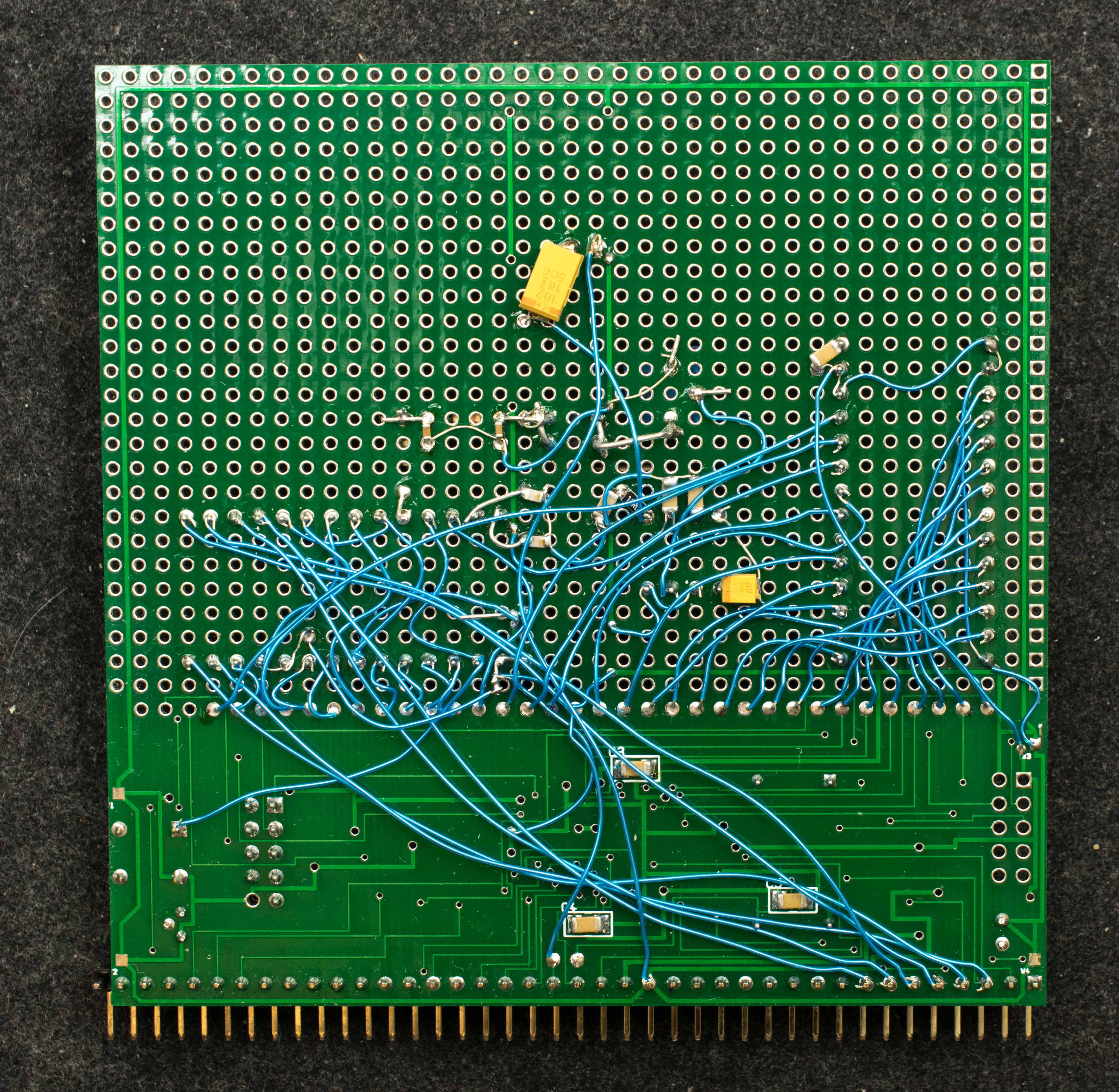

Today I received the 2 SP0256AL2 I ordered from 351_windsor. I also have the CPLD protoboard checked out. It is ready to wire in the circuits for SP0256-AL2. I don't have 3.12MHz crystal, so I plan to either divide the 22Mhz Z80 clock by 7 to 3.14MHz or divide the 25MHz oscillator on the protoboard by 8 to get 3.125MHz. The audio amplifier is LM386 which I have many on hand. The immediate goal is have Z80 drive it to make some sound. I should be able to spend an hour or two a day working on this.

Re: Has anyone reverse engineered SP0256A external serial speech ROM [message #10756 is a reply to message #10651] Sun, 12 May 2024 20:46 Go to previous messageGo to next message
I also have ordered 3.12Mhz crystals from Mouser. After a bit of troubleshooting, the SP0256 from 351_windsor is working. Here is a short video of it talking. The breadboard is controlled by Z80 over RC2014 bus. The CPLD is hardly utilized in this configuration, but it will play a more active role when the internal ROM is replaced with an external ROM.
Re: Has anyone reverse engineered SP0256A external serial speech ROM [message #10757 is a reply to message #10756] Sun, 12 May 2024 20:51 Go to previous messageGo to next message
I think the attachment is too big. Here is a smaller version
Re: Has anyone reverse engineered SP0256A external serial speech ROM [message #10758 is a reply to message #10757] Mon, 13 May 2024 03:12 Go to previous messageGo to next message
Hi Bill
That's great! I gather you are using the SP0256 alone and using only the Z80 with it?
Did you write or found a Z80 program to drive the SP0256 directly?
Looking forward to the next step. First is to get the SP0256 into a test mode to disable the internal ROM.
Then add the logic to the CPLD to emulate the SPR000 chip.
It's described at a high level in the SP0256B and SPR016 datasheets but far from specific implementation.
Re: Has anyone reverse engineered SP0256A external serial speech ROM [message #10759 is a reply to message #10758] Mon, 13 May 2024 06:08 Go to previous messageGo to next message
The protoboard has CPLD to interface to RC2014 bus where I/O address $ee selects allophone value and $ef monitor SP0256 status. The SP0256 is currently wired up to use internal ROM, but there is room to handle external ROM. I'll keep the internal ROM configuration for a few days since I have 3 SP0256 coming from China which are most likely fake. After that I'll wire it for external ROM configuration.
The SP0256 datasheet published by Archer has a section on Allophones and provided examples for 250 or so words, so the Z80 program just copies the allophone examples of days of the week.
/forum/index.php?t=getfile&id=3046&private=0

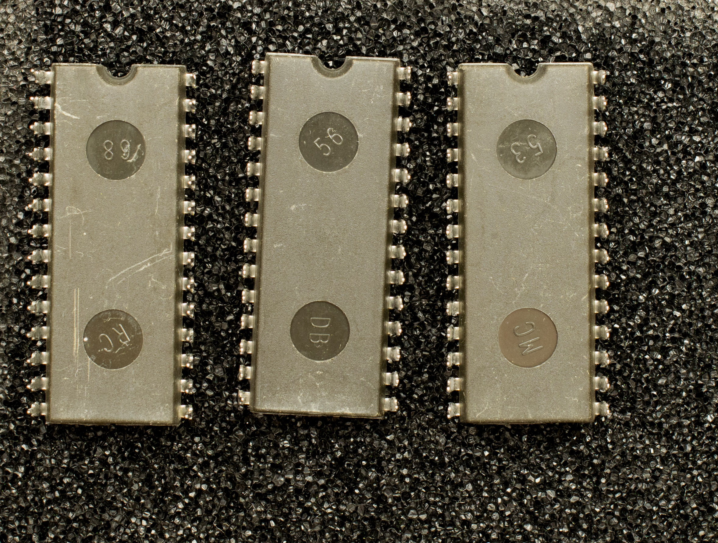

Re: Has anyone reverse engineered SP0256A external serial speech ROM [message #10760 is a reply to message #10759] Mon, 13 May 2024 09:56 Go to previous messageGo to next message
Hi Bill
That looks great! Yes, the cheap SP0256s from AliExpress are nearly all fakes. Some of those are non-AL2 SP0256A-xxx but some are just junk like OTP ROM or other 28 pin DIP chips.
The good news is if you get a non-AL2 SP0256A-xxx, we should be able to get it to work with the external EPROM and then it won't matter. I'll bet those scammers will be surprised!
Re: Has anyone reverse engineered SP0256A external serial speech ROM [message #10761 is a reply to message #10760] Mon, 13 May 2024 20:10 Go to previous messageGo to next message
I received the 3 "SP0256-AL2" from China today. Tried them out in known working hardware and none of them are working, no sound generated at all. The current consumption is lower and the working hardware continue to work OK afterward. I tried different allophone values associated with SP0256-012, -017, -019, -021, but no sound were generated. What else can I try? I would like to know whether it is a variant of SP0256.

Hi Bill
One thing you can try is using the monitor and feeding allophone addresses directly to the SP0256. Also, put in an LED on the BUSY pin on the SP0256 which would light up during speech.
If you're not seeing any activity at all even on allophone 0, 1, 2, etc. or BUSY LED then you probably have a non-SP0256 fake like a relabeled OTP ROM. You could try identifying the chip in your programmer and see if that gives some clues. Try to read the contents like a 2764 EPROM. But they are mostly electronic junk
Only some of the fake SP0256s are relabeled SP0256A-xxx chips. They do that to give something that sort of works but not like you expect it would. Other fakes are like what you probably have which are just relabeled junk ICs like OTP ROMs or MCU with mask ROMs.
Here is an article on fake SP0256 chips. I think you'll recognize these parts
https://www.smbaker.com/counterfeitfakejustplainbad-sp0256a- al2-chips
Oh, how I detest the scammers!
[Updated on: Tue, 14 May 2024 03:20]
Re: Has anyone reverse engineered SP0256A external serial speech ROM [message #10763 is a reply to message #10762] Tue, 14 May 2024 20:07 Go to previous messageGo to next message
Thanks for the link to Scott Baker. My non-functioning parts appeared in his write up, and they do not appear to be any variants of SP0256. I'll return them for refund.
I'll go ahead with external ROM implementation using the existing SP0256.

Hi Bill
Wow! That's great news! Looks good
Regarding ASRLD and PCLD commands, the SP0256B datasheet goes into detail of its implementation. I believe it needs to be a 16-bit counter for the address bus based on the text. Below is a snippet from the datasheet
/forum/index.php?t=getfile&id=3054&private=0
Am I correct in assuming the current design will fit in a EPM7064 but not an EPM7032 due to using 60 cells?
It's not clear to me what STACKLD or RETURN are even used for so they may not be included in the SP0256 implementation. Maybe they are leftovers for some other purpose?
Awesome progress! Thank you! Andrew Lynch
PS, maybe you're already doing that. What is component inst12? It looks like a 16-bit D-flip flop maybe serial to parallel converter? The design seems amazingly simple in the schematic layout. Many fewer parts than I anticipated.
PPS, I am guessing inst27 component is a 74LS74 D-flip flop. Is inst12 two 74LS164s chained together to make a 16-bit serial to parallel converter? What is inst13? three 74LS191s chained together? 74LS161 or 74LS163s? This is very interesting.
Can't wait to see how this does in test!
[Updated on: Fri, 17 May 2024 05:05]

Greetings Andrew,
Last I can find is from Designing With Speech Processing Chips book by Ricardo Jiménez. He did reference Microchip publication DS5007A-1 1984 but can't find that document anywhere.
Sincerely,
William
