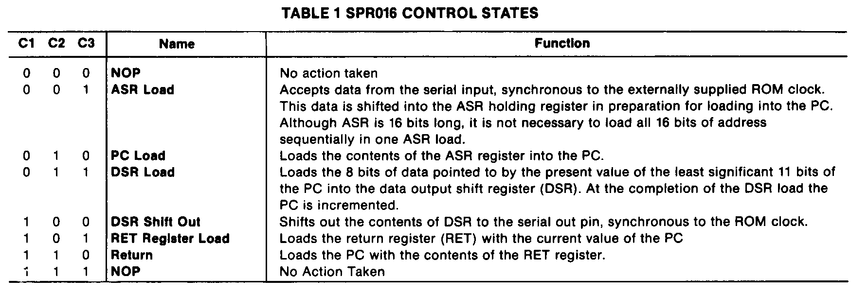

The external serial speech EPROM is quite fast since the ROM clock is 1.56 MHz requiring and solution to provide sub-microsecond response times. That says "hardware" to me or at least a very fast microcontroller. For instance, if I assume using a semi-modern PIC16F1829 (DIP-20), it has mostly (except for branches) single clock tick instructions. It also has an internal clock of 32 MHz. That provides about 20 instructions per ROM clock tick.
There are only 8 control states and 2 of them are NOPs. They seem to be basic instructions like loading registers and feeding shift registers. It seems at least conceivably within the realm of the possible. I am assuming the PIC uses its own internal memory for data storage (2KB) and/or loads its Flash from an external I2C serial Flash. Everything has to be 5V compatible to work with the SP0256.
/forum/index.php?t=getfile&id=3009&private=0
The other, less desirable alternative is to use a CPLD (EPM7032) paired with a parallel EPROM like 2716 or 2732. I am confident the CPLD would be fast enough since it would be essentially an all-hardware solution pulling data out of the paired EPROM. The interface to the SP0256 uses 7 lines and the 2732 EPROM uses 22 for a total of 29 GPIO pins which I think the EPM7032 supports.
I've thought about the problem of SP0256 external serial speech ROM expansion, but it relies on the presence of custom CTS256 firmware to work. Thus, this is really moot unless the TMS7001 with external CTS256 firmware experiment works. However, it does give an insight into what is possible once we break free from the static confines of the existing CTS256.

The SP0256 does have an internal 2KB parallel mask ROM. There doesn't appear to be a way to make it use an external parallel EPROM instead like the PIC7041. However, the SP0256 does support a specialized external serial speech ROM called the SPR016, SPR032, and SPR128. I've only seen the SPR016 models though and they are mask ROMs for specialized purposes like talking clock, etc.
What I'd like to do is use a PIC16F1829 or something similar to emulate the SPR016. The ROM clock from the SP0256 is 50% of the input crystal speed (3.12 MHz, so 1.56 MHz). The emulation has to perform sub-microsecond response times. That's a pretty tall order. The PIC16F1829 supports up to 32 MHz with its internal oscillator. Possibly faster with an external crystal source.
However, since most of the PIC16F instructions are single clock (except branching), I think that gives a ratio of about 20 PIC16F instructions to each external ROM clock tick. (32/1.56 = ~20.5)
Looking over the SP0256 and SPR016 datasheets, there are 8 commands for the external serial speech ROM and they all look to be rather primitive. Basically NOPs, loading registers, and stuffing bits in or out of a shift register. I am thinking that if branching kept to a minimum, that a PIC16F might be able to pull this off without an external oscillator. If more instructions are needed per ROM command, then I think the PIC16F with an external 16 MHz oscillator could rev the PIC16F to an equivalent 64 MHz and provide about 41 instructions per ROM clock tick. I think that should be more than enough but I'd like to avoid using the external crystal oscillator if possible.
Are you familiar with programming PIC MCUs? That is one area I could use some help with is writing the PIC assembler code to emulate the SPR016 serial speech ROM chip.
Due to its hard real-time nature, the PIC code has to be simple, or it won't meet its timelines. Of course, the entire premise of utilizing the external serial speech ROM on SP0256s rests on getting the TMS7001 with external EPROM to emulate the CTS256. Because without the ability to customize the CTS256 ROM image, the SP0256s won't know what to do with them. The CTS256 firmware will need to be modified to tell the SP0256 to use the info (59 allophones or whatever) stored in the serial ROM. As it is now, the CTS256 firmware assumes it is talking to a SP0256A-AL2 with its 59 allophones stored in its internal 2KB ROM. Everything else is ignored which is why the non-AL2 SP0256s don't work for general purpose speech synthesis. Either the 59 allophone info is not present in the internal ROM or it doesn't know to look in the external ROM.
