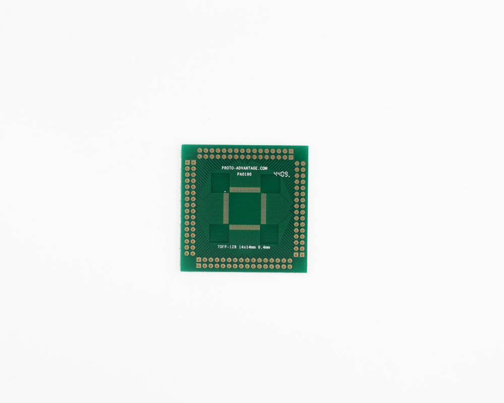

Re: Gryphon 68030 [message #810 is a reply to message #809] Mon, 13 June 2016 09:17 Go to previous messageGo to next message
I don't mind what video chip foot print we use. However if I need to construct a custom footprint I need detailed technical data.
I think the adapter we have to use is this one for LQFP 14mmX14mm and 0.4mm pitch to PGA-128
http://www.proto-advantage.com/store/product_info.php?produc ts_id=2600014
If it is a straight up PGA-128 it should be an easy swap since that footprint is a JEDEC (?Wink standard part.
However it does not look like a standard PGA-128 to me. I think the MC68030 uses a PGA-128 also but doesn't look like that footprint.
I'll make the swap tonight.
Thanks
Andrew Lynch

Hi Andrew!
My bad. I did not look carefully this morning when I got up - it is the 14mm x 14mm version 0.4mm pitch - I picked the wrong one whey I looked it up. PGA is a misnomer here - it is what they call anything that has pins on all sides here vs DIP when it only has pins on 2 sides. It is 4 dual rows of header pins on 0.1in centers i.e. think of 16 x 2 headers arranged in a square such that the square is 2 inches on a side. I think the image makes it pretty clear - I just need to check at home whether pin 1 is on inside row or outside row.
index.php?t=getfile&id=104&private=0

One of my projects that I have never finished is a small reflow oven using a toaster/convection oven. I have the Arduino-based controller all assembled that will "self leran" how to follow the actual industry standard reflow profile. I just need to buy the right oven and tear into it and make some modifications.
If one of us got something like that up and running, it would not be difficult to make a few batches of adapter boards with ICs reflowed on them. Certainly less than $20 each.
I have a week off in July, maybe if I don't end up traveling I will work on that during that week.
