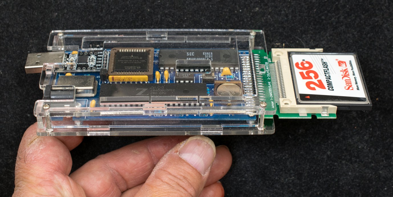

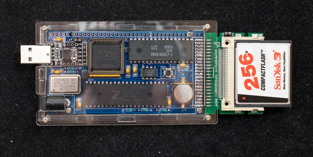

I redesigned the Z80SBC64 for the Arduino Mega case. This is the first prototype.
/forum/index.php?t=getfile&id=1314&private=0
/forum/index.php?t=getfile&id=1315&private=0
I need to fix a few mechanical misalignment, but really need to reduce the board size so the CF disk does not stick out so much. I had hoped for a through-hole design, and that may still be plausible with Z80 in PLCC44, but there is another issue: the clear case simply begs for blinking lights. Blinking lights need general purpose I/O, so I either go with CPLD in QFP100 or something else like Z84C1516. In either cases the design will definitely be SMT.
I believe your small Z180 board can easily fit in the Arduino Mega case and possibly the 1/2 size Arduino Uno case.

I thought about an Arduino case ... briefly. Instead, I've done a new layout to fit into this case - 50mm x 50mm x 19mm or roughly 2" x 2" x 0.6". Same basic specs: 33MHz Z180, 512K flash, 512K or 1MB SRAM, RTC, uSD via SPI @ 25MHz, dual serial and power via USB.
I'm just doing final optimization of the layout. The one issue is with the case's internal mounting pads ... I don't think I can use them as-is.
After this design, I'm thinking it's time to restart my eZ80 project which I started quite a few years ago.

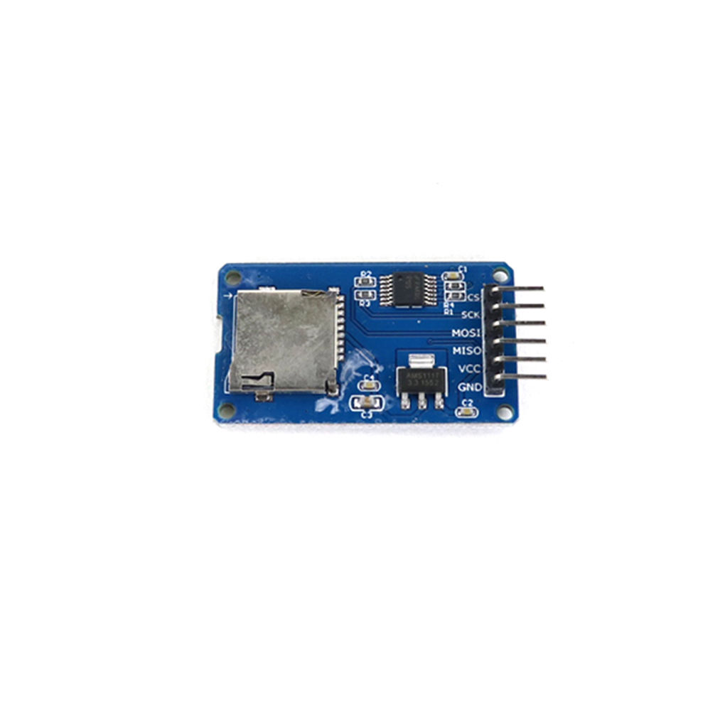

Would it make sense to use a µSD card and 3.3v convertor instead of CF once you get down to this kind of sizing ? The Raspberry Pi just tucks a µSD on the underside of the PCB.
Pi cases are also another one used for various things and available very cheaply. They are a bit smaller 85x55mm or so but also quite tall (20mm or so above the PCB) because they have to ft in the double USB connectors and RJ45 jack on the end of the Pi.
Re: A simple CP/M Z80 SBC without glue logic [message #6223 is a reply to message #6221] Fri, 05 April 2019 05:44 Go to previous message
uSD is certainly an option. There are existing adapter with 3.3V regulator and 5V-to-3V buffer for under $2 like this:
https://www.ebay.com/itm/Micro-SD-Storage-Board-TF-Card-Memo ry-Shield-Adapter-Breakout-DIP-Pins-Module/173320605763
/forum/index.php?t=getfile&id=1316&private=0
I'm tempted to just have a corresponding female 6-pin socket on board to accept the adapter board so not to fool with the tiny uSD drives.
