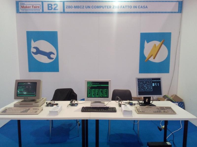

Thanks guys,
I missed it completely...
I was @ Rome Maker Faire 2019 with the Z80-MBC2... Very Happy
https://i.postimg.cc/htsJm16w/72779240-10220988458367883-2829159837651173376-n.jpg
