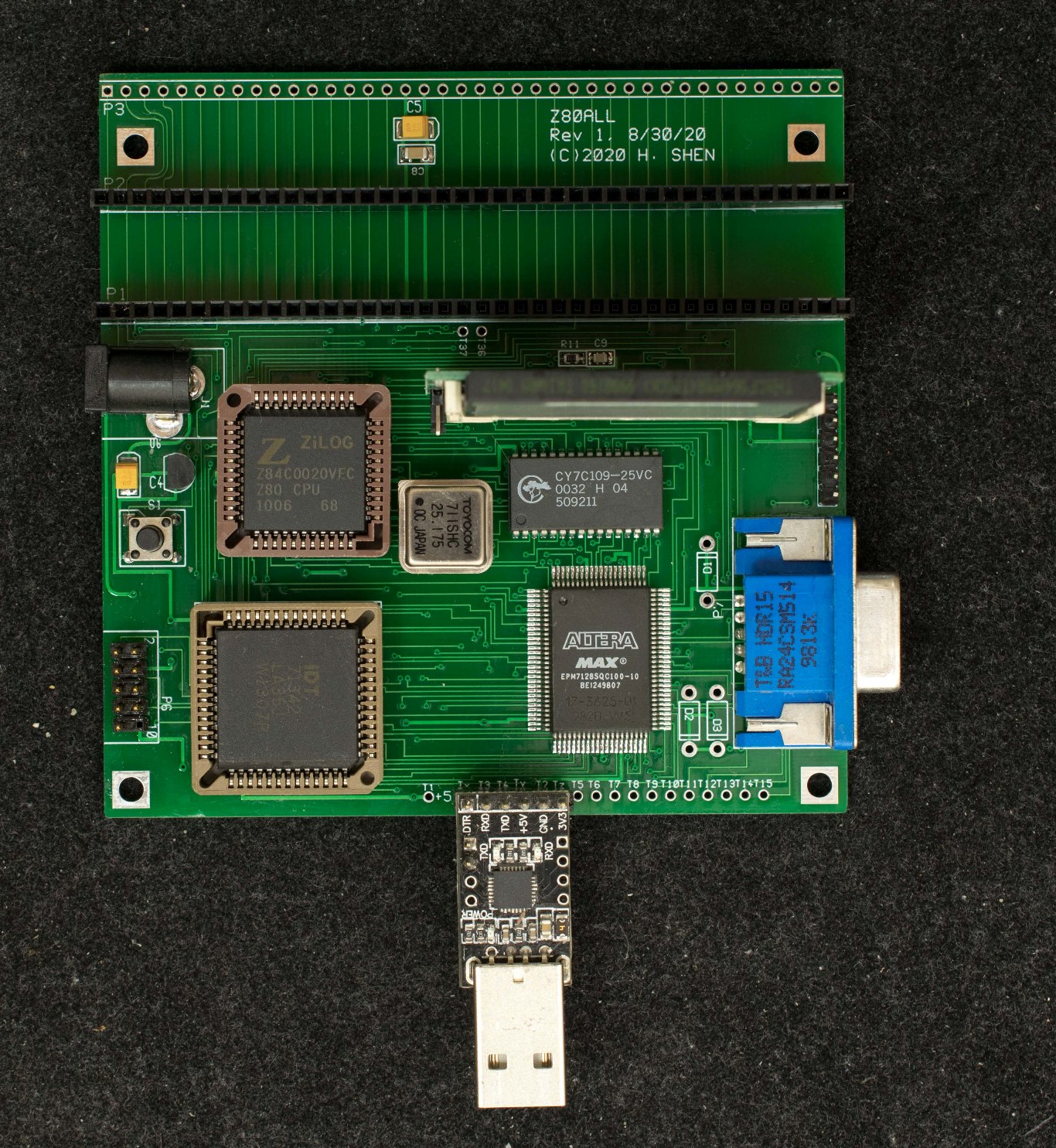

Z80ALL is my first attempt to build a standalone CP/M system. It is the combination of two previous designs, ZRCC and VGARC. The goal is an economical Z80 SBC with VGA and PS2 keyboard on a 4"x4" 2-layer pc board. Here are the features of Z80ALL:
* Z80 overclocked to 25.175MHz
* 128K RAM in 4 32-K banks
* 4K dual port video RAM with user programmable font table.
* VGA monochrome interface, 64 columns X 48 rows
* EPM7128S CPLD with the following features
- Small ROM to bootstrap from CF disk
- VGA timing circuit
- Serial port for hardware/software development
- Memory bank select logic
- Decoding logic for compact flash
* IDE44 interface for compact flash drive
* CP/M ready
* PS2 keyboard interface
* 3 RC2014 expansion bus
* Optional USB-serial connector
* 102mm X 102mm 2-layer pc board
* Nominal power consumption of 5V 300mA
You can read more on Z80ALL homepage.
https://www.retrobrewcomputers.org/doku.php?id=builderpages: plasmo:z80all
Rev0 is proof-of-concept. Rev1 pc board is currently being fab at JLCPCB.

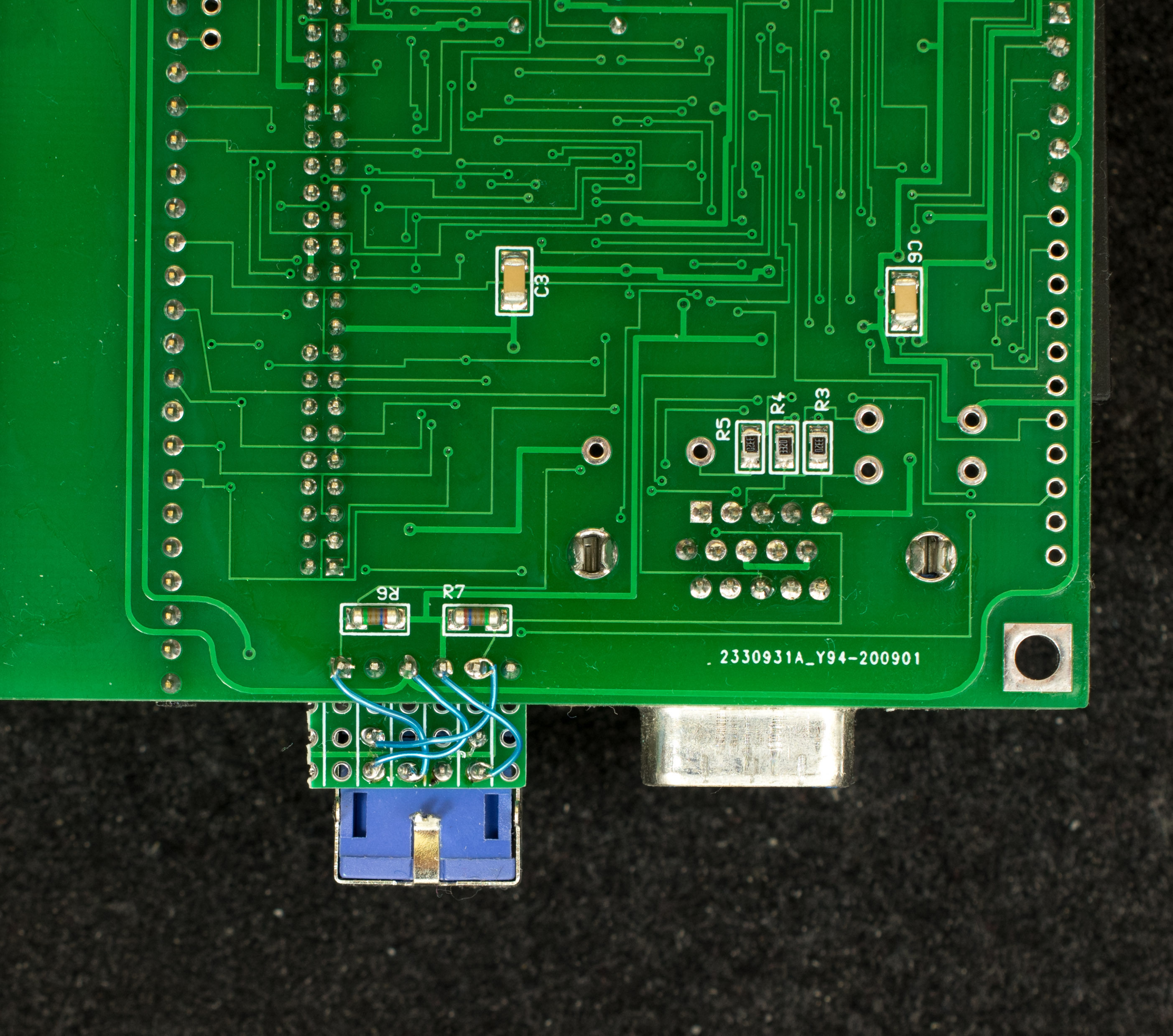

Re: Z80ALL, A standalone Z80 computer [message #7962 is a reply to message #7947] Thu, 10 September 2020 04:33 Go to previous messageGo to next message
Received the rev1 pc board of Z80all. The engineering changes of rev0 are all fixed and there are now room on CPLD for the PS2 keyboard interface. Everything is working the same but without all the kludges. Still need to revise the pc board since I'm using a 6-pin jumper instead of a real PS2 connector.

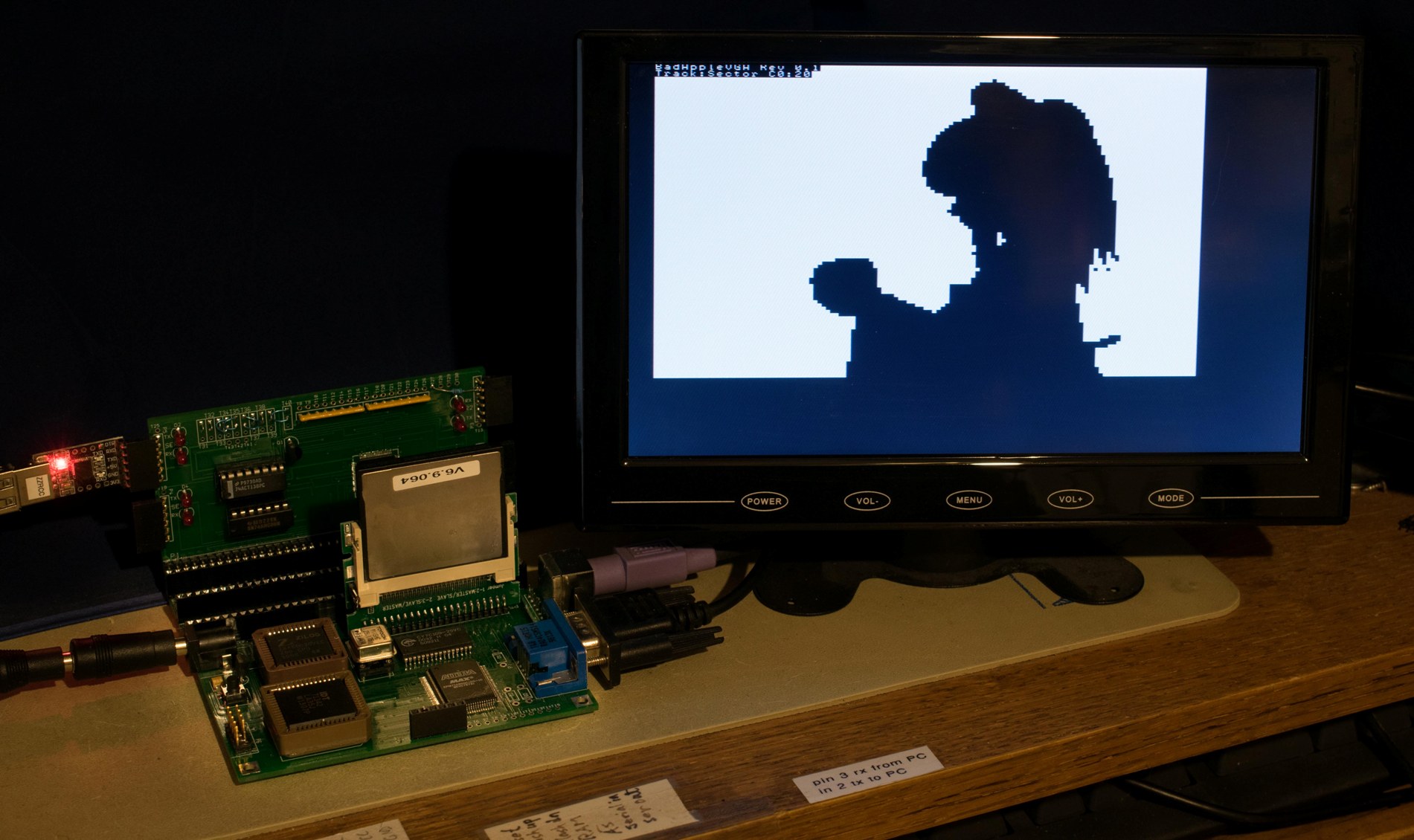

I have a little more work to do, but I am running z80 code and outputting VGA:
/forum/index.php?t=getfile&id=2131&private=0

Re: Z80ALL, A standalone Z80 computer [message #8538 is a reply to message #8532] Tue, 27 April 2021 07:23 Go to previous messageGo to next message
That's a great progress! The "moon shot" has reached the moon and looking for a way to land. Lots of things are working correctly to display the splash screen on VGA:
* bootstrap from CF's master boot block is successful;
* ZALLmonitor is loaded and running;
* the font & video data are retrieved from CF and saved on dual port RAM; and
* VGA state machine is able to display it correctly.

Re: Z80ALL, A standalone Z80 computer [message #8558 is a reply to message #8556] Wed, 28 April 2021 17:21 Go to previous messageGo to next message
This is the DIN adapter I built for the PS2 keyboard interface. I do know it can receive characters from PS2 keyboard when I stopped working on Z80ALL. I think I was struggling with BIOS that can deal with VT100-like escape sequences and also the way keyboard is polled that requires a timer that I don't have. I'll need to reconstruct the problem that caused me to stop working on Z80ALL.

Re: Z80ALL, A standalone Z80 computer [message #9992 is a reply to message #9985] Sun, 26 June 2022 09:20 Go to previous messageGo to next message
The video on Z80all is a monochrome text display with programmable fonts and 64 rows, 48 columns texts with 8x8 pixel fonts. 64x48 is not much resolution for graphic display, but it is possible to define 16 set of fonts that represent all permutation of 2x2 array such that a 8x8 pixel block can display any combination of four 4x4 pixel sub-blocks. This scheme increases the screen resolution from 64x48 to 128x96, sufficient to do low-resolution graphic.
First example is the extension of BadApple animation to Z80all's VGA display. The original BadApple is in 4:3 screen ratio so it is perfect fit for 128x96 extended text display. So the original BadApple is downsized to 128x96, splited into 3109 frames, converted to byte output format and vertical 1-bit per pixel draw mode. The resulting binary file is loaded into CF disk as a contiguous 4.7meg file. The BadApple player for Z80all VGA display retrieves three 512-byte sectors per frame and translates the data to display as 128x96 image. While there are 50% more data than the 128x64 OLED display and more processing to combine 2x2 pixels into a text character, Z80all's VGA display is much faster direct-addressable I/O so it only took 11mS to retrieve and display a frame. 20 frames/sec is easily accomplished. This is YouTube video of BadApple playing on Z80all VGA monitor in 128x96 resolution. https://www.youtube.com/watch?v=KYVQk8Nyg84
