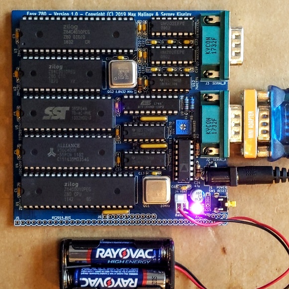

We can't have too many Z80-based SBCs, right? Smile
Well, here is another one - Easy Z80. This one was created by my son Max, under my supervision. His goal was to understand how a microprocessor system works, what it takes to design and build one. And we also wanted to make it a useful system - one that can run CP/M software - Zork?!Wink and with an option to expand the system in the future. I also wanted him to learn a thing or two about programmable logic, so we decided to use an SPLD for glue logic (and save some ICs by doing so).
Specs:
- Z80 CPU - runs at 10 MHz, but can run at any other frequency
- Z80 SIO/O - provides two serial ports. Two MAX232A transceivers are included on the board.
- Z80 CTC - timer interrupt and optionally baud rate generation for SIO
- 512 KB Flash ROM / 512 KB battery backed SRAM - same paging as implemented in Zeta SBC V2
- MAX693 microprocessor supervisor that provides reset generation, SRAM battery backup, power failure monitoring (and NMI), and an optional watchdog
- RC2014 compatible extension connector
- Runs RomWBW. Wayne had kindly merged a couple of small changes required to support the board into his RomWBW repo.
- All this fit into a very busy 10 cm x 10 cm board.
The project documentation (work in progress), EDA files, and everything else is here: https://github.com/skiselev/easy_z80/
/forum/index.php?t=getfile&id=1272&private=0

Looks great Sergey, nice that your son is building stuff too!

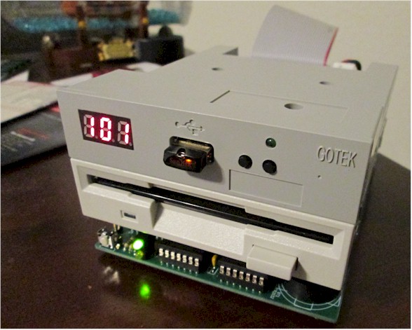

I recently got your fine Zeta V2 SBC built - I recompiled the GoTek FlashFloppy firmware to support 2:1 interleave for it:
/forum/index.php?t=getfile&id=1273&private=0

That looks nice, I need to get one of these floppy emulators.

They are pretty cheap on eBay, and you can reflash them with a USB to TTL serial adapter to the FlashFloppy firmware. If you want the 2:1 interleave firmware, I posted it at vcfed.org.

0x84-0x87 is a defacto standard place for the second SIO board on the RC2014 as well as your watchdog.

It is a valid concern. Thankfully the board uses an SPLD for the address decode and therefore the address can be easily changed.
Any recommendations for an I/O address for the watchdog (a block of 4 addresses, since it doesn't decode A0 and A1)?
Another thing, the SPLD can be actually programmed to pulse the WDOG signal (and reset the watchdog) when any of the SPLD inputs or their combination change. Perhaps an easy approach would be to pulse it for any I/O request?
Sergey

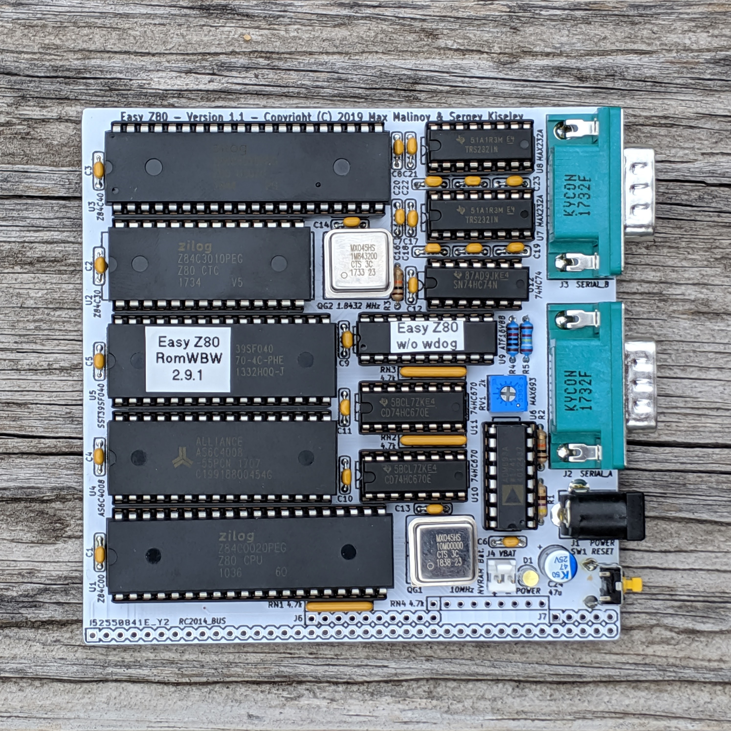

The support for Easy Z80 had been merged to RomWBW 2.9.1. When building the image select RC2014 platform, and then ezz80 configuration.
Note that CTC is wired a bit differently in Easy Z80 vs. Zeta SBC V2:
  • In Easy Z80, CTC channels 0 and 1 can be wired to SIO clock inputs (they are not connected by default - the default is to get 1.8432 MHz clock signal straight from the oscillator), and CTC channels 2 and 3 are chained together, and channel 3 can be used to generate periodic timer interrupt.
  • In Zeta SBC V2, CTC channels 0 and 1 are chained together, and are used to generate periodic timer interrupt, channels 2 and 3 are used as IM2 interrupt inputs from the UART and the PPI respectively,
[Updated on: Fri, 08 March 2019 16:02]

Yeah, these NVRAM supervisor ICs do not work properly with VBat floating. I've added a note in the README about that.
Meanwhile, I've received 10 version 1.1 PCBs, so I have some to sell [($5 + shipping) * 1.05 PayPal fees]. The changes are fairly minimal and outlined in the README Changes section.
