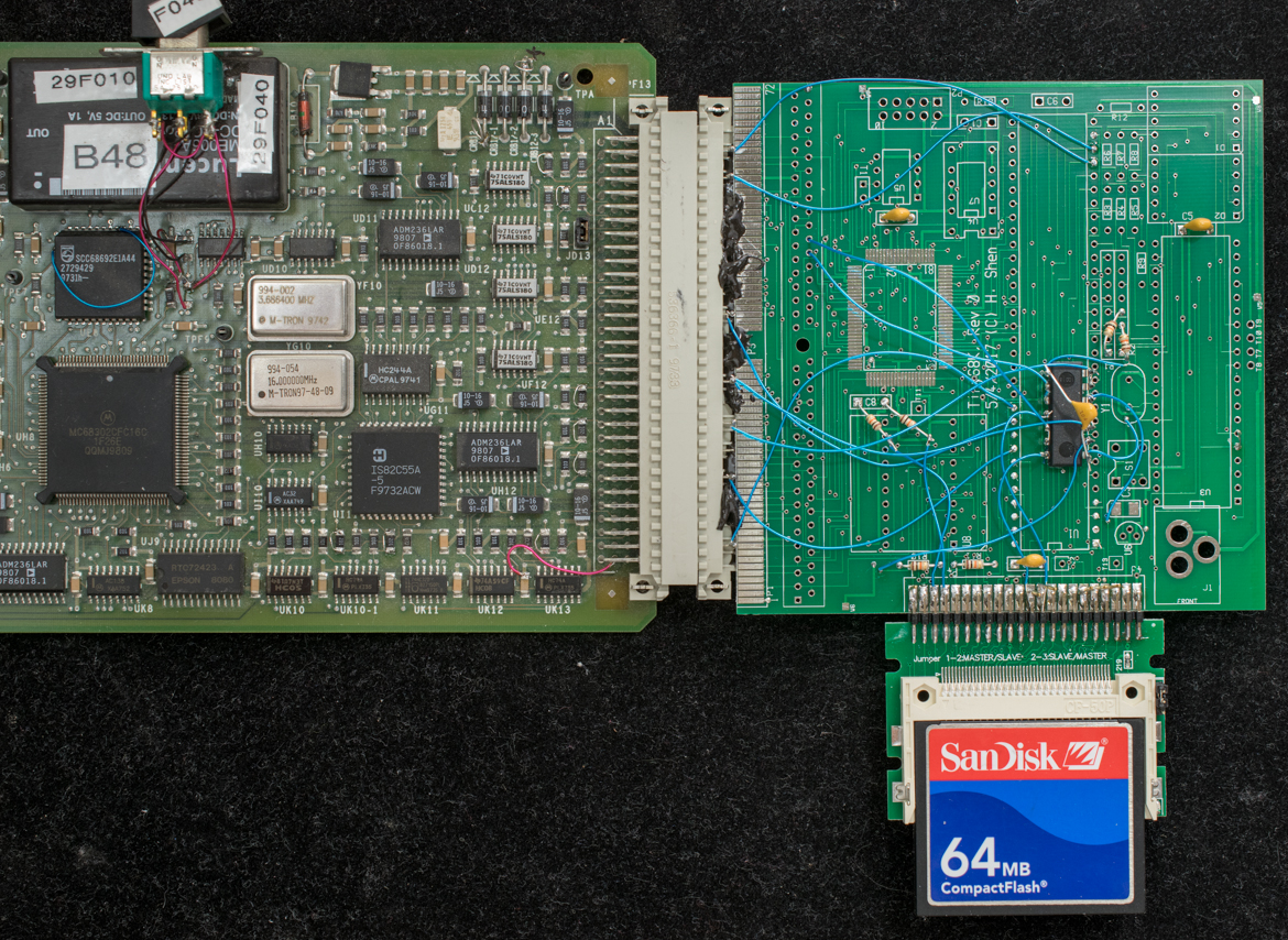

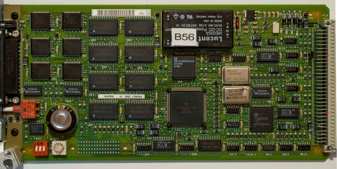

A decade ago I purchased a box of salvaged single board computers based on Motorola MC68302. They were made by ADC Communication as a controller for their Soneplex communication product line. I figured out most of the wirings, wrote a monitor and built a few home projects using these boards. With my recent experiences of CP/M 68K I realize the board also has enough memories and resources to run CP/M.
index.php?t=getfile&id=555&private=0
The board has 3 banks of flash memories. The first bank is 256K bytes and hold the monitor. The other two banks are 1 megabytes each. Collectively they formed a read-only disk to hold the CP/M 68K ver 1.3 distribution files. The RAM is 1 megabyte with the top 256K backed up with a super capacitor. The backed up RAM may serve as a small RAM disk. CP/M 68k resides in $15000 - $1FFFF and the Transient Program Area is from $20000 to BFFFF, or 640K--which "ought to be enough for anybody" Rolling Eyes
I copied the CP/M distribution files into flash and configured the BIOS for Flash disk and RAM disk and this is what I have:
index.php?t=getfile&id=556&private=0
The 256K RAM disk is obviously too small to be really useful. There is a 82C55 on board and all it's outputs are available on the 96-pin DIN 41612 connector. It should not be difficult to add a CompactFlash adapter for the DIN connector. Available on the DIN connector are also a number of discrete I/O, 4 serial ports and a SPI. The processor clock is 16MHz. This is a fairly capable 68000 single board computer. Periodically they are available on eBay for $15-$20 like this one: http://www.ebay.com/itm/122306457847
Disclaimer: I do not know the above seller and haven't bought anything from him. It appears to be the same board as mine, but I don't know whether it will work exactly like mine or not.

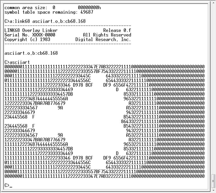

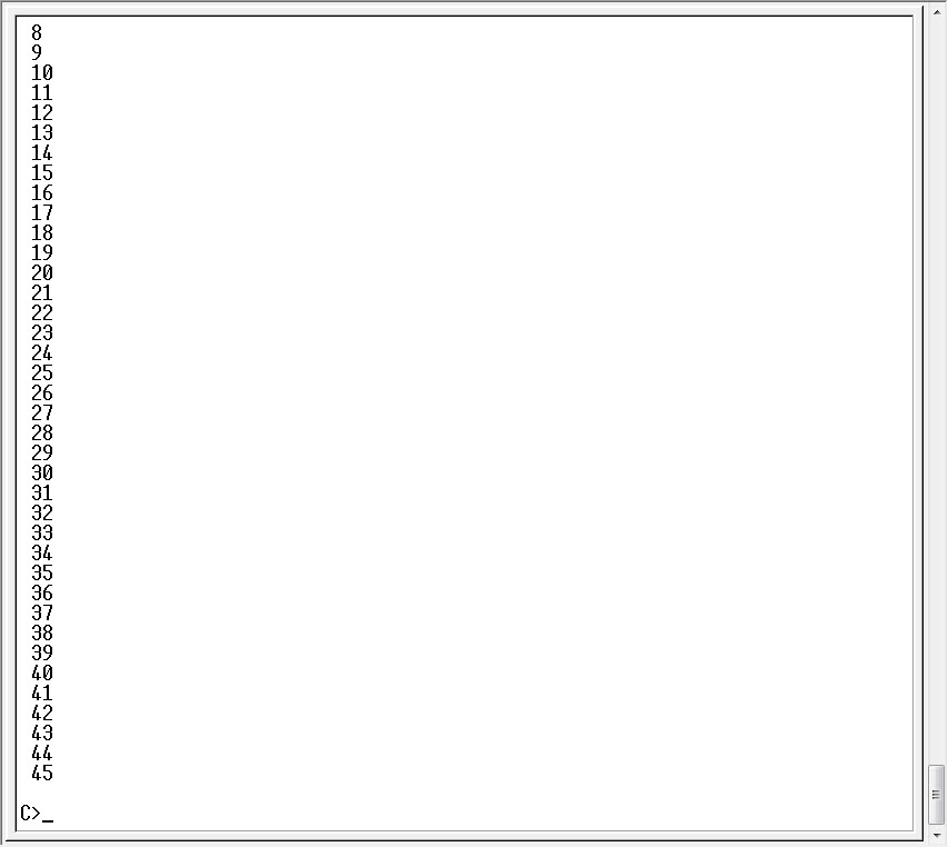

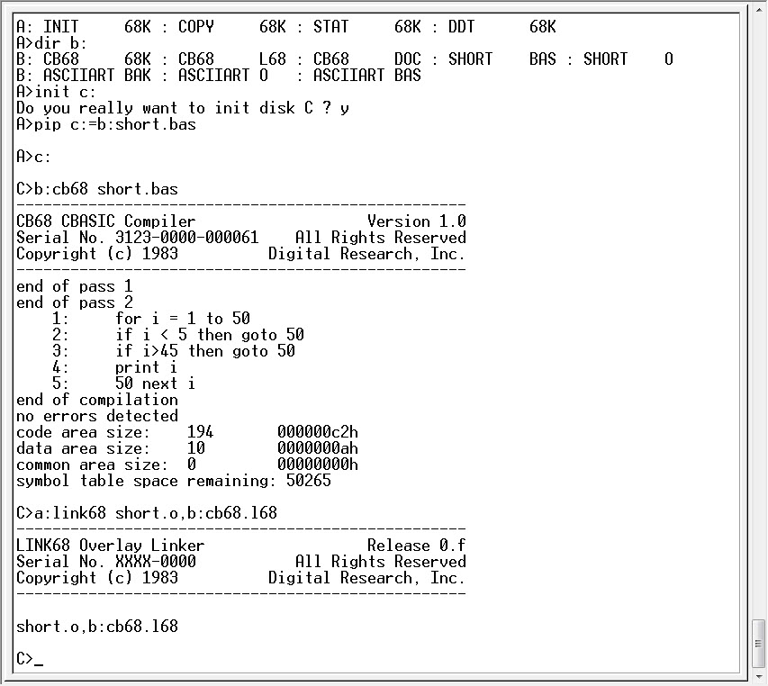

I used EASy68K simulator to convert cb68.rel to cb68.68k and created a second flash drives, drive B, that contains cb68.68k, cb68.l68, and cb68.doc. I only have 2 meg of flash on the ADC SPX-MPU board, so I'm trying to save space. So now drive A contains CP/M 68K distribution files, drive B contains the cb68 files, and drive C is the 256K RAM drive
The next 2 screen shots shows the content of drive B, compiling your short basic program with cb68, and link it, and then run it. ( you are correct that output of the link68 is a .68k executable)
I need to change the original ascii art code so statement 110 is now:
110 if (a*a+b*b)>4 then goto 200
With that change, I'm able to compile, link, and run it. See next 2 screen shots.
It takes 104 seconds to display the ascii art. This is compiled cb68 code running on 16MHz 68302, 16-bit wide data bus and zero wait state RAM. Compare that to 102 second on 8MHz 68000 running Lee Davison's EhBasic interpreter.

Here are the two screen shots of the short.bas compiling, linking & executing
index.php?t=getfile&id=559&private=0
index.php?t=getfile&id=560&private=0
Here are the two screen shots of the asciiart.bas compiling, linking & executing
index.php?t=getfile&id=561&private=0
index.php?t=getfile&id=562&private=0

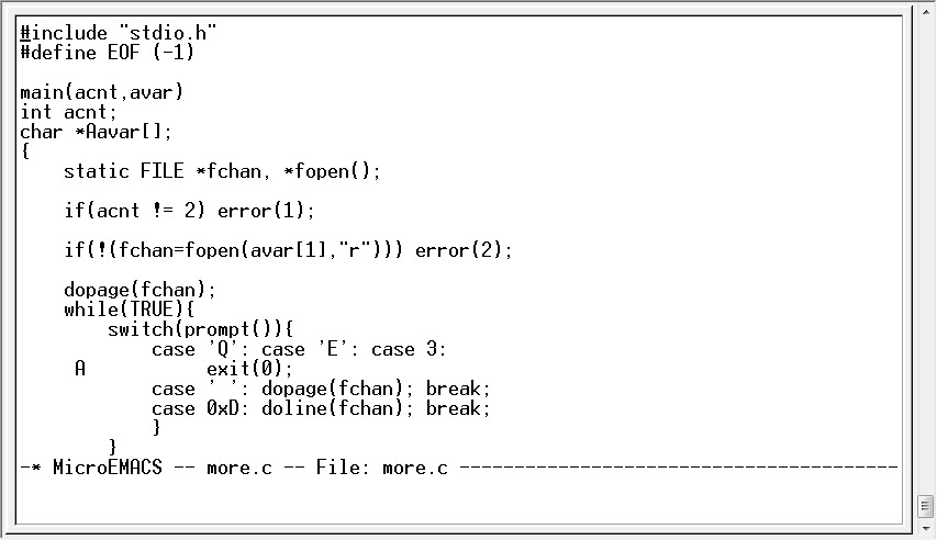

index.php?t=getfile&id=569&private=0
MicroEMACS running on repurposed spx-mpu. The C sources are downloaded from cpm.z80.de and compiled/linked use the CP/M68K C tool chain. There are no instruction on how to compile them. This is how I did it:
* Use the included C.SUB to compile all C programs (there are 17 C programs)
* use the included ASM.SUB to assemble the included BIOS.S
* use the included ARCHIV.SUB to form library, ME.LIB
* use the included MERLINK.SUB to generate ME.REL
* use RELOC.68K to convert ME.REL to ME.68K.
When moving cursor up or down with up arrow or down arrow, don't hold down the arrow key. At high repetition rate some of the arrow key strokes are read as character inputs instead of cursor manipulation command and corrupt the data file. Use CTL-V and ESC-V to move down/up pages.
Zipped ME.REL binary and ME.REL in S-record format are attached

I kludge up a IDE-CF interface board to the SPX-MPU board via the 96-pin DIN connector. The IDE-CF is driven by the 82C55 on the SPX-MPU board. The BIOS is updated with 4 more drives so drives A & B are read-only flash drives, drive C is RAM drive, drives D thru G are 8 megabyte each on IDE-CF:

index.php?t=getfile&id=587&private=0
On paper, IDE access via the 82C55 is quite slow; it takes four instructions for byte access and 5 instructions for word access; compare that to single instruction for byte or word access for bus-connected IDE interface. I did a quick benchmark of disk operation:
Pip 250K bytes of files from flash drive to RAM drive takes 3.5 seconds,
Pip 250K bytes of files from flash drive to IDE-CF takes 14.5 seconds,
Pip 250K bytes of files from IDE-CF to RAM drive takes 4.5 seconds.
