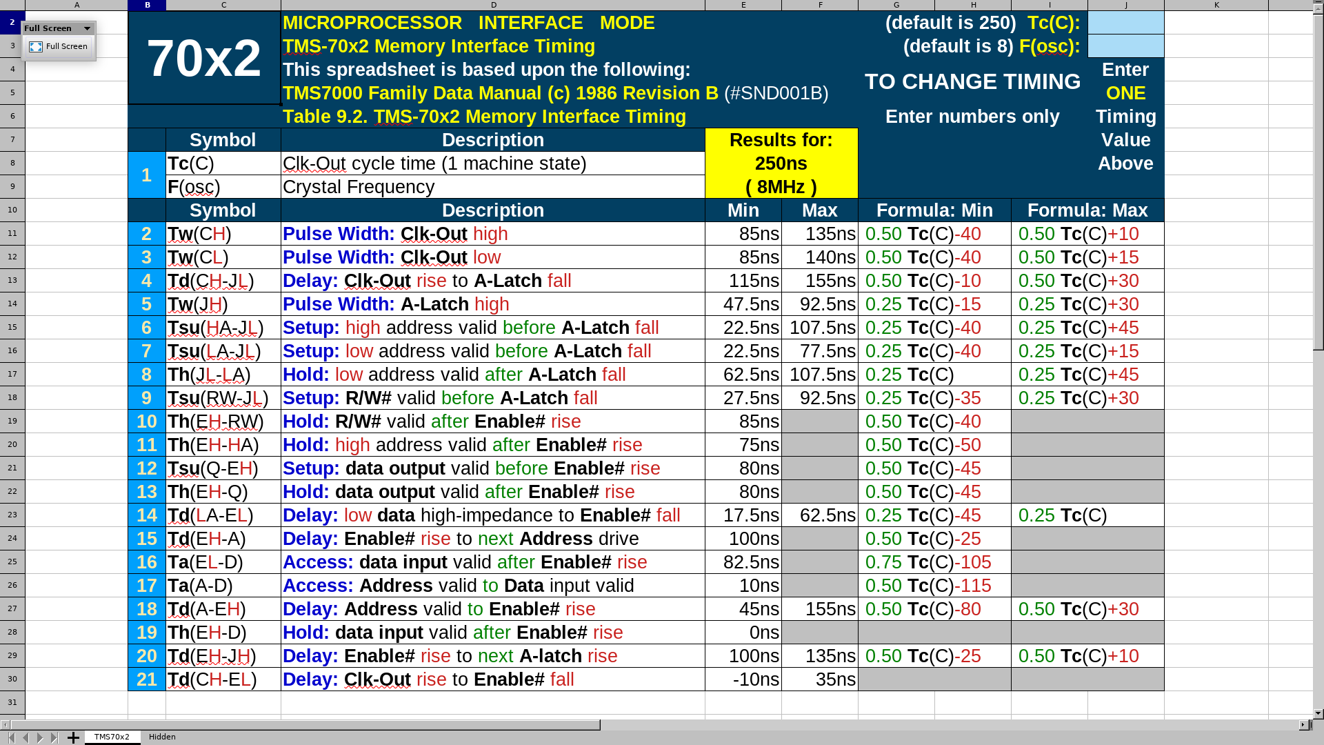

Re: ...to follow along on the timing discussion...
I understand what you're talking about... the databook documentation is a bit contorted in the area of various modes and resulting memory maps etc.
However I found a section of the '86 databook that puts that into good diagrams. If I can find sections for the x0,x1,x2 then I'll sort it out and post it as 70xx notes.
Spreadsheet for Micrprocessor Interface Mode - Memory Interface Timing:
Below, is a screen capture and I'll add some comments will appear below it on how it operates and some enhancements I'm considering.
The errors in the spreadsheet above will soon be corrected. Symbol #16 had an "EL" for Enable# LOW with a description "Enable# rise" that was corrented in the '89 Manual. Also in some of the lower formulas the multiplier is 1.5 x Tc(C) and not 0.5 x Tc(C).
This spreadsheet is based on a section about Microprocessor Interface Mode (external Memory), "Table 9-2. Memory Interface Timing" that appears on Page 9-5 in the 1986 TMS 7000 Series Databook.
For the 70x1 in Microprocessor Interface Mode -- Memory Interface Timing, Appendix C refers using the timing for the 70x0. That chart is not consistent with the 70x2 so I'll have to make a separate spreadsheet for the combined 70x0/70x1.
