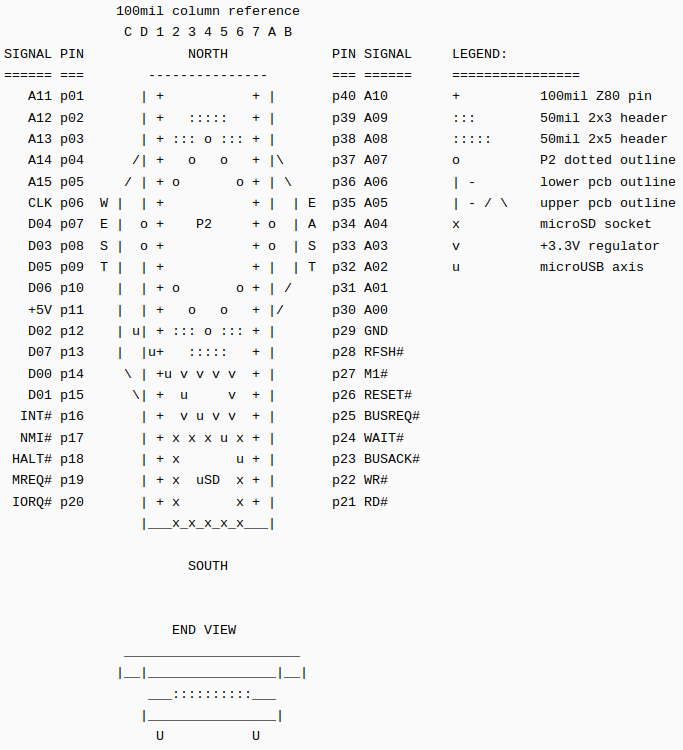

I switched the core from a Parallax P2, to a Raspberry Pi Pico or Pico W. The price was unbeatable and the pcb simplified the upper stack assembly.
The in-circuit replacement/enhancement is a two-part pcb stack assembly. The top-part consists of a Raspberry Pi Pico or Pico W joined to a 'hardware-resource' pcb that includes everything to hardware-emulate any of the targeted vintage CPU's pins, in-circuit... plus some useful components that boost the Pico's resources.
The bottom-part of the assembly is a single, mostly component-bare, circuit board. Its intended to be minimum cost, with just header pins that plug into a vintage system CPU socket and a connector to the hardware-resource pcb. This circuit board's task is only to connect its specific CPU socket pinout, to designated signals available from the hardware-resource connector.
Thus a single uCPU (top-part assembly) could be selectively paired, in turn, with the bottom-part assembly (CPU plug-in) for various CPUs per this example:
(1) I could pair the uCPU with a Z80 plug-in and replace the Z80 in my Xerox 820.
(2) I could later restore the Z80 and then pair the uCPU with a 8086 plug-in and replace the 8086 in my Xerox 820 16/8.
(3) I could later restore the 8086 and then pair the uCPU with a 64180 plug-in (64-pin at 70mil centers) and replace the 64180 in my Micromint SB-180 or my MSC LAT-1.
After thinking the project through, proving its feasibility, figuring out the best pcb stack structure/connectors, solving its voltage translations, designing the hardware-resource board to support a set of vintage CPUs, and then building a rats-nest-of-wiring development prototype to replace the Z80 in a Xerox 820-II... I had to change my hardware-resource pcb design due to long lead-time component availability quotes into 2024. :S

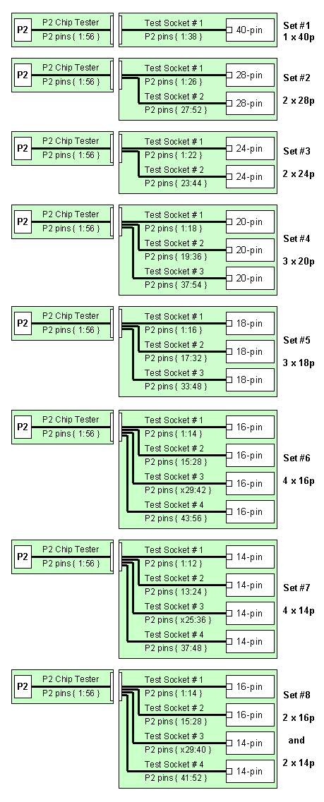

A PARALLAX P2 PROCESSOR COULD MAKE AN EXCEPTIONAL VINTAGE CHIP TESTER
The P2 processor can update all of its 64 I/O pins in one tick of a test program. Its speed would be capable of testing response-signal timing with precision. Each I/O pin can be configured as input, output or tri-stated and it has many I/O modes of operation for all or most pins. The P2 processor is powered at +3.3Vdc and doesn't directly interface to +5.0Vdc of the vintage 7400 series, but a simple resistive ladder can make a simple and safe interface for all TTL type chips.
WHAT ARE COGS?
The P2 has eight 32-bit cores which they call "COGS" and that terminology will be used herein. Each COG can access all 64 I/O pins and each COG can be instructed to run an internal program from its common memory section. This means that a P2-based chip-tester could be testing several chips, asynchronously, at the same time. The limit to how many test sockets can be running at the same time, is bounded by the 64 I/O pins of the P2, minus somewhere around 8 of those I/O pins that would be reserved for system use. That leaves 56 pins as a fair assumption for now, as the available number of P2 I/O pins that can be connected to a modular test socket board.
40-PIN TEST SOCKET
With 56 I/O pins available, a 40-pin socket like the Z80, would require (40-2) or 38 I/O pins to control and monitor all of the Z80's signals other than VCC and GND. The 40-pin test socket would have 38 P2 I/O signals hard-wired to it, perhaps P2 pins 01:38. It would have (56-38) or 18 pins left over when using a 40-pin test socket with two VCC/GND pins.
Four 16-PIN TEST SOCKETS
If the tester supported 16-pin chips, that would be (56 / (16-2) ) or four 16-pin test sockets. With four sockets, the P2-based chip-tester could allocate four COGS to individually test the four sockets independently and asynchronously.
COGS TESTING INDEPENDENTLY
COG #1 might use 14 I/O pins (P2 pins 01:14) hard-wired to socket #1 to test the chip placed in that socket.
Likewise, COG #2 might use 14 I/O pins (P2 pins 15:28) hard-wired to socket #2 to test the chip placed in that socket.
Completing the series, COG #3 would use P2 pins 29:42 hard-wired to socket #3 and COG #4 would use P2 pins 43:56 hard-wired to socket #4.
TEST FOUR SAME OR DIFFERENT CHIPS CONCURRENTLY
The interesting part about the COG example above is that each COG (a core processor among eight) could be running a different test on their hard-wired test socket. Three examples: (1) All tests could be started at the same time, with all chips being the same, though all tests being run on a different COG, or (2) Each test could be started asynchronously by pressing a button next to the socket, after a chip is loaded, creating a staggered-test running capability or (3) The user could test a different chip type in each socket with the associated COG-to-socket running the selected test for its socket. The Human-Machine-Interface (HMI) program in the P2 processor would be written to allow the user to make these configuration changes. The chip test library should be in a micro-SD card that the P2 can easily access.
CHIP TESTER FOR DIFFERENT USES
This gives the P2-based chip-tester more flexibility to operate in various ways that the user might need at different times. Example (1 and 2) above would be great for testing a bunch of DRams all at once; running the same test in all four sockets and the DRams all get tested in one-quarter of the time. Example (3) would allow the user to test a lot of different chips from a fully socketed board very methodically. Grab four 16-pin chips and put them in the test sockets, then assign the correct chip test to each socket via the HMI program, then start all tests. When the tests are all done, replace the chips that passed all the tests back into the fully socketed board, and then pull four other 16-pin chips for testing, reconfiguring the chip test for each socket via the HMI before starting all the tests together.
IS THE TESTED CHIP FAST ENOUGH FOR A DESIGN?
The P2 processor also can run very fast internally so it could measure response time of signals that it triggers. If a forty-plus year old chip has slowed down, the P2 can identify them by measuring the response times and listing them. If the HMI program allows the user to set a response-time threshold for passing the test, that would allow the user an easy answer to this question without pulling out additional measurement tools.
These would be nice features for chip-tester supporting vintage computer restoration work.
MODULAR TEST SOCKET EXAMPLES
The diagram below illustrates some examples of modular test socket boards that could connect to the P2 chip tester board and use its estimated 56 I/O pins to connect to its test sockets. Notice that no P2 I/O pin is shared with any other test socket pin.
Use the HMI program to select a test program compatible with chip(s) to be tested. A library of test programs should be stored on the micro-SD that the P2 uses. The test programs should be written so that they use a test socket module configurations file to adapt its I/O pins for running the tests. That would allow someone to make their own module, create a configuration file for it, and be able to get all existing test program to use it.
The best cost-modularity rule would be to put all components, resistive-ladders and buttons/LEDS on the chip tester board so they can be used with any test socket module. It would be more inexpensive if the various test socket modules had no components other than a connector and test sockets to minimum costs.
It would be wise to have the P2 chip tester board run the extra signals for LEDs and buttons to the connector so that a test socket module designer could add a set of LEDs and buttons next to each socket. Economy mode without LED+buttons next to the sockets but let the user add them, or sell them already installed.

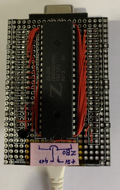

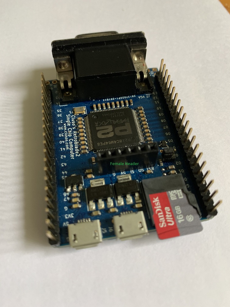

This is my P2 setup. I have been testing the Z80 zexall test instructions on a real Z84C0020 for validating my P2 Z80CPM Emulation.
The Z84C00 is on a protoboard and plugs into my P2 RetroBlade2 underneath.
A similar setup could be used to test other chips. I have a W65C02 waiting for similar treatment.
BTW P2 runs at 3V3 (and 1V8 for the cores). It is not 5V tolerant so you have to implement a compatible interface. I use a resistive divider.

Re: Project (1): P2 based Chip Tester [message #9657 is a reply to message #9656] Fri, 21 January 2022 20:01 Go to previous messageGo to next message
The CMOS Z80 actually works down to about 3.3V at 7.37MHz so your setup should work without resistor network. Similarly WDC's W65C02 works down to 3.3V as well. WDC datasheet shows W65C02 can run at 14 MHz at 3.3V, but it is pretty well know it can run 20MHz at 3.3V

Re: P2 based Chip Tester [message #9658 is a reply to message #9657] Sat, 22 January 2022 20:32 Go to previous messageGo to next message
cluso99 is currently offline  cluso99
Messages: 40
Registered: June 2017
Thanks Bill.
Since the specs didn't allow for anything below 4.5V I wasn't game to try it out because I was using this to test the Z80 instructions (modified zexall tests) for comparison with my P2 Z80 emulator.
BTW I pass all the tests Smile

I am just using the documented flags ie I mask with $D7. However my code can inspect the undocumented ones and then test for them.
The only active part of my Z84C00 setup is a PN2222A transistor for the reset circuit. I didn't try a direct setup. The transistor setup biases the transistor to hold the Z84C00 in reset when not being driven by the P2.
I've looked at making a pcb for both the Z84C00 and the W65C02 to plug into my P2 RetroBlade2.
The RetroBlade2 can drive a VGA (or LCD) screen and USB Keyboard (and mouse) as well as serial or USB to PC, and of course the uSD card. I wrote the boot code for the SD that is in the P2 ROM so we don't even need the Flash chip for the P2.
Project (2): In-Circuit Z80 Emulator [message #9687 is a reply to message #9673] Thu, 27 January 2022 14:42 Go to previous messageGo to next message
jayindallas is currently offline  jayindallas
Messages: 110
Registered: June 2021
STUDY OF THE Z80 BUS CYCLES AND DMA
This message * originally * proposed hooking up a Z80 to a Parallax P2 to capture bus cycle characteristics, something that Cluso99 has already done for one of his projects. I too have an interest in doing that for getting bus cycle information on some useful "undocumented Z80 instructions" and to better understand how the Z80 micro-code fetches and executes instructions.
This led to my second project in this series, a in-circuit Z80 emulator based on a Parallax P2 processor. That design is introduced several messages later (down the page).
It turned out that I didn't need to hook up any circuitry to get the information I needed on Z80 bus cycles, the following documentation and an analysis of the Z80 instruction's T-state timing revealed most everything necessary in regard to the in-circuit Z80 emulator design and firmware. The result of that is tabulated in a later message discussing the removal of "idle T-states" in regard to the vintage system bus. That said, I still will hook up a Z80 to the Parallax P2 to document the bus cycles completely, included the mentioned "undoc" Z80 instructions. I'm going to add a few snap-off printed circuit boards so I can fully document the bus cycles and T-states for several vintage processors.
For my initial bus cycle analysis, I just need to account for all the T-states and the number of bus cycles. However, there is some ambiguity to which idle T-states are assigned to which bus cycles. This isn't important to the in-circuit emulation of a Z80, but it does reveal interesting information about the built-in instruction micro-code executing the instructions in the Z80. I found a few instructions where the inaccessible micro-code could be executing the instruction various ways, not that the in-circuit Z80 emulator needs this information, it would be information useful when searching for 'undoc' instructions. The complete mapping of all instruction bus cycles and T-states would add clarity.

I thought about using the P2 for a chip tester and posted an outline for anyone that might want to do something like that. My need for a chip-tester diminished when I bought a Parallax "P2 Edge Module Breadboard". I can do a quick chip test anytime I want to on that P2 with Breadboard. As I write more chips tests, I'll be better prepared to do a chip-tester based on the P2 later on.
/forum/index.php?t=getfile&id=2722&private=0
Right now I'm working on the spin-off design, an in-circuit Z80 emulator. It has turned out to be a lot more interesting and developing a prototype would allow me to efficiently test it while restoring my vintage computer systems. If I design and program it right, I won't have to drag out a lot of test equipment and hook it all up. I'd rather ask the in-circuit Z80 emulator to just tell me what the problems are. :)

My P2 RetroBlade2 already has...
1. USB to PC via generic USB CP2102 or my CH340 plugin modules.
2. MicroSD socket and software supporting FAT32
3. 2x microUSB sockets and soft USB to support USB Keyboards and mouse via generic microUSB to USB socket short cable
4. VGA connector supporting up to 1920x1068 color (only limited by P2 internal memory or use external add on memory)
5. Supports LCD 480x320 (80x40 lines text supported by software) SPI module
6. Unused pins used to connect to real Z80 on protoboard or use internal P2 Z80 emulation.
Some of the above are separate software and needs integration to work together.
My RetroBlade2 runs Z80 emulation running CPM2.2 using 8*8 CPM HDDs on the microSD as FAT32 files with support to transfer files between CPM and FAT32.
It would not be difficult to substitute the Z80 emulation for using the real Z80 daughterboard. This could easily be made to then plug into a Z80 socket on a retro Z80 board or system.

lynchaj wrote:
"Do you have a schematic for the P2 chip tester? Do you want help making a PCB?"
Thanks, but I'm not focused on the tester at the moment. When I do one pcb in low count volume, I combine several projects on the same pcb in snap-off sections. All projects done for the price of one pcb at the total pin cost. Big savings, less headaches.
UPDATE: 2022/02/11
A SCHEMATIC FOR THE P2 CHIP TESTER:
The chip tester is a reasonably simple design so I'll try to post a description in the next few days.
I'll use the design that:
(1) uses an P2 Edge card, that plugs into a connector so the card can be used for other projects too.
(2) the 'SETS' of tester modules will be the plug-in type, instead of the board-board approach.
(2+) that minimizes the test operator errors that could occur when chips are inserted to the wrong socket.
ADDITIONAL TASKS:
(3) I'll try to make time to do at least one ascii diagram/schematic so the basics are clear.
(3+) with that, any other other 'SETS' can be guided by the diagram/schematic.
(4) I'll post an image or a url link to the P2 Edge card with the posting.

So... right now I'm pondering a 40pin DIP Z80 replacement pcb assembly that can be controlled over USB from a Raspberry Pi 4 running a Linux C++ application to EITHER (1) communicate with a Z80-emulating-P2 (something Cluso99 has pioneered) OR (2) as a P2 in a socket-P2-Z80 layer sandwich that cuts in via BUSREQ# to do what the RPi4 operator wants to do (test/take-over FDC chips etc).
I thought about (2) last night during a movie and was going to use 50mil headers to bridge two sandwiched boards, inlaying the headers inside the DIP holes at each end of the DIP, 3 rows of 7 =21 at each end of the 40pin DIP 42 total giving two +5V and two GND pass throughs. That left the center rectangle area for smt components and SD socket and micro USB connector.
However the assembly would be hard to assemble and when I looked at the Parallax page this morning, I saw a 40pin DIP board (P1 I think) and that looked like it was a lot easier, so... it looks like the better choice is... (1) make the P2 emulate the Z80 also. More P2 programming, but I have a great data-structure driven Z80 emulator written in Linux G++, which is C++, that would be perfect for the P2 lookup table LUT-RAM. And once the emulation works, there is no need to do BUSREQ# as the USB link could control the EMU-Z80 under P2 programming.
When I get that EMU-Z80 in a DIP dual PCB sandwich board layout, I can THEN add some TTL DIP tester circuits and a P2-EDGE connector to keep the P2 cost down on the test circuits. In other words, you can have on P2-Edge card and plug it into your tester board when you want to run it, and when not, unplug the P2 Edge card and use it elsewhere.

The LOWER PCB:
The lower pcb is rectangular, approximating a 40pin DIP profile. It forms a 40pin DIP base that can be inserted into a Z80 socket. The outline keeps the pins visible for positioning them into the Z80 socket.
The main purpose of the lower pcb is to geometrically translate the 40-pin Z80 signals into SMT buffers/transceivers that translate the P2's 3.3V signals into 5V-safe vintage TTL with fan-out driving capacity, and route the P2 side of those chips, to the upper pcb. As the P2 requires as slightly wider pcb, the traces route to four areas of the pcb where they connect to headers going to the upper pcb. Those four areas are referred to as the North-West, South-West, South-East and North-East. At the North end, between the DIP rows, 50mil headers totaling 22 pins are used to connect the signals to the upper pcb. The South end is a reflection of this.
To tighten up the layout on the upper pcb, the P2 (diagonally oriented) and the two sets of end header-matrices have to shifted North. This give more contiguous space on the South end of the lower and upper pcbs. The diagram below doesn't show it but there will likely be additional headers under the P2 pad on the upper pcb, to allow thermal flow away from the P2.
In the diagram below these symbols are relevant to the lower pcb:
"+" marks the Z80 pin positions into which that the assembly inserts.
":" marks the 50mil 2x3 and 2x5 headers which connect signals to the upper PCB.
The UPPER PCB:
NOTE that there are no 40pin DIP obstacles on the upper PCB. The diagram's "+" mark the Z80 pins on the lower pcb only. The "o" mark the edges of the P2 on the upper pcb, top surface.
The upper PCB looks like an aircraft carrier and it has flanges out about 250mils to fit the P2 at a diagonal. The WEST flange would normally be symmetric with the EAST flange, but its extended SOUTH to give more room for the axis of the microUSB connector and cable. This may change. The diagonally oriented P2 supports the Z80 signals as they were quartered on the lower pcb.
"u" marks the axis of the microUSB connector and cable. This angles gives the cable more room.
Other components on the upper pcb can be identified in the diagram's LEGEND.
/forum/index.php?t=getfile&id=2723&private=0Below is a pcb stack diagram showing how it might fit together.
[Updated on: Sat, 23 April 2022 11:08]

Cluso99 wrote:
"...Just so you are aware, you will not fit a P2 in a 0.6" wide pcb because the P2 itself is almost 0.6" wide. You will also need to allow for heat dissipation too as the P2 can get quite hot if there is a lack of copper..."
Yeah, it needs to be a two pcb stack for the two reasons you make:
(1) The P2 will not fit between 100mil pin rows, 700mils apart.
(2) The thermal pad layout for the P2 transfer heat to the opposite surface.
The solution to (1) above is to place the P2 on an upper pcb of the air-gapped stack, where the lower pcb geometrically transfers the Z80 40pin locations to two header-matrices at its North and South ends, so that the upper pcb has its full West-East width for component placement, the P2 in particular.
The solution to (2) requires an upper pcb too for thermal reasons. As the in-circuit Z80 emulator is intended to be placed in vintage system enclosures, that environment is likely to be thermal challenged. So a GIVEN must be to maximize thermal protection in the stack assembly. On the upper pcb alone, that would require the recommended thermal pads with vias to the opposite surface with a pcb thick enough to do that well. An additional advantage of the two pcb stack is that the lower pcb, which is sparse, can be used as an additional thermal radiator, using connecting headers across the stack's air-gap to allow heat to expand into the lower pcb unused copper mass.
In addition to (2), it would be wise to cap the P2 with a moderate heatsink. I thought about putting a heatsink on the heat pad on the opposite side of the P2, but I'm leaning toward the use of headers to do that and involving the lower pcb. That allows the air-gap between the pcbs to be smaller.
The last thing that might help reduce thermal issues would be to adjust the clock speed and cog use when performance doesn't require it. I'm not sure the P2 has power reduction measures; I assume it does, for now.

CPU SET IN-CIRCUIT-EMULATION SYSTEM:::
CONCEPT:
The 40-pin Dual-Inline-Package (DIP) profile is a three pcb stack:
    (1) A commercial Pico/Pico W         |    The magic software is in (1),
    (2) The Resource/Feature pcb         |       the magic hardware is in (2) and
    (3) The CPU Adapter socket pcb       |          the no-magic signal conversion to CPU pinout is in (3).
For a CPU in-circuit-emulator, you'd have the standard multi-CPU capable (1)(2) assembly...
(1) would have the software loaded for a particular vintage CPU.
(2) has the hardware that can be manipulated by (1) to emulate the signals and voltages of a set of vintage CPUs.
(3) is unique for one type of CPU. It routes signals from (2) into the CPU pinout pattern for the vintage CPU socket.
If you had a Z80(1)(2)(3) assembly and wanted to in-circuit-emulate a 6502,
A). you'd load the 6502 software into (1),
B). then unplug the Z80(3) and plug in a 6502(3)
None of these assemblies and software exist but this is the design concept I'm pursuing.
This keeps the cost of the hardware down to a minimum and maintains CPU flexibility if done well.
