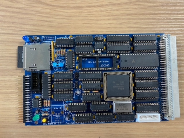

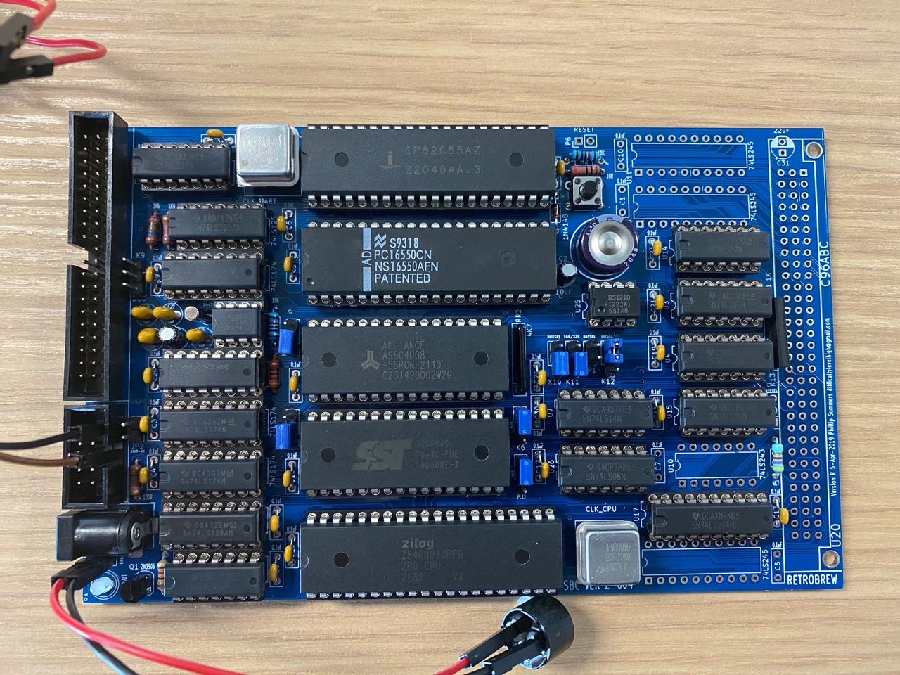

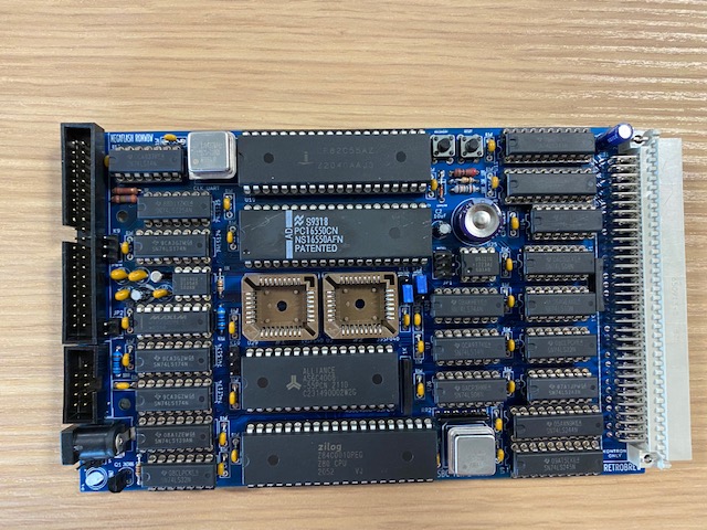

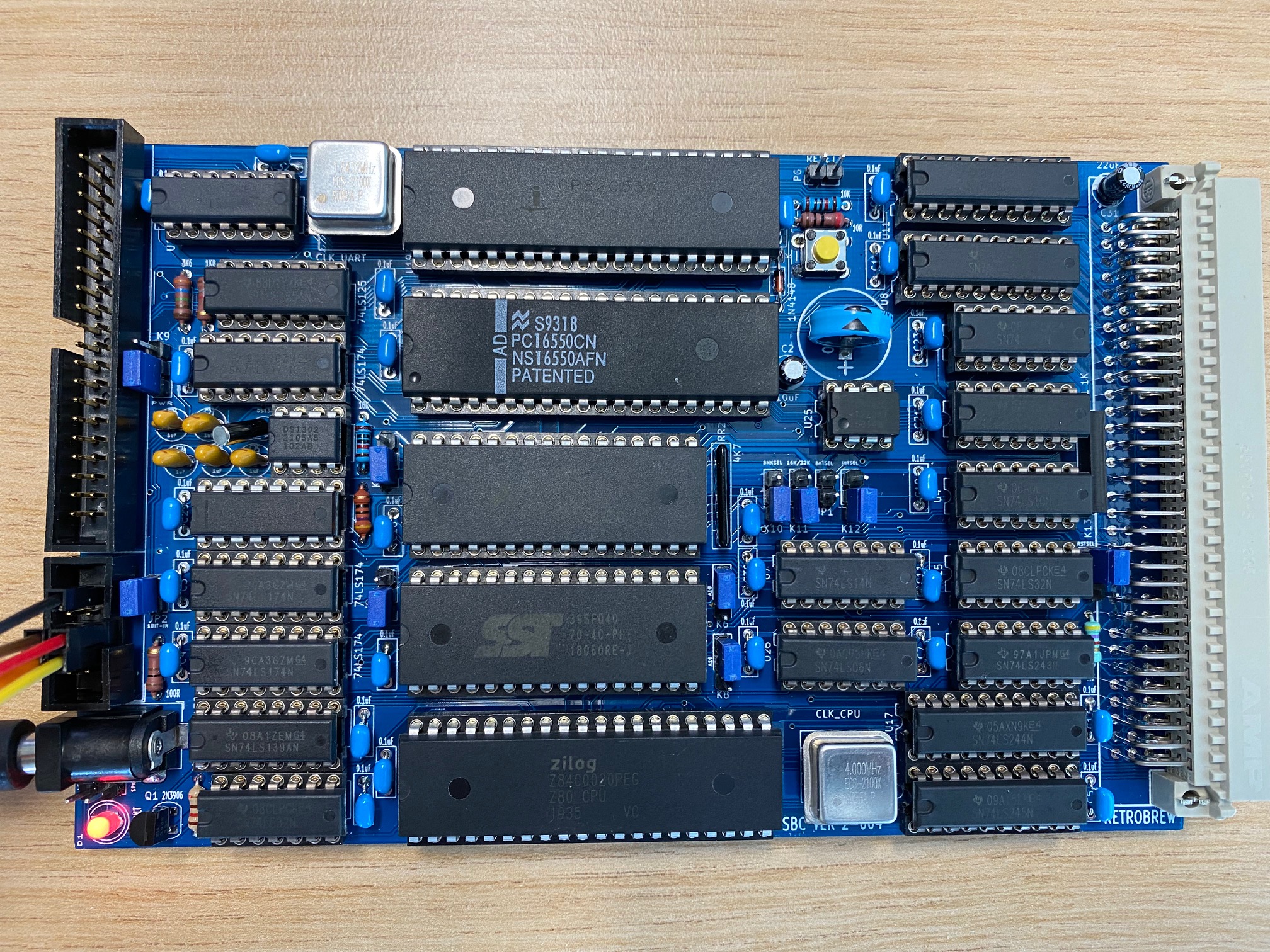

Hello All,
I finished my SBC V2-004 PCB. For some reason I don't get a boot message on the terminal.
I'm wondering if I have wired the serial connector right.
In the documentation the following wiring is advised (IDC 10 to DE-9 (female):
2 -> 4
3 -> 3
5 -> 7
7 -> 6
9 -> 5
Looking at the schematic pin 2 of IDC 10 is not connected. So the above doesn't make sense (to me). Or I'm I wrong?
Right now I have wired the serial cable as follow:
3 RXA -> 2
4 RTSA -> 7
5 TXA -> 3
6 CTSA -> 8
9 GND -> 5
The 9 pin connector is a male.
Because I don't get any characters in my terminal I presume that the above is also not correct.
Can someone point me in the right direction? Or is something else wrong (jumpers?Wink or defect?

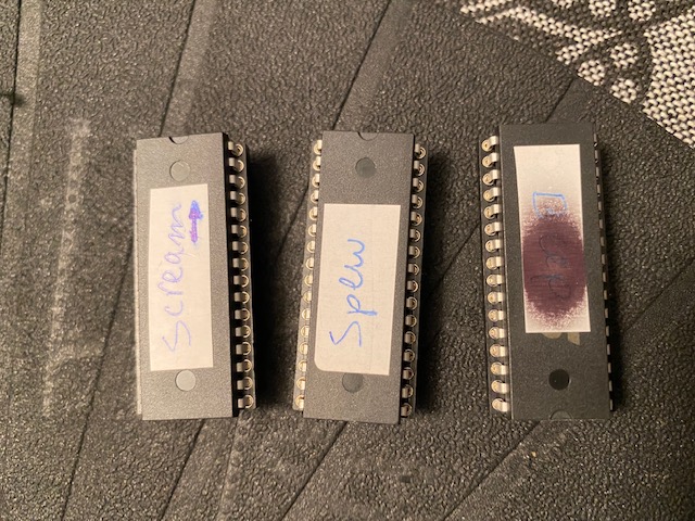

I programmed the SST39SF040 with ROMWBW version 3.01
Thanks for your trouble and time!
Kind regards,
Edzard
  • Attachment: 1.jpg
    (Size: 1.23MB, Downloaded 313 times)
  • Attachment: 2.jpg
    (Size: 144.50KB, Downloaded 269 times)
  • Attachment: 3.jpg
    (Size: 81.59KB, Downloaded 284 times)
Re: Debugging a SBC V2-004 [message #8819 is a reply to message #8817] Fri, 09 July 2021 08:56 Go to previous messageGo to next message
Oy, serial ports always causing problems!
skip the pin numbers for a minute, you need this connection whatever the pin numbers are:
RX -> TX
TX -> RX
RTS -> CTS
CTS -> RTS
GND -> GND
Do you have a logic probe or oscilloscope? put it on the TTL TX line coming out of the UART and press reset. You should see activity on that line as the characters stream out for the initialization screen. You really only need TX -> RX and GND -> GND working initially on your serial port. Try getting those connected properly first. 2 line serial is great for debugging. You can add the other signals later.
Also, have you checked VCC, GND, clock, reset and all the other basic connections? Normally before I insert any ICs I go through and make sure the basics are present and accounted for to ensure a good chance of working. Check the jumpers against the schematic to ensure they are doing what you intend for them to do.
I thought I read somewhere you should be hearing a start up beep on the SBC V2-004. Did you burn the right version of ROMWBW to your Flash chip? Are the jumpers configured correctly for that particular Flash chip?
Good luck! Andrew Lynch
BTW, nice looking board! Congratulations for getting this far. You are very close now

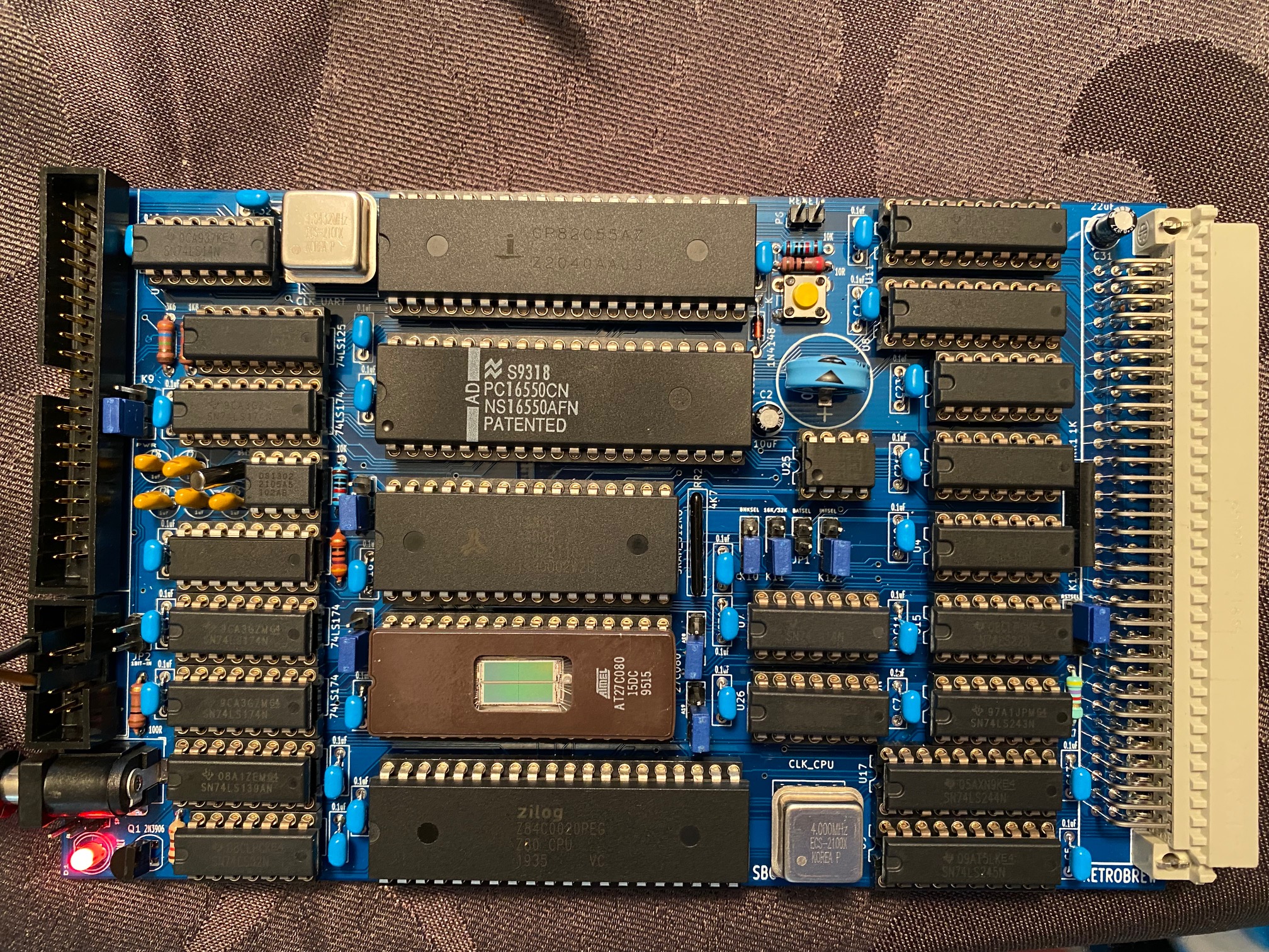

I've checked al the IC's for the right voltage. Everyone gets 5 Volts.
The Oscillators are working at 4 Mhz and 1.84 Mhz (confirmed by the oscilloscope.
The little one (X1) gives half of the frequency (according to the oscilloscope) but I'm pretty sure that the value is correct.
I noticed the following:
- Al IC's close tot the bus (74LS244/245/243/32/08 etc are getting warm
- Other IC's (ROM/RAM/CPU etc) are cold
- LED stays red all the time
I changed the ROM to a AT27C080 to be consistent with the design.
I programmed the ROM with ROMWBW version v2.9.1 (not the newest to be sure that this is not the problem).
I used the (standard) file SBC_std.rom which comes with the distribution.
Checking pin 7 (TX) of the MAX323 gives no signal ( I see some spikes but no data blocks) when resetting the system). But maybe I'm doing something wrong with my Rigol.
I connected the serial port with only 2 wires (5 -> 2 and 9 -> 5).
I found in the Errata the following message:
Version V - CPU oscillator may not work due to incorrectly placed pull up resistor. A 1k resistor needs to be added between pin 12 and pin 14 of U26 74LS06.
So I placed this resistor on the back of the PCB. Not sure if this is (really) necessary.
Jumpers are as follows
K1=1/2
K6=1/2
K7=1/2
K8=1/2
K9=1/2
K10=1/2
K11=1/2
K12=1/2
K13=2/3
What's strange is that I have no output at all on the screen.

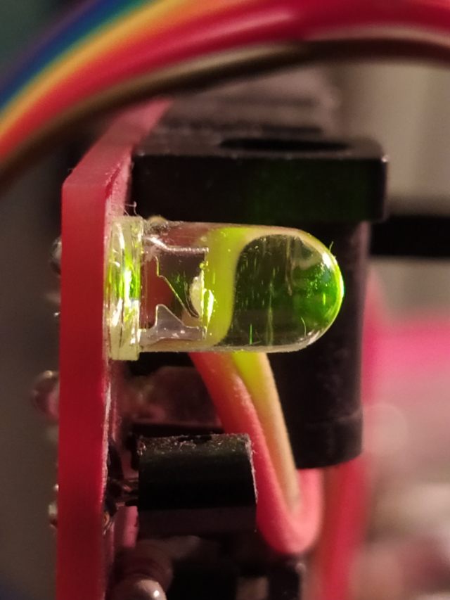

Do you have a bicolour led installed?
Is it around the wrong way? Try grounding /halt (pin 18 z80)- it should change colour.
Image to verify orientation.
/forum/index.php?t=getfile&id=2241&private=0
Regards Phil

I will try to remove al unnecessary components tonight.
The LED changes colour when halting the CPU.

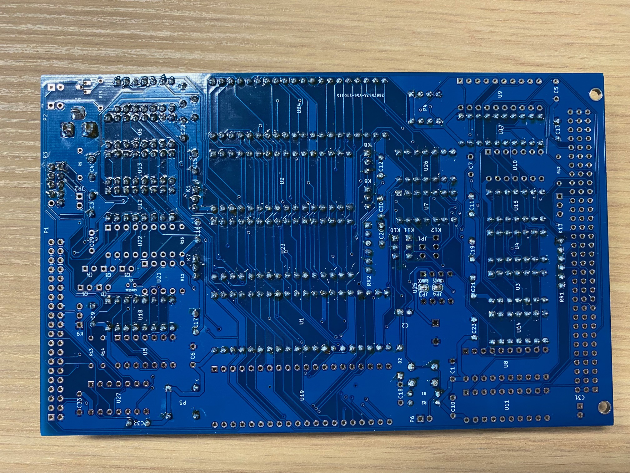

One key indicator your SBC is functioning is whether you see activity on the ROM chip select pin. After pressing reset you should be seeing regular activity on that pin. Also the CPU RD# pin should be active. If you are seeing those pins working, it is just a matter of finding where the problem is occurring because the CPU is booting from the ROM. Of secondary importance is whether the chip select pin on the UART is active. It is a good sign if it is active.
One thing to try is going over the solder side of the PCB with your soldering iron and remelting all the joints. Inspect thoroughly for missed joints and any cold joints. Remelting will help with the inspection process and fix any of the suspicious solder joints that may have escaped notice earlier. Also use a tooth pick or pointed plastic tool to chip away any excess solder flux to inspect the solder joints closely. It is easy to miss clues when they are covered in the gunky flux

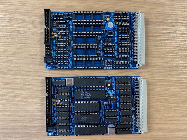

Hello All,
I've build a new minium SBC V2-004(r) board.
Checked all voltages on the IC's sockets for 5V and then populated them.

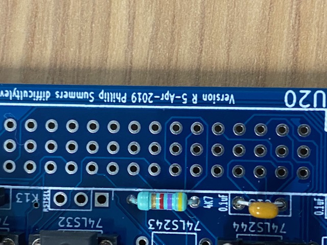

Hi Edzard, I think one of the middle solder joints on RR2 looks suspicious.
Also when you run jploop you don't need the UART, SRAM, or UART clock so I would pull those out first.
All jploop needs is CPU and ROM and chip select logic. You may need jumpers though depending on which ROM you selected
Good luck! Thanks, Andrew Lynch

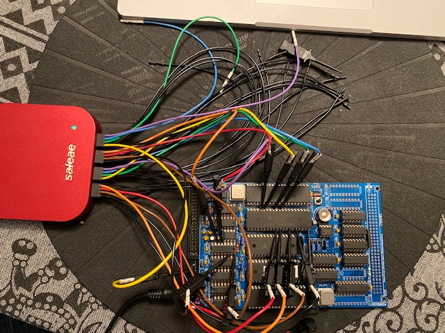

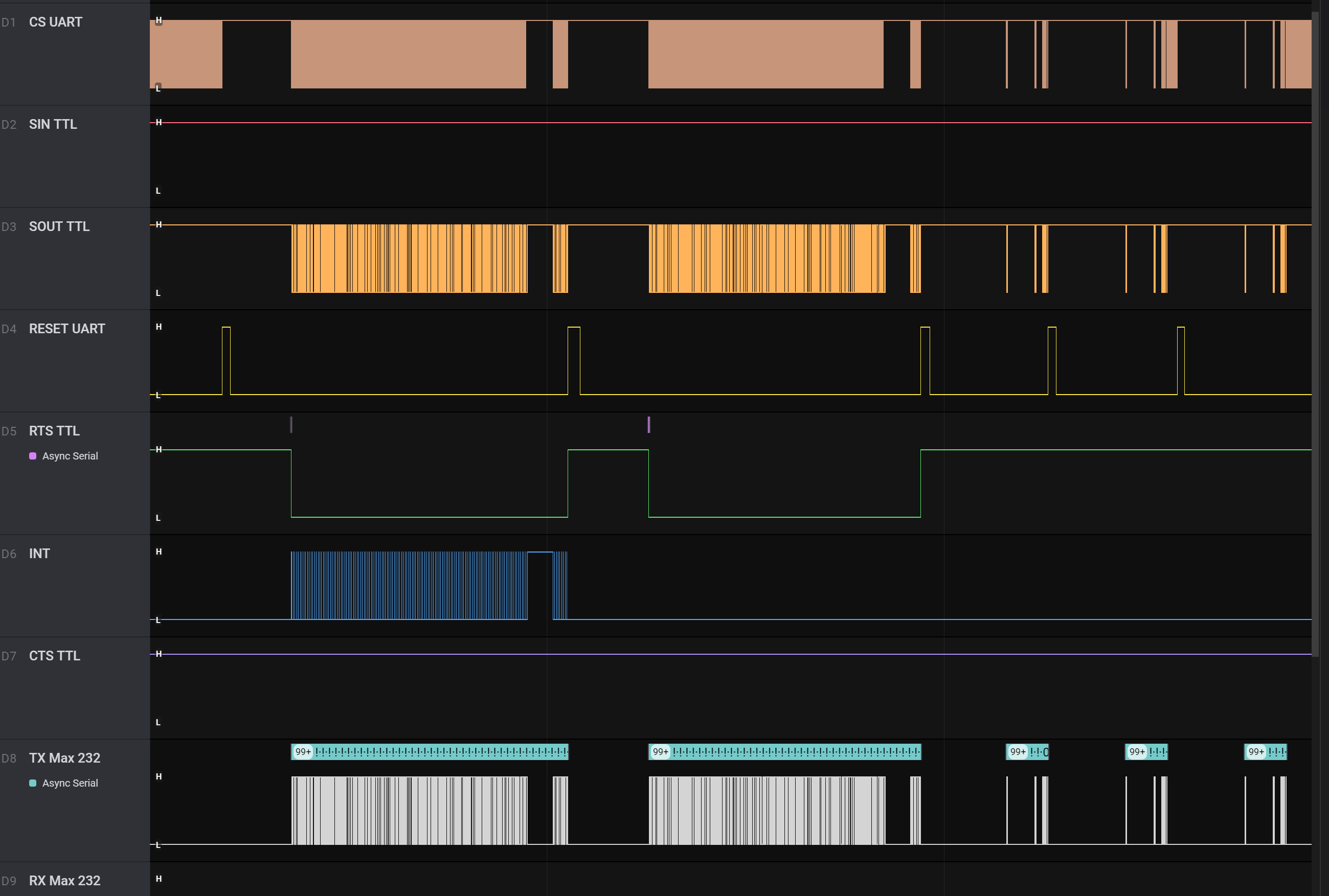

Re: Debugging a SBC V2-004 [message #8850 is a reply to message #8817] Wed, 14 July 2021 07:58 Go to previous messageGo to next message
edzard is currently offline  edzard
Messages: 64
Registered: August 2019
Hello All,

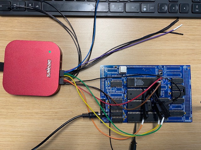

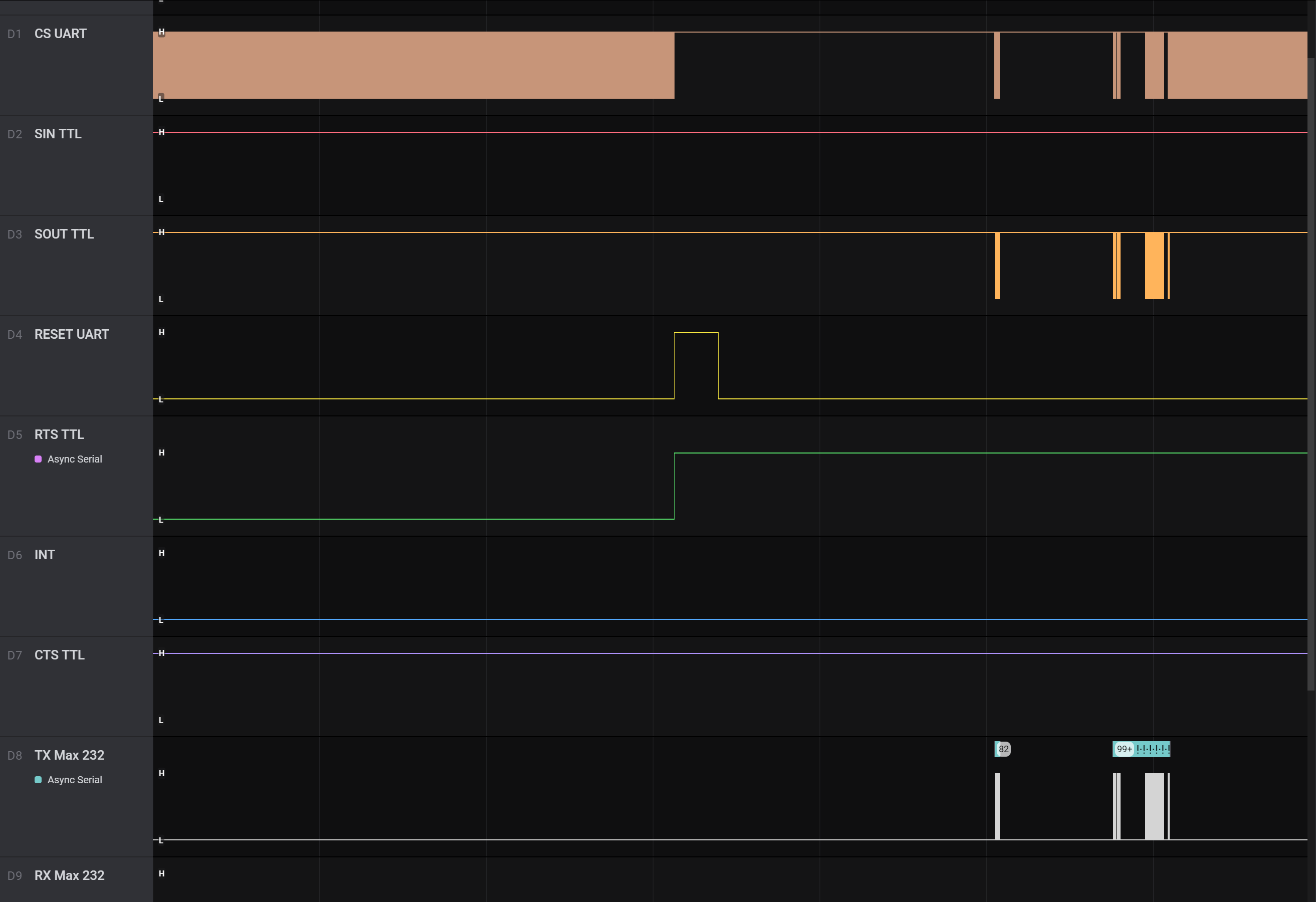

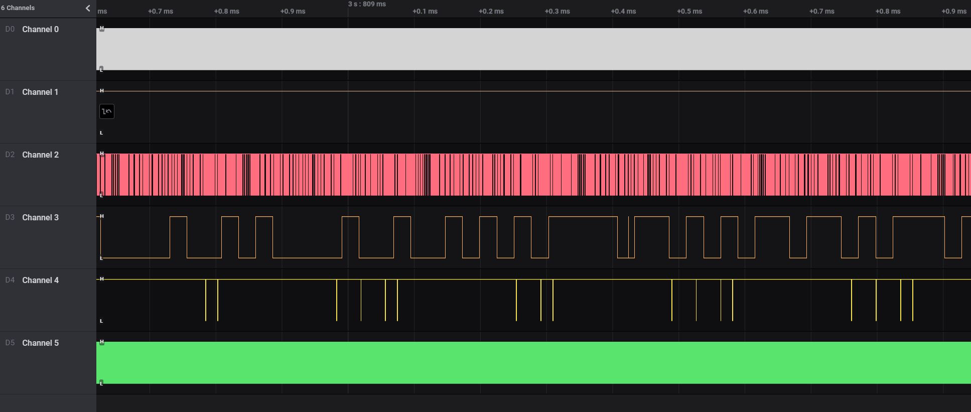

Here are the results of the minimum SBC V2-004 board with ROMWBW 3.01
/forum/index.php?t=getfile&id=2250&private=0
Channels are as follow
0 -> CLK CPU (Pin 6)
1 -> CS_ROM (22)
2 -> RD CPU (21)
3 -> SOUT-TTL (11)
4 -> CS_UART (14)
5 -> CLK_UART (16)
Output is
/forum/index.php?t=getfile&id=2251&private=0
The above is zoomed in so you can see what's going on with the UART output.
Zoomed out has this output
/forum/index.php?t=getfile&id=2252&private=0
Best regards,
Edzard
  • Attachment: Logic.jpg
    (Size: 137.36KB, Downloaded 1152 times)
  • Attachment: Capture1.JPG
    (Size: 133.20KB, Downloaded 1158 times)
  • Attachment: Capture2.JPG
    (Size: 181.22KB, Downloaded 1155 times)
Re: Debugging a SBC V2-004 [message #8851 is a reply to message #8850] Wed, 14 July 2021 10:05 Go to previous messageGo to next message
Well this tells us something. Looks like your CPU is reading the ROM and it is in a tight polling loop. So that's good news. I am thinking your MAX232 is suspect or your serial cable.
What's coming out of the MAX232? Are the charge capacitors installed correctly?
Thanks and good luck, Andrew Lynch

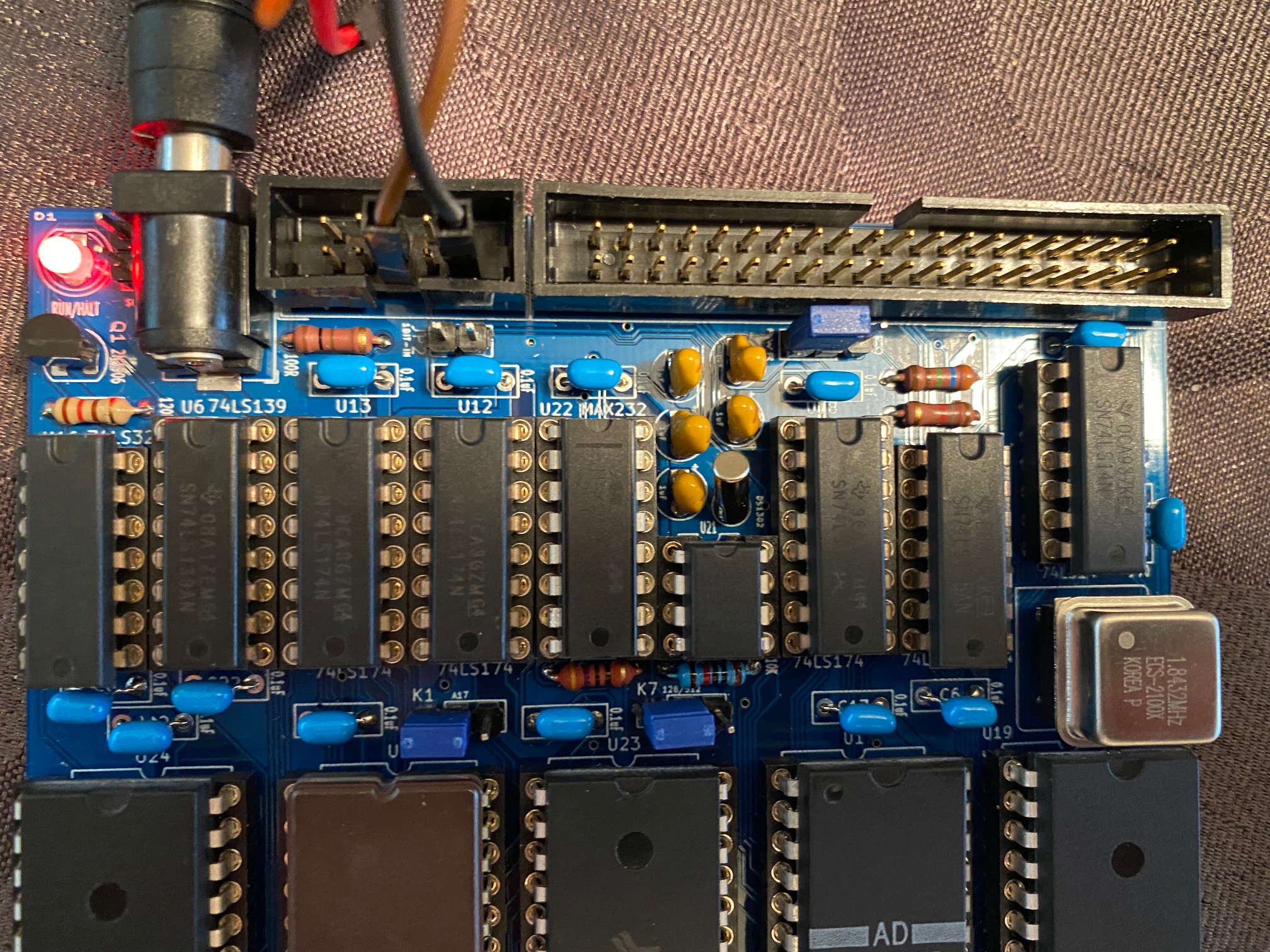

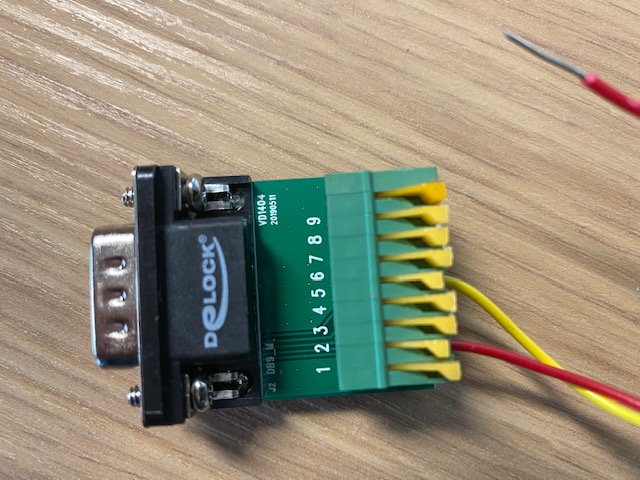

Re: Debugging a SBC V2-004 [message #8856 is a reply to message #8817] Fri, 16 July 2021 08:59 Go to previous messageGo to next message
Messages: 64
Hello All,

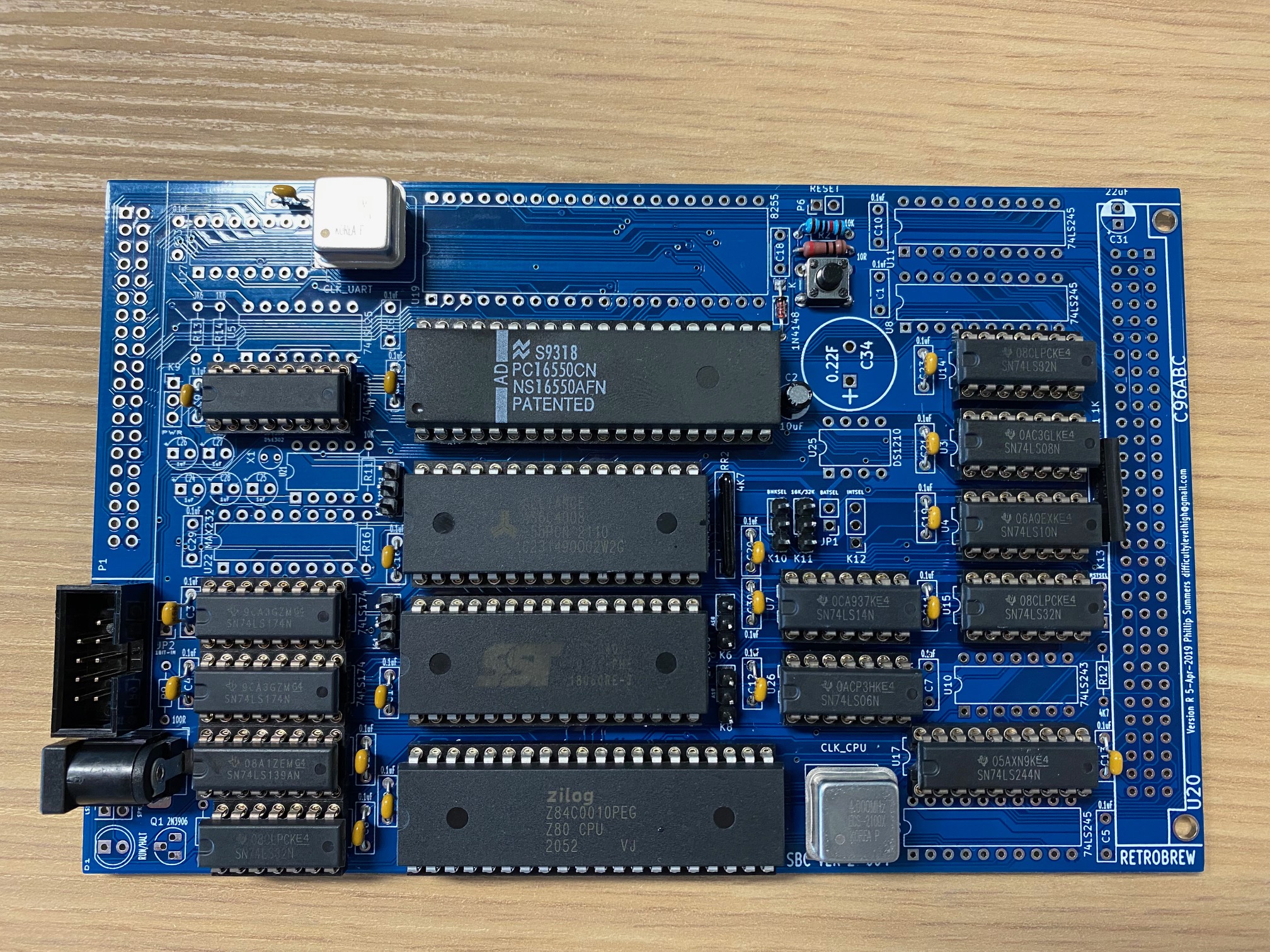

I added the next stage (SBC Build) of components to the second SBC V2 board as per instructions
https:// www.retrobrewcomputers.org/doku.php?id=boards:sbc:sbc_v2:sbc _v2-005
This stage revealed an error on my part and board silkscreen. Value of C28 is 10u (correect on the partlist) on the PCB it's 1 uF.
In my first build I only looked at the PCB so I soldered a 1uF tantal. So I was hopeful for a good outcome (first yahoo).
Connected the speaker too.

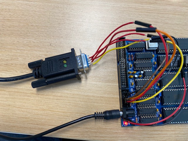

I removed the solder bridges on the back of the PCB. Connected the serial port with TX -> RX (2->5) and GND -> GND (5->5).
Connected power.
First observation was that the LED turned on Green. Dind't happen on the first build (so second yahoo) Fired up Teraterm: (still) no output on the screen.
When I hit de reset button: LED turns RED (and keeps that way).
The speaker doesn't give a peeps.
Bummer. Two boards with the same symptom. Strange, must be doing something very stupid.
Time to activate the logic analyzer again I guess.
Best regards,
Edzard

C28 was 1uF on the sbc-v2-003 and it was only changed to 10uF from version v onward. It shouldn't make any difference, it is only there for supply regulation.
The version R board does not have the clock divider so the additional 1k resistor is not needed.
Regards Phil

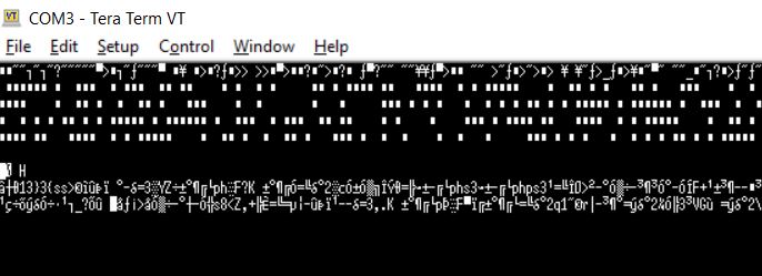

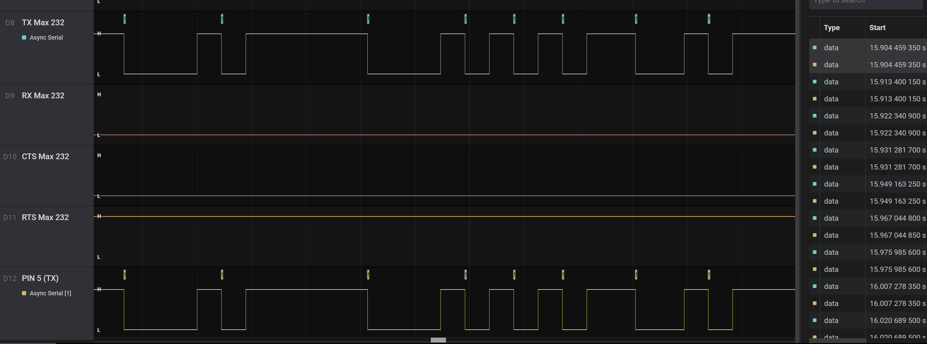

I've tried out your binary.
Got a strong beep while booting! I also swapped my USB serial adapter for an other one.
I got (finaly) something on the screen , but it is not readable. Changed every possible config but no luck so far.
My standard setup is 38400 - 8 bit - none parity - 1 bit (stop) - no flow control.
Normaly changing the baudrate fixes things, but not this time. Makes no difference.
Also removed the delock serial connector and use now a regular de-9 male connector.
Tomorrow I will do some more testing with the logic analyzer and the assembler programs.
Kind regards,
Edzard
/forum/index.php?t=getfile&id=2260&private=0
/forum/index.php?t=getfile&id=2259&private=0

To do a shoot into the blue moon:
One CPU seem to have a production date of 1935, the other of 2052.
These are surprisingly new parts.
Maybe fakes?
I don know the schematic, but does the 4 MHz oscillator mean the CPU clock is also 4 MHz?
I would make sure it is only 2MHz or test again with a known good CPU.

I haven't start testing/debugging yet. My logic analyzer was elsewhere, I just got it back.
I also ordered some (key)parts with an other distributeur, just to be shure.

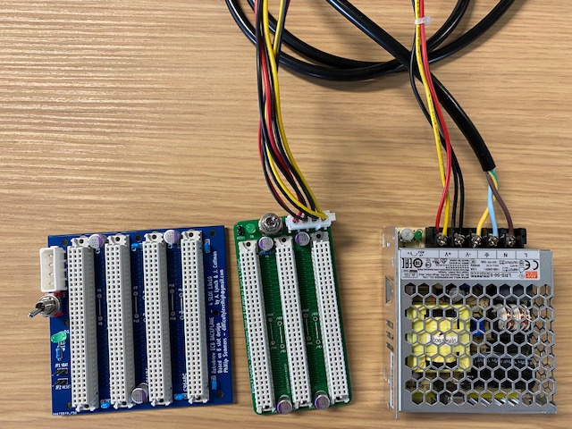

Meantime I started building the backplane and some other Z80 related PCB's so I have some reference in case it doesn't work.
Will post the progress!
Kind regards,
Edzard
/forum/index.php?t=getfile&id=2270&private=0
/forum/index.php?t=getfile&id=2271&private=0
/forum/index.php?t=getfile&id=2272&private=0
/forum/index.php?t=getfile&id=2273&private=0

I started debugging again. I changed the UART and MAX 232 butting nothing changed.
I burned 3 EPROMS: Beep (Phil), Spew (Roger) and Scream (Andrew).
I didn't have TASM for Spew and Scream at hand so I assembled them with RASM and burned them in a EPROM.
No error's, but both don't give any output. So I must be doing something wrong!
The "Beep" EPROM does give output (garbage on my screen) and (a decent) sound.
/forum/index.php?t=getfile&id=2307&private=0
Ohh, and yes, the label gets black if you put the EPROM the other way around..
Thanks to the tips on the Zif thread I packed each ROM onto a DIP..

Then I connected most of the UART and Max 232 with my logic analyzer.
/forum/index.php?t=getfile&id=2309&private=0
Output of the channels when connecting Power.
/forum/index.php?t=getfile&id=2310&private=0
/forum/index.php?t=getfile&id=2311&private=0
Best regards,
Edzard

Next pictures
/forum/index.php?t=getfile&id=2312&private=0
After resetting
/forum/index.php?t=getfile&id=2313&private=0
When beeping I hit the reset.
/forum/index.php?t=getfile&id=2314&private=0
Reset seem to fate out...
The Logic software give also a framing error.
Any thoughts?
Best regards,
Edzard

Re: Debugging a SBC V2-004 [message #8968 is a reply to message #8817] Fri, 06 August 2021 19:24 Go to previous messageGo to next message
cs looks good, output looks to be happening but be being interrupted
The multiple resets seems to be a problem.
I would try lifting reset pin 35 out of the socket and connecting the pin to 5v.
The try and track down where the resets are coming from.
I dont think there should be any activity on the int line, so perhaps uart is not being initialized correctly. Check wr and data lines.
Not understand why this is happening on both your boards though.
Do you have a minipro programmer? if so try testing all the ttl logic in the test function.
Those resets are me (doing so). Each time I hear a beep I reset again. Just to get some info on the lines. After some resets the output gets less and less.
[quote title= I dont think there should be any activity on the int line, so perhaps uart is not being initialized correctly. Check wr and data lines. [/quote]
Will do.
[quote Not understand why this is happening on both your boards though. [/quote]
Me neither. It could be one of the 74XXX is defect, because they come all from the same source (Mouser).
I've build also your latest version SBC V2005 MegaFlash. But I have still to program the Flash.
[quote Do you have a minipro programmer? if so try testing all the ttl logic in the test function.[/quote]
Will do that too.
Edzard
[Updated on: Sat, 07 August 2021 08:40]

Hello Phil,
I tested all TTL Logic IC's. All are good.
There's only one (and notably the 74LS06N in the Serial I/O section) who gives an error on a test set.
With the 7406 you have 2 test sets.
- 7406 (NonStandard)
- 7406 (OC/OD)
The first (NonStandard) gives an error, the second set passes and says the IC is good.
I have a SN74LS06N.
Tonight I will look at the logic analyzer.
Edzard

Hello All,
I changed the UART and MAX 232 but nothing changed.
Hi Edzard,
did You use only these NS16550AFN from National from the photos?
This NMOS part seems to have the requirement that
the /CS signal must be active min. 30ns before the /RD or /WR.
In the schematic, from /IORQ becoming active to /CS_UART becoming active there is an delay from U14D (SN74LS32, Tphl 14ns typ.) and
U6A (SN74LS139A, Tphl from enable 21ns typ.).
Maybe it's worth the afford to check the timing for an write access with the logic analyzer.
Just in case You find a problem here, eg. the ST16C550 from EXAR seems to be far more relaxed in this direction. It allows asserted /RD and /WR lines before (and after) /CS is asserted (and deasserted).
An other thing from Your photos: I didn't saw the minus mark on the C28.
just to be sure: Is it correctly mounted?
