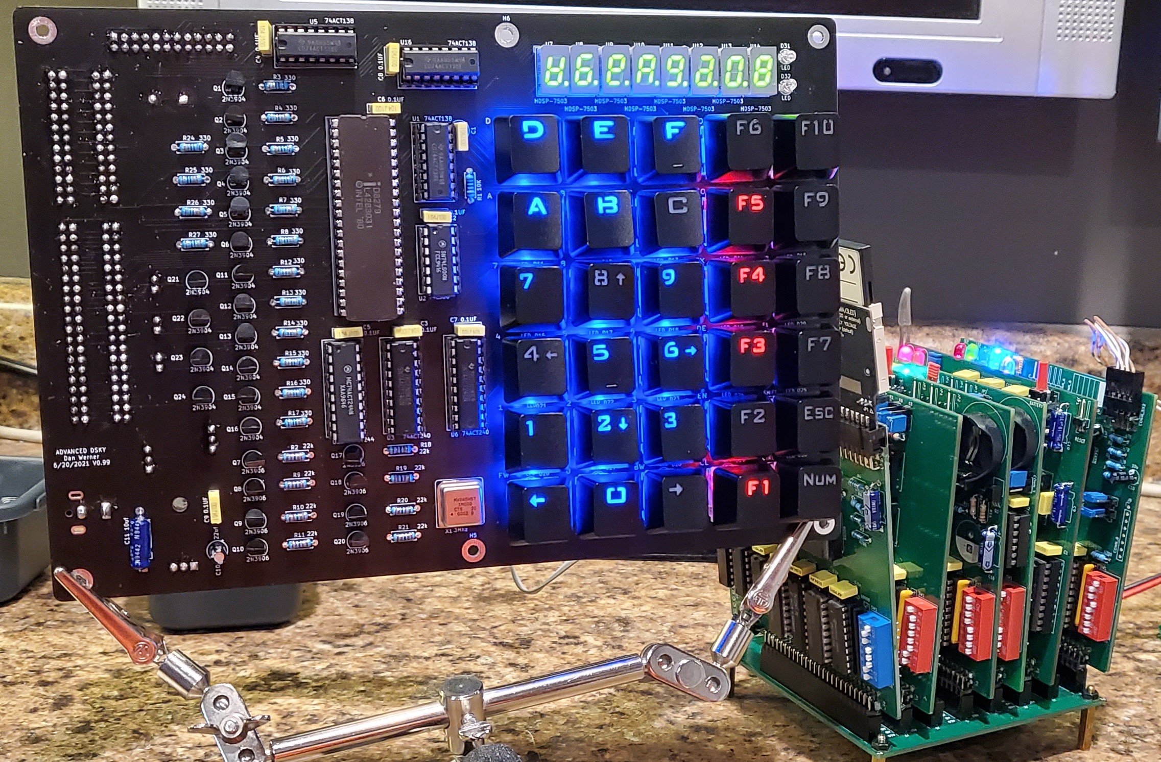

Looks like we are very close to a final DSKY revision. It is really more like a total rework of the board rather than a re-spin, and I think will end up working quite a bit better. The new version can be used on the same port with a PPIDE or PPISD and utilizes an Intel 8279 chip to scan the keyboard and multiplex the LEDs so it is pretty easy to interface with.
Below is a picture of the latest prototype working with Andrew's Z80MBC stack of boards. I am also attaching the current schematic and PCB layouts. I will be ordering the final PCBs this weekend, so hopefully I can post pictures of the board with the final keyboard layout in a week or so.
The keycaps that I used are just some CherryMX compatible keycaps with a DSA profile that I found on Amazon, then drilled and filled in the windows for the LED shine through (obviously my drilling jig needs more work, but not terrible for a first attempt). It would also be possible to order custom shine-through keycaps, but I have not ventured into that territory yet.

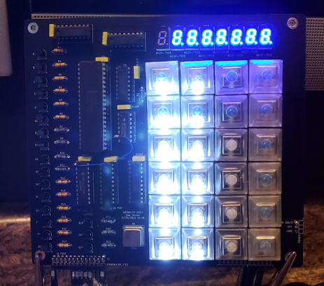

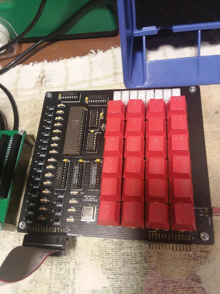

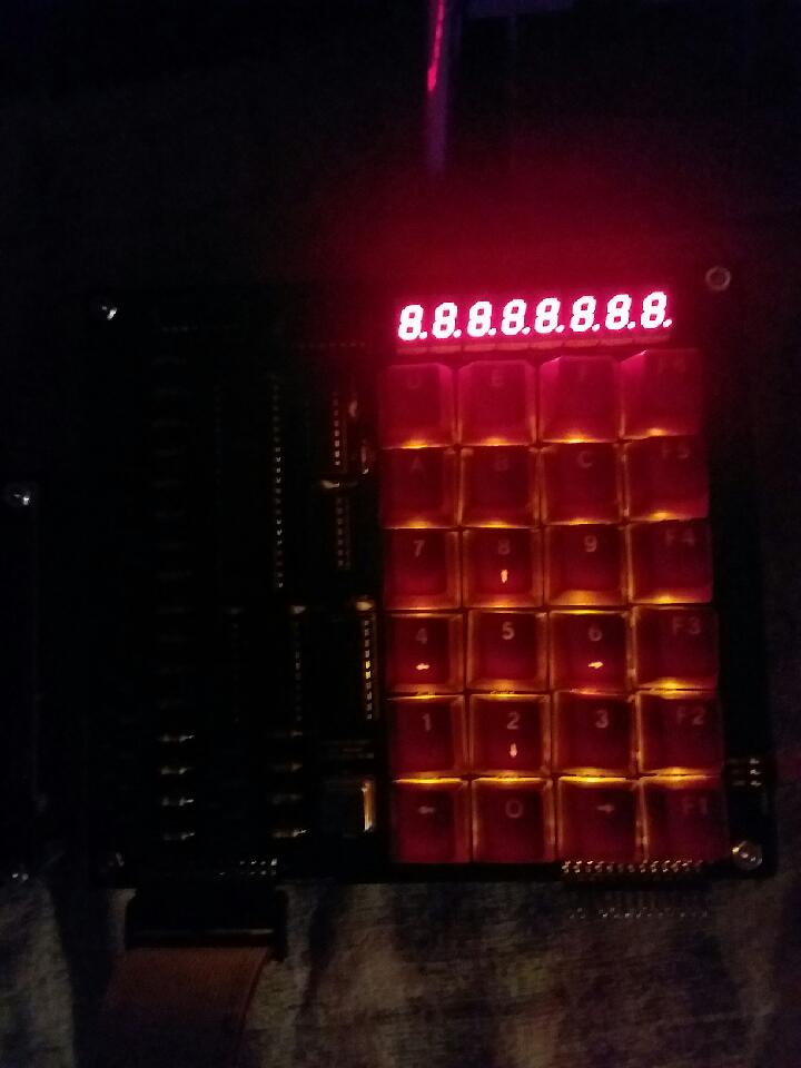

Here are a few other pictures of other keycaps.
https://flashquark.com/product/translucent-dsa-keycaps/ (Clear -- I don't really care for the clear ones as the LEDs are too bright. I think that the other colors might be OK though)
/forum/index.php?t=getfile&id=2202&private=0
/forum/index.php?t=getfile&id=2203&private=0
https://flashquark.com/product-category/keycaps/oem-keys/mix able/ (white)
/forum/index.php?t=getfile&id=2204&private=0
/forum/index.php?t=getfile&id=2205&private=0
the keycaps in the original picture are from here:
https://www.amazon.com/gp/product/B08T64C41K/ref=ppx_yo_dt_b _search_asin_title?ie=UTF8&psc=1

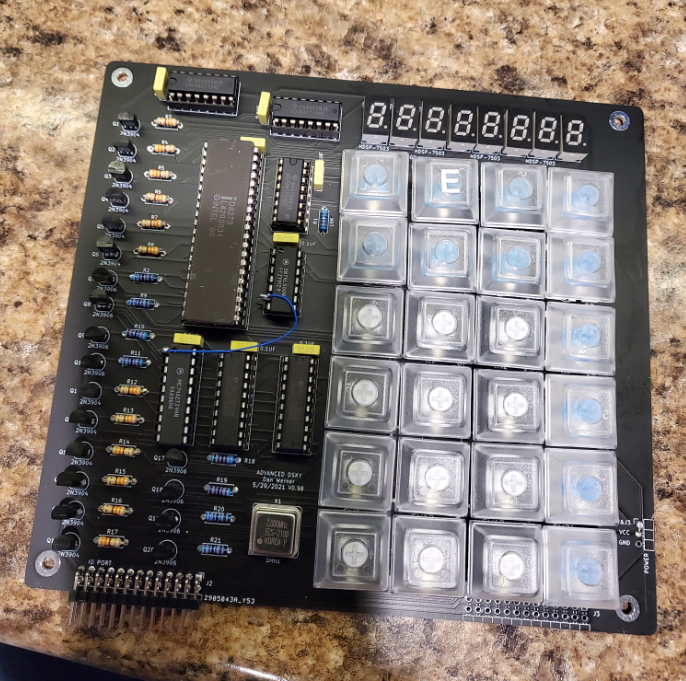

Re: DSKY V3? [message #8755 is a reply to message #8711] Mon, 05 July 2021 05:02 Go to previous messageGo to next message
Built and tested DSKY next generation with Z80 MBC. Wow, it works great and looks cool as heck! Ordered my key caps so hopefully this week I'll have it completed. Awesome project! Thanks!
Andrew Lynch
PS, even with all the LEDs the DSKY ng is self-powered from the PPI interface cable (keep it short) so no external power supply is needed. I had one prepared because I expected it would be needed but happily it works fine without one. I did notice a small voltage drop across the PPI cable of about a 0.1 volt so VCC is about 4.9x instead of 5.0x on the MBC backplane
/forum/index.php?t=getfile&id=2214&private=0

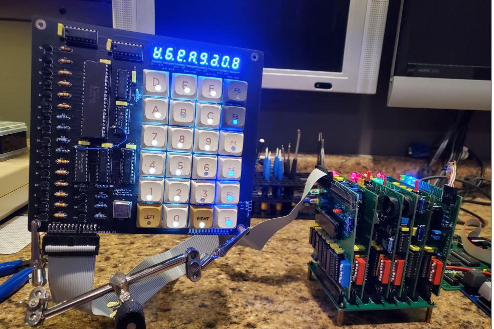

Re: DSKY V3? [message #8816 is a reply to message #8755] Fri, 09 July 2021 07:16 Go to previous messageGo to next message
DSKY ng with key caps installed
/forum/index.php?t=getfile&id=2231&private=0
/forum/index.php?t=getfile&id=2232&private=0
Black PCB, red keys, yellow backlight LEDs, glowing red 7 segment LED displays... Its the DSKY Darth Vader edition! ;-)
Great project Dan, congratulations!
PS, ROMWBW supports DSKY ng!
