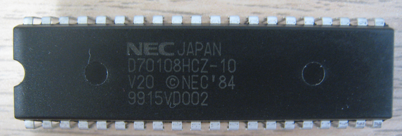

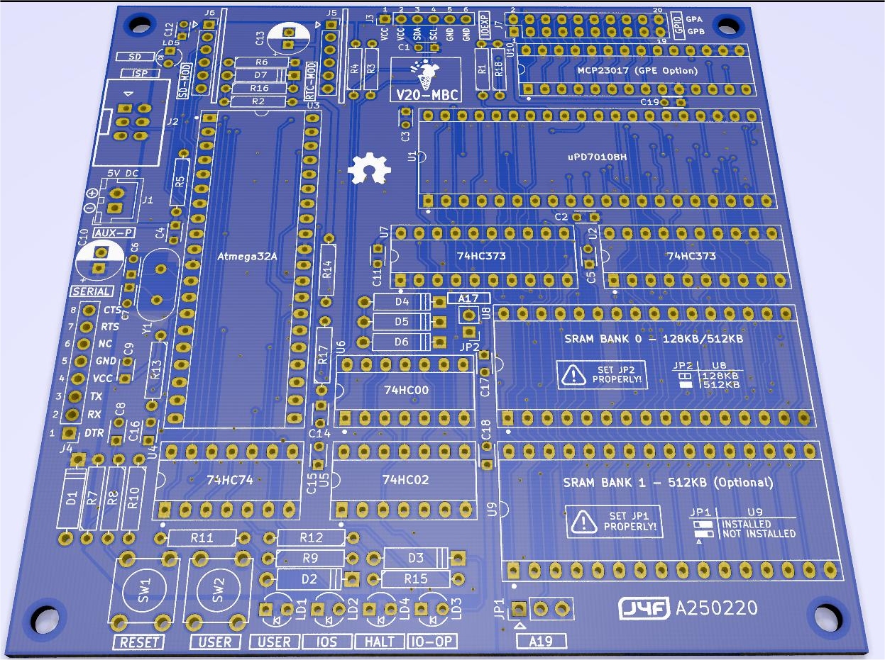

I've just finished the first draft of the schematic for an experimental test based on a V20 CPU.
The objective is to make an easy to build board V20 based, using a MCU to virtualize all the I/O chips as I've done with the Z80-MBC2.
The V20 is the CMOS full static version uPD70108H, so the minimum clock can be DC.

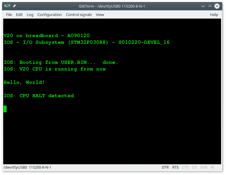

I've done some HW changes and added an "I/O" led:
/forum/index.php?t=getfile&id=1658&private=0
Now it is possible boot directly from a binary file on a microSD end execute it with the V20 CPU running at 8MHz.
Here the classic "Hello world" test:
/forum/index.php?t=getfile&id=1659&private=0

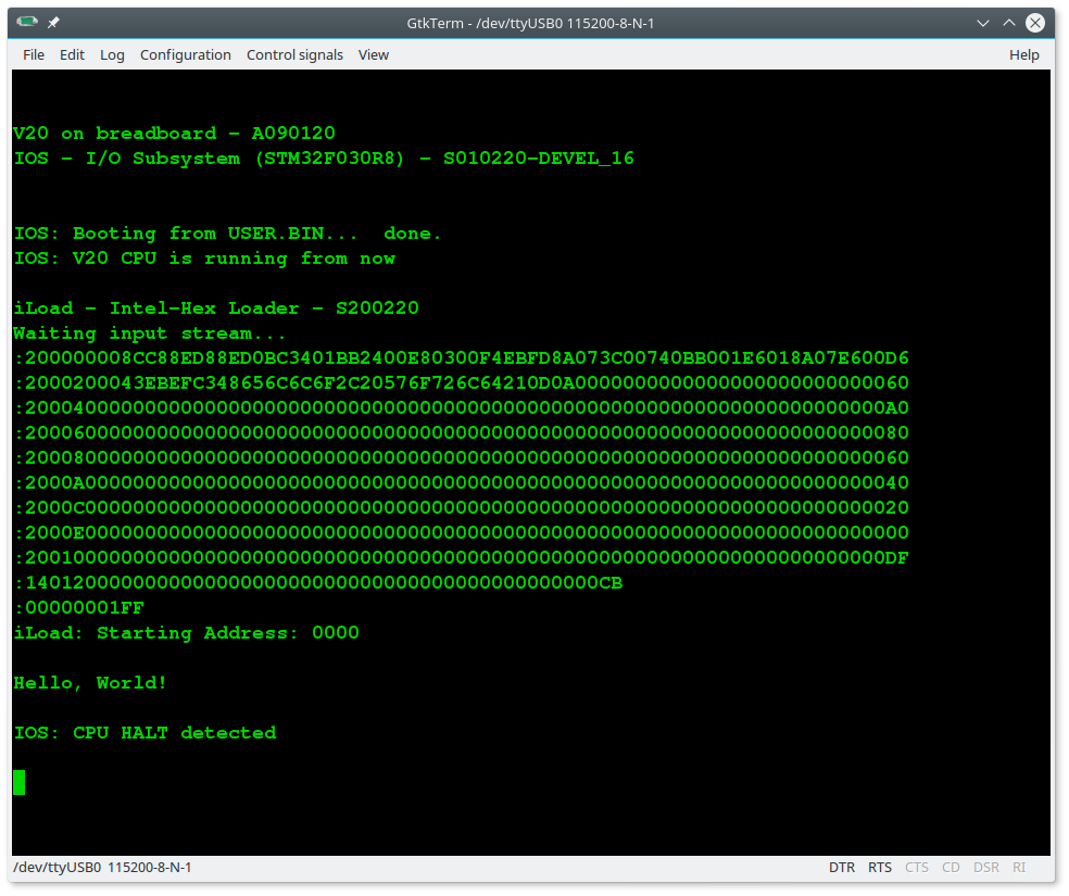

Little step ahead...

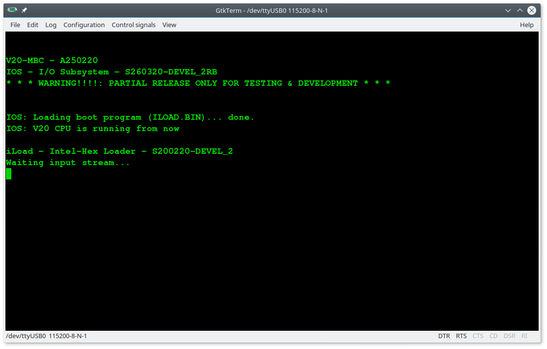

I've "manually ported" the iLoad loader from the Z80 assembler to 8086/8088, so now I've a decent toolchain to assemble, upload (with the serial port) and execute with one command (using TeraTerm):
/forum/index.php?t=getfile&id=1663&private=0
The limit of iLoad is that only a "flat file" can be used (so all the code and data inside a single 64KB segment), but it is more than enough for now.
This little system starts to be usable...

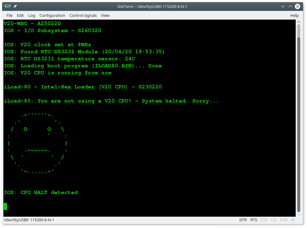

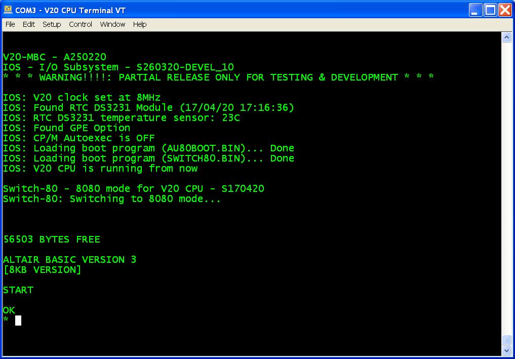

Just to test the 8080 mode of this CPU, I've "ported" the Altair Basic (8KB version).
I've done a new version of iLoad, called iLoad-80, to load a Intel-Hex 8080 executable.
After the load phase iLoad-80 switches the V20 CPU into 8080 mode and jumps to the 8080 code.
/forum/index.php?t=getfile&id=1670&private=0
Here a short video: https://www.youtube.com/watch?v=yM8VKNeYMu8&feature=yout u.be
[Updated on: Thu, 05 March 2020 10:18]

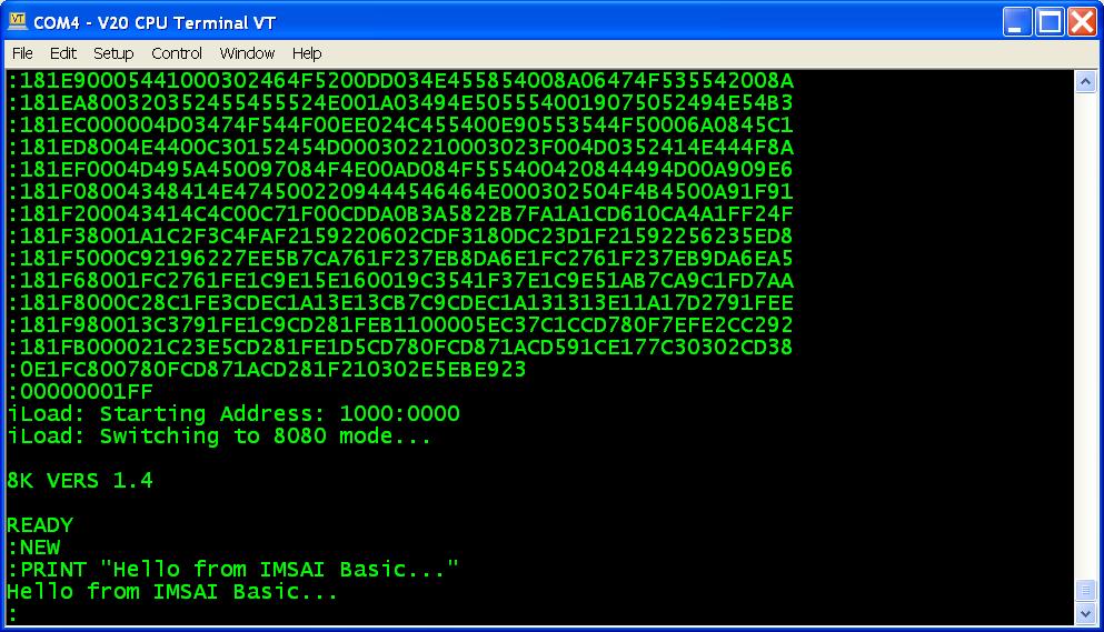

...and IMSAI 8KB Basic too... Smile
/forum/index.php?t=getfile&id=1676&private=0

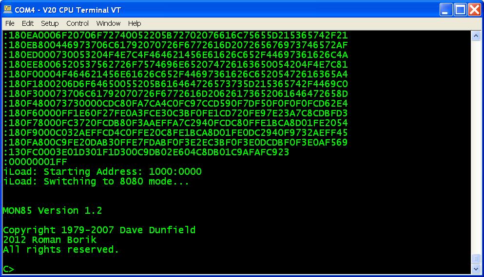

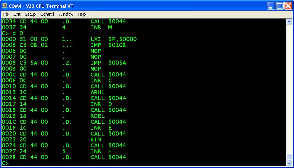

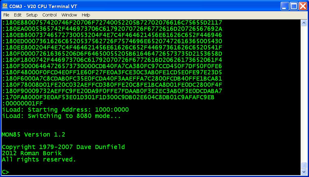

I must to admit that I'm having a lot of fun with this V20 on breadboard (distracting me to design the "final" board...).
So I couldn't resist to try the MON85 monitor from here.
I've done a change to the bin -> ASCII routine because it seems not to work on the V20 CPU in 8080 mode.
Here the change:
; Display A in hexidecimal
HPR:    PUSH    PSW     ; Save low digit
    RRC         ; Shift
    RRC         ; high
    RRC         ; digit
    RRC         ; into low
    CALL    HOUT        ; Display a single digit
    POP PSW     ; Restore low digit
HOUT:   ANI 0Fh     ; Remove high digit
    ;CPI 10      ; Convert to ASCII
    ;SBI 2Fh
    ;DAA
	daa
	cpi 10
	cmc
	aci 48
    JMP OUT     ; And output it
It is a great monitor!!
/forum/index.php?t=getfile&id=1677&private=0
/forum/index.php?t=getfile&id=1678&private=0
/forum/index.php?t=getfile&id=1679&private=0

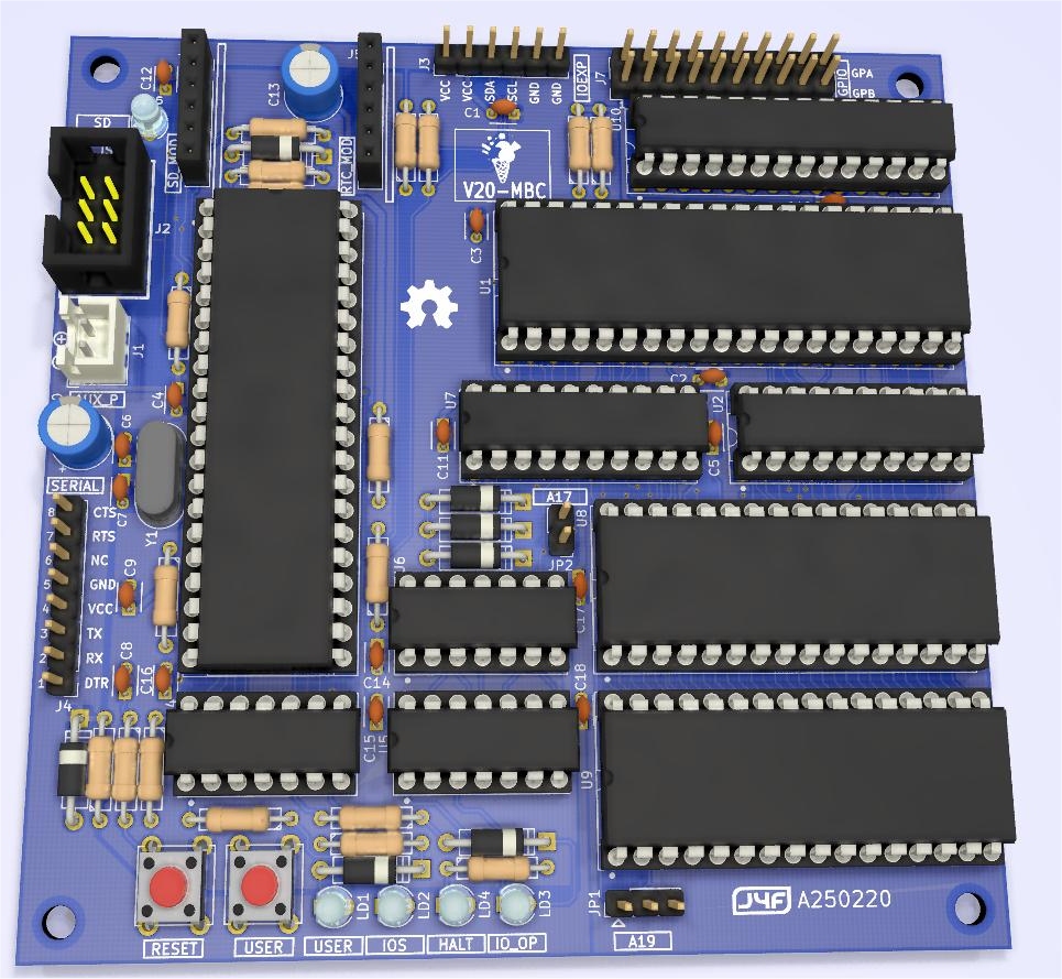

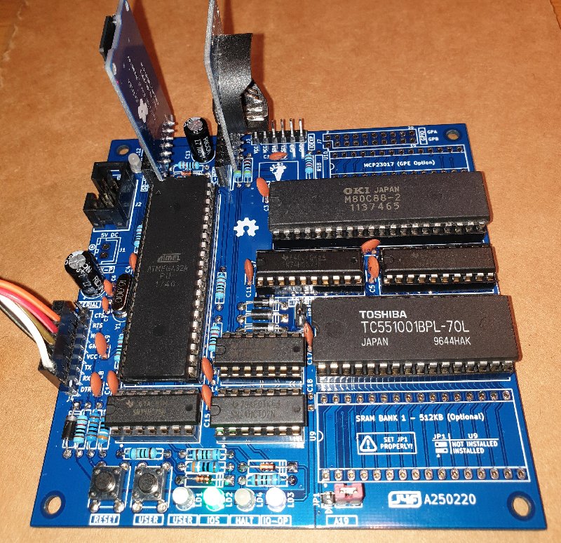

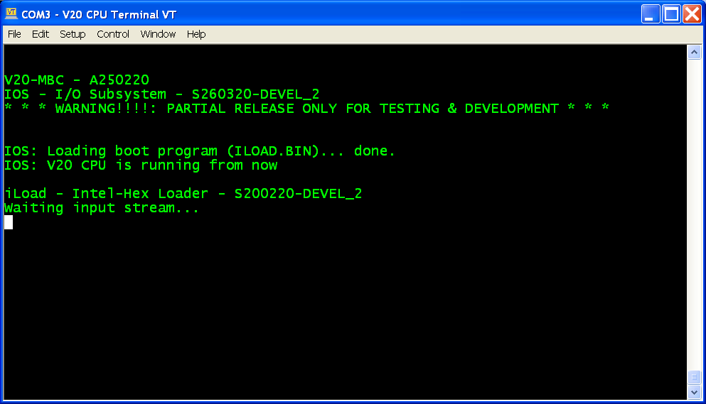

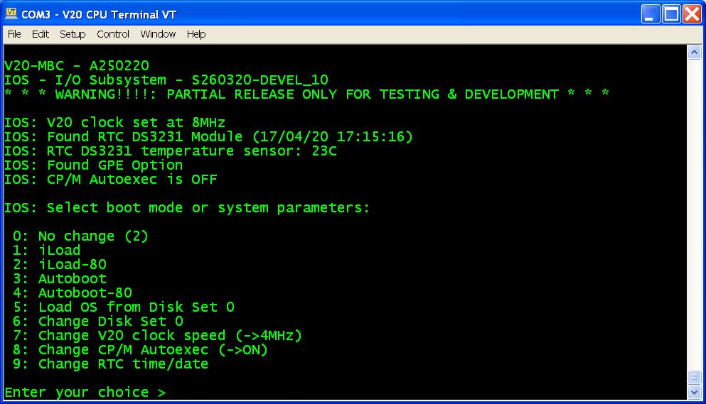

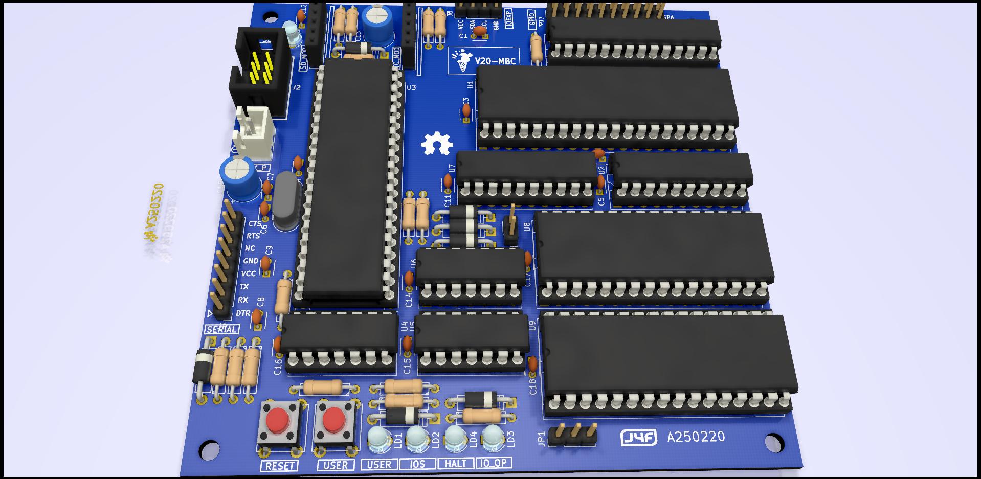

I've just finished the first draft of the "final" board schematic (see the the draft pdf).
Here I've used an Atmega32 as MCU (so only THP parts).
Here the main specs:
- V20HL CPU(uPD70108HCZ)
- RAM can be configured with 128/512/1024KB;
- optional RTC and microSD modules (the same used in the Z80-MBC2);

Here the final aspect of the board:
/forum/index.php?t=getfile&id=1696&private=0
I'll publish all the details as usual after some testing (hoping to be able to get the packet).

Just a warning that the chip markings on your V20 CPUs in your first post are consistent with re-marked chips.
That is, they are probably not really 16MHz parts, but re-marked parts that were originally rated at a lower speed (such as 8Mhz or 10Mhz). I can tell you more about this if you are interested.
This is a common issue with many retro and legacy parts. If you bought these parts from EBay and they came from Asia (for example China), then there is a high likelihood of this situation.
Therefore I just wanted to warn you that if you ever clock your chips at a high speed and you run into unusual behaviour, you do not have to blame your design! Smile
Best regards and good luck with your project!

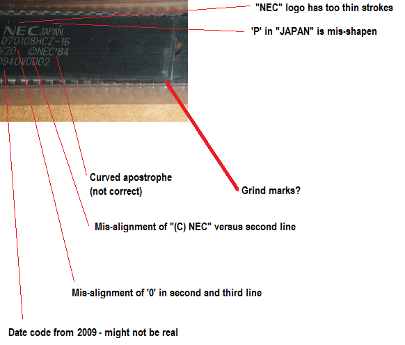

Long back story: In recent years there has probably been some renewed demand for legacy ICs such as CPUs and EPROMs, which are no longer manufactured. The IC counterfeiters of the world took the opportunity to profit from this. I can only assume that people often search for higher speed rated parts, as this seems to be a common reason for many re-marked Motorola, Zilog, Intel and other CPUs. Another common item is that slower speed EPROMs are re-marked as higher speed parts (and also the brand is changed). So if you search for "ST 27C400", you will find many, many re-marked parts (my programmer can read the ID code, often I have found that these are re-marked Macronix or National parts).
Most of the supply of these parts comes from a few warehouses in Asia. 99.9% of the sellers on EBay do not hold stock, they simply act as a seller and when you order a part they either buy it from these warehouses (or a distributor) or (more commonly) they arrange for drop-shipping from the warehouse/distributor direct to you. Often I found that ICs I bought from China or HK, are posted to me directly from the Philippines, Brunei, and other countries in Asia. When I have complained about the parts being counterfeit, the seller will often perform an immediate refund with no questions asked. The sellers have little knowledge of what they are selling, they often offer thousands of different items (sometimes not just ICs). Sometimes the picture looks good, but the part you receive is not the marked the same way.
The re-marking of chips exists at different "quality levels". The simplest method, is to paint over and use ink. If you rub these ICs with IPA or Acetone the ink often can be removed.
-> Try to rub the top of your IC with acetone or IPA and check if the marking is removed.
"Higher quality" re-marked chips usually have been ground on top, then a "black top" is applied. They then use laser engravers to re-mark the chip. Usually the markings have mistakes in them such as:
- Colour of marking does not match a part from that time
- Invalid date codes (for example a MC68010 with date code of 2019!)
- Many, many parts have the same batch code
- The marking does not match the original part
To see a great example of what "black top" and laser engraving looks like on an MC68000, see this photo from a colleague: https://twitter.com/SushiL0gic/status/1116219450708021248/ph oto/1
Recently I made a special effort to buy a real NEC V20. I was tired of receiving counterfeit parts, so I bought it from a seller in the USA. This is the appearance of my part:
/forum/index.php?t=getfile&id=1701&private=0
Here is an image of your NEC V20 with signs of re-marking highlighted:
/forum/index.php?t=getfile&id=1707&private=0
The counterfeiters have improved their process, but they still lack attention to detail :)
  • Attachment: Re-marked.png
    (Size: 88.47KB, Downloaded 2062 times)
  • Attachment: NEC-V20.png
    (Size: 860.31KB, Downloaded 2124 times)
[Updated on: Tue, 24 March 2020 15:30]

Starting some testing:
https://i.postimg.cc/bYt5jnjz/V20-MBC2.jpg
/forum/index.php?t=getfile&id=1753&private=0
/forum/index.php?t=getfile&id=1754&private=0
  • Attachment: V20-MBC_1.PNG
    (Size: 33.54KB, Downloaded 1911 times)
  • Attachment: V20-MBC_2.JPG
    (Size: 140.17KB, Downloaded 2036 times)

Some little improvements...
Here the new boot/system menu:
/forum/index.php?t=getfile&id=1767&private=0
iLoad: loads and executes a 8088 Intel-Hex executable from the serial;
iLoad-80: loads and executes a 8080 Intel-Hex executable from the serial;
Autoboot: loads and executes an 8088 binary file (AUTOBOOT.BIN) on SD;
Autoboot-80: loads and executes an 8080 binary file (AU80BOOT.BIN) on SD.
iLoad (option 1) is now embedded into the FW, so it is the only possible boot choice if there is no SD installed.
Options 5, 6 and 8 are useless for now...
Here the load of the AU80BOOT.BIN 8080 binary file from SD. In this case a dual-stage boot is needed.
In the first stage is loaded the 8080 executable, in the second one the Switch-80 utility that
takes care to activate the 8080 mode and executes the 8080 code (I've used the Altair Basic executable as 8080 binary):
/forum/index.php?t=getfile&id=1768&private=0
Here a fully assembled board:
https://i.postimg.cc/Px3NNL8K/20200415-134535.jpg
  • Attachment: V20-MBC_3.JPG
    (Size: 86.71KB, Downloaded 1882 times)
  • Attachment: V20-MBC_4.JPG
    (Size: 92.48KB, Downloaded 1888 times)

I've tested an 80C88 CPU too and seems to work:
https://i.postimg.cc/52jb59QX/20200420-200815.jpg
...and if you try to run an 8080 executable this is what you get: Laughing
/forum/index.php?t=getfile&id=1774&private=0
