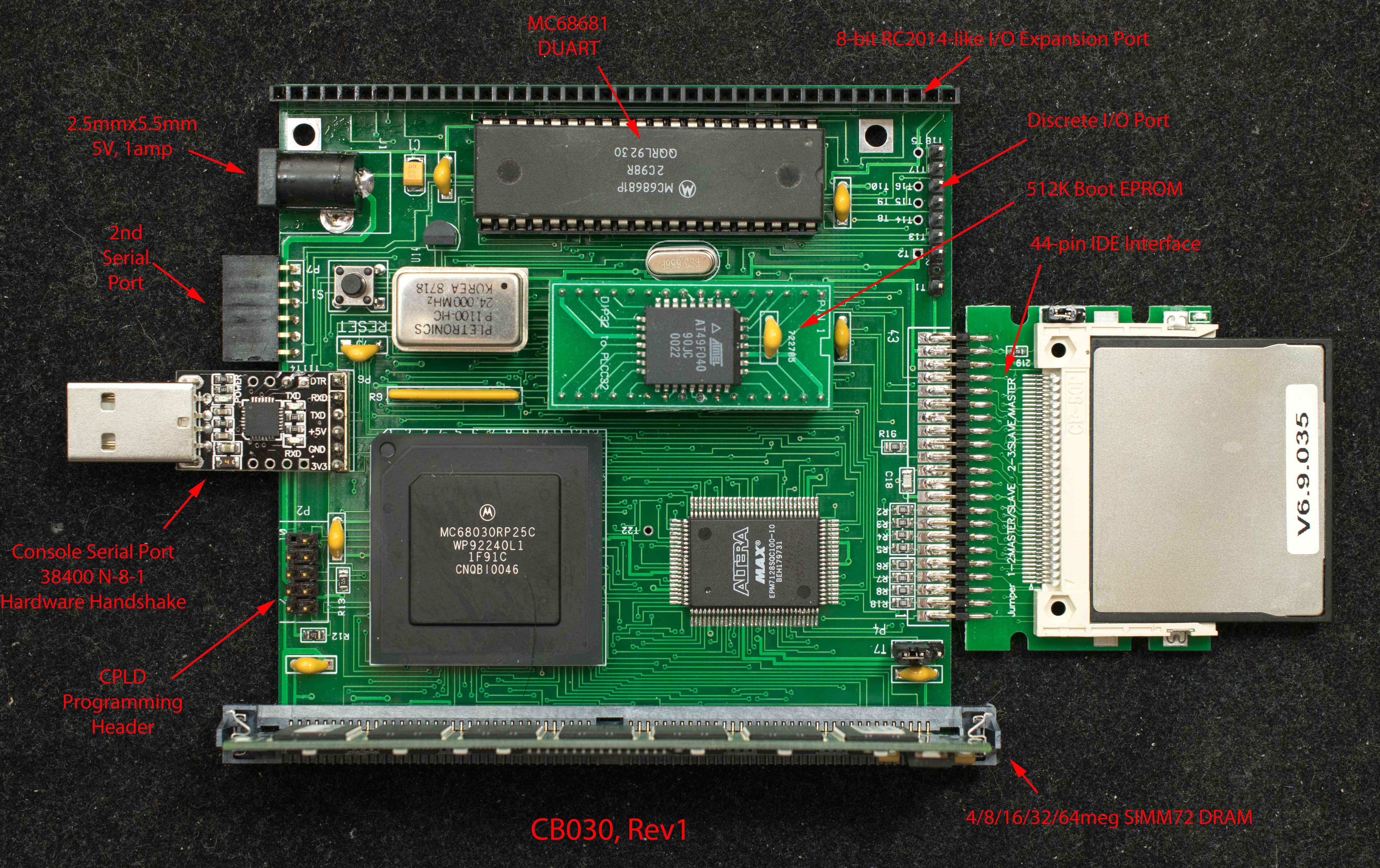

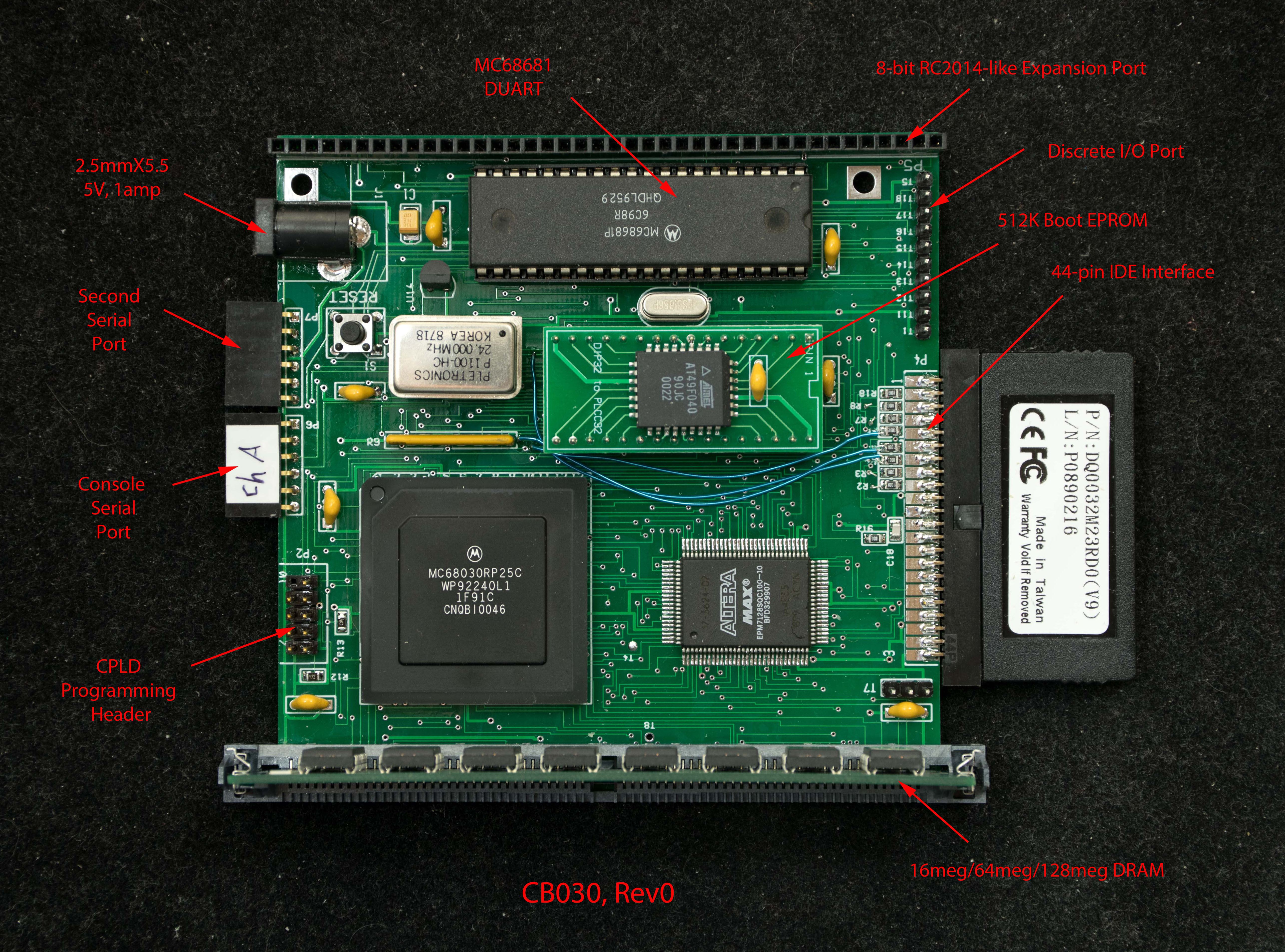

CB030, A 68030 SBC for hobbyists [message #6931] Sat, 18 January 2020 09:44 Go to next message
Having spent 2 years in the Z80 world, I'm returning to the 68K. Currently I'm working on a 68030 SBC, CB030, named after Cecil B. who is really enthusiastic about Tiny030 and want one even with all the jumpers. Unfortunately Tiny030 design is marginal and not producible so I redesigned it and added additional features specifically for Cecil.
I want CB030 to be simple, economical and build-able by hobbyists. For 68030 these are difficult requirements because 68030 is inherently not economical, simple nor easily assembled by hobbyists. However, it may be possible to meet these challenging requirements with a couple design compromises. The compromises are using a modest surface mount CPLD as the glue logic and using inexpensive commercial SIMM 72 as memory. Great deal of expensive and complex logic can be reduced with an economical CPLD; with vertical SIMM memory stick, the pc board shrink to the economical 100mm x 100mm size; the rest of components are all thru-hole technology so assembly become manageable. The one difficult-to-assemble CPLD is designed to be assembled and programmed first and the partially assembled pc board sold for about $15-20 so the end users can source their own components and finish assembling the board.
Here are features of CB030:
* Low cost 25MHz 68030
* 72-pin SIMM 16/64/128 meg DRAM
* CPLD glue logic
* 8-bit 512K boot EPROM
* 68681 DUART
* 44-pin IDE interface
* 8-bit I/O expansion connector
* 100mm X 100mm pc board
* CP/M68K ready
The 512K EPROM contains a simple monitor and CP/M68K BIOS/CCP/BDOS as well as few basic CP/M68K system files, enough to format new CF disk and transfer files from PC to CF using KERMIT. CP/M68K is a place holder operating system, what I hope for is a modern OS for CB030, but that's beyond my ability right now. Perhaps the low cost, hobbyist-friendly 68030 SBC can attract the software talents for more suitable operating systems.
CB030 is currently in rev0 prototype. It is functional, but there are several mistakes that'll require a new board revision. Of particular note is the DiskOnModule shown in the attached picture. The design calls for a CF disk, but because the connector layout was inadvertently mirrored which happens to match the mirrored pin assignment of DOM, the rev0 board uses DOM instead of CF disk for mass storage. Preliminary information:
https://www.retrobrewcomputers.org/doku.php?id=builderpages: plasmo:cb030spec

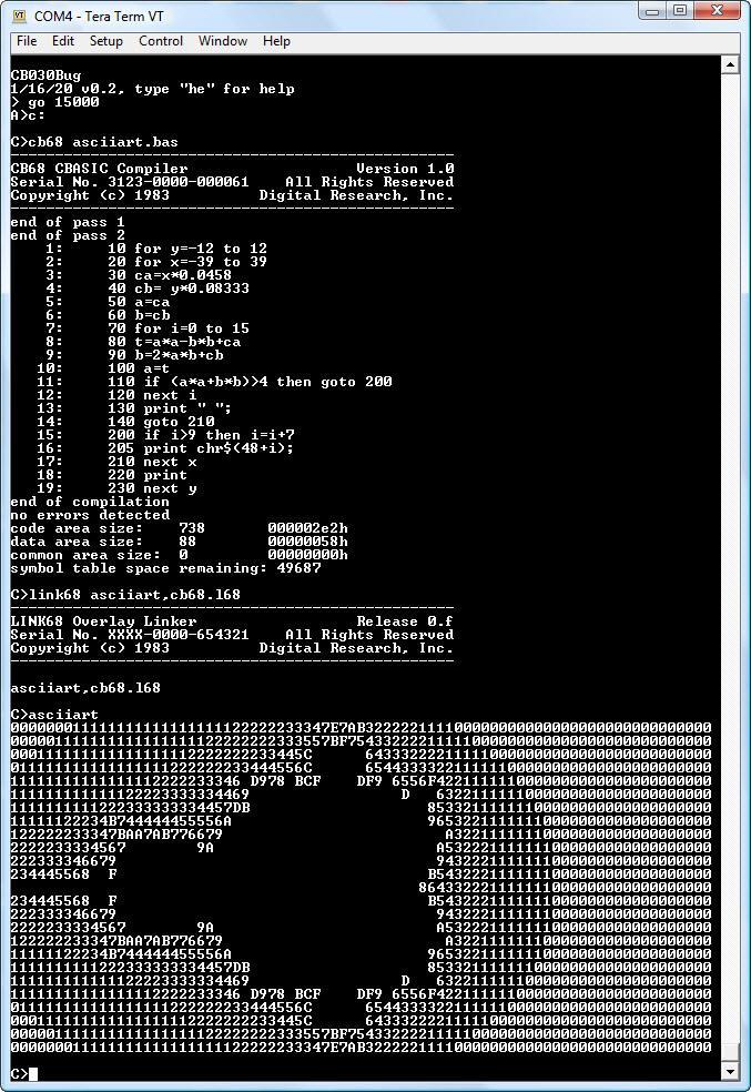

Hi Bill.
What was the run time on asciiart? Possibly limited by terminal speed?
Regards Phil

The BASIC compiler, CB68, running in CP/M68K is quite inefficient. It takes 70 seconds to run the same program that ran in 24 seconds with EhBasic. The speedup over 8MHz 68000 is only about 3 times. I think there are a number of performance issues I need to work on such as wait state accessing DRAM, enable I & D cache and enable cache burst fill.
Re: CB030, A 68030 SBC for hobbyists [message #6938 is a reply to message #6937] Sun, 19 January 2020 06:05 Go to previous messageGo to next message
Look into the DRAM wait state and able to reduce the wait state from 2 to 0, and just barely meet timing requirements of 60ns DRAM with 24MHz 68030. With 0 wait state, ASCII mandelbrot runs 18 seconds in EhBasic and 51 seconds in CP/M68K's BASIC. At 18 seconds, the 38.4Kbaud serial starts to have an impact on the benchmark value. Another reason for the difference in performance is the instruction cache is turned on in EhBasic, but I still unable to turn on I cache in CP/M68K without getting privilege violation.

This is rev1 of CB030: https://www.retrobrewcomputers.org/doku.php?id=builderpages: plasmo:cb030:cb030_rev1
I built up 5 boards and all 5 are working. While the CF interface works with many brands of CF disks, it still won't work with all brands that I have on hand.
Made change to the way SIMM72 memory is interfacing so now it can handle 4/8/16/32/64/128 meg SIMM72 modules seamlessly, although for 8 and 32 meg memory, there are two blocks of non-contiguous memories that I still don't know how to fix automatically. I'm relying on 68030's MMU to fix that.
CP/M68K is ported, in fact, 384K of the 512K EPROM is a ROM disk containing few important CP/M68K files to allow a new CF disk to be initialized and uploaded with CP/M68K software. Lee Davison's EhBasic is ported as well.
Power consumption with 16meg SIMM72 is about 650mA at 5V.
