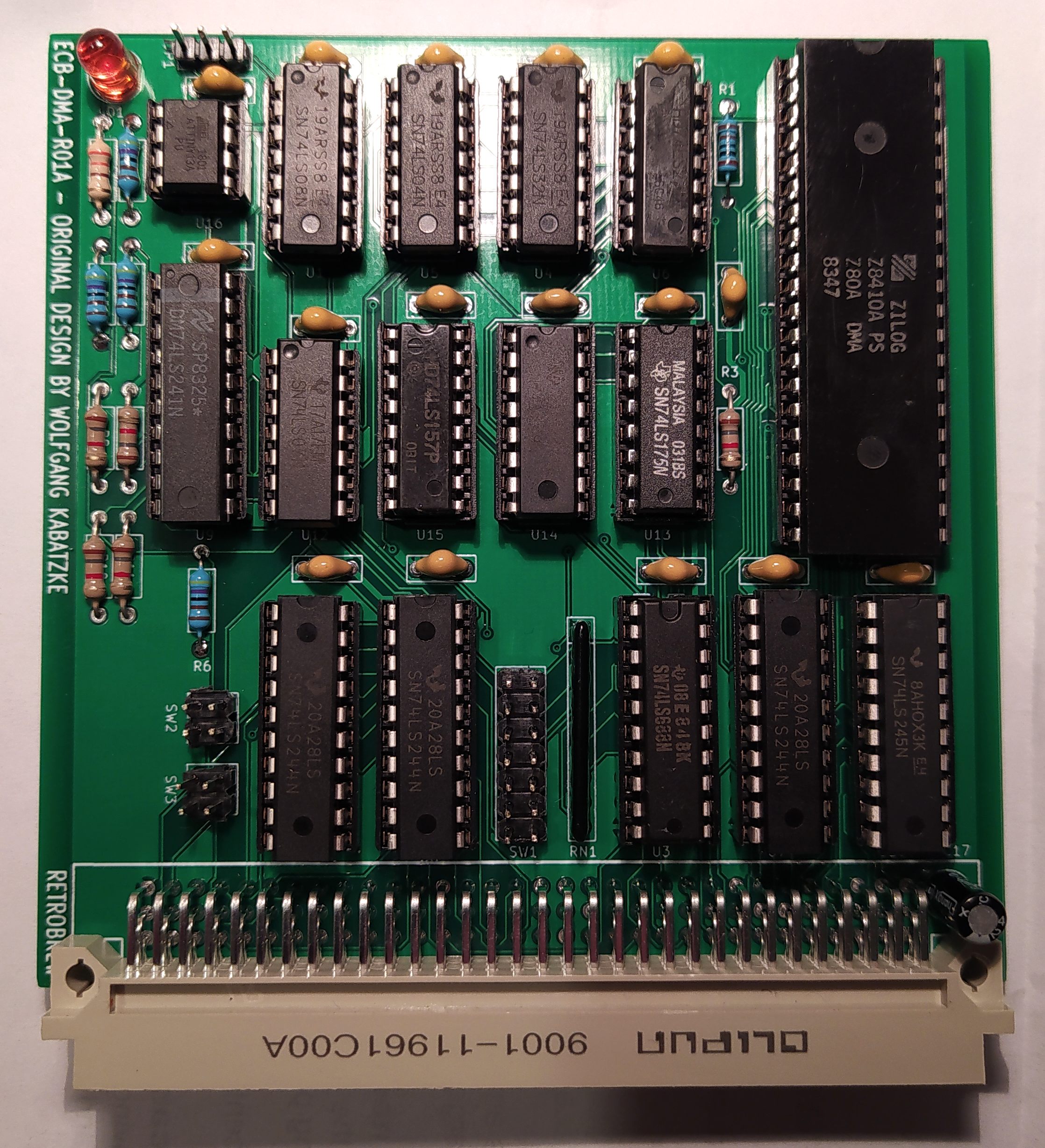

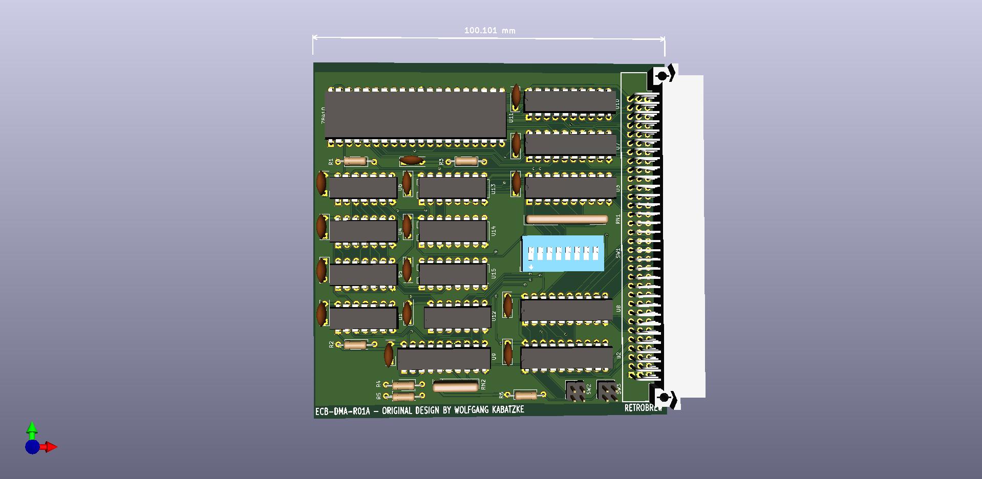

I have been working on reimplementing Wolfgang Kabtazke's ECB-DMA board.
https://www.retrobrewcomputers.org/doku.php?id=boards:ecb:dm a:start
I beleive this was prototyped but never finalized.
Kicad files have been regenerated and I have just finished routing the board in 10x10 format.
Would anyone be interested in building and debugging this board if I order some?
Regards Phil.

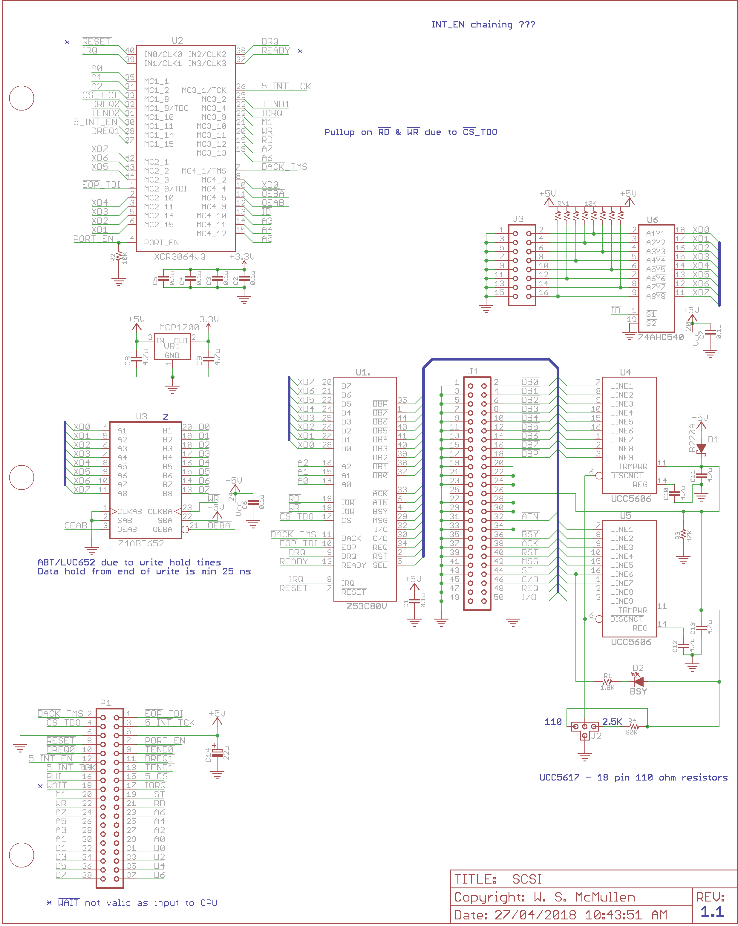

Just FYI, I put together a schematic for a SCSI host adapter which uses DMA. It has not been tested, but is based on a reference design I found on-line, although it was for a 6502-based system. So, I had to adapt it a bit for the ECB. The schematic is attached, I feel that the DMA part of it needs some work, and maybe the chip-select logic. Other than that, it's a simple design.
When looking at it, if anyone sees something that needs to be changed, let me know.
Rich

Re: ECB-DMA [message #6868 is a reply to message #6867] Thu, 12 December 2019 21:24 Go to previous messageGo to next message
wsm is currently offline  wsm
Messages: 232
Location: AB, Canada
I don't have any of the ECB cards so won't comment on that interface. However, I did develop a SCSI interface board for my NYOZ system using the Z53C80 which is the CMOS version of the Z5380 / NCR5380. A couple of comments:
Termination takes a LOT of current and is one more potential configuration problem, especially when devices are added / removed from the chain or powered down. I chose to use active termination based on the UCC5606 which also has the advantage of offering 2.5K Ohm versus 110 Ohm termination for short cable runs.
I'm not sure which processor you intend to use but the 53*80 requires a relatively long data hold after the IOW* goes inactive: 30/40 ns for the 5380 and 20/25 ns for the 53C80 (CPU write/DMA write).
Note that the datasheet discusses block-mode DMA restrictions and does not recommend using this mode due to the difficulty in detecting when there are SCSI bus errors.
If using the Z180's DMA channels, it should be noted that on DMA reads they generate the TEND signal on the last DMA memory write, and not on the I/O read as the peripheral would expect. Although I see the XFER_END# signal going into your 5380's EOP#, it's not obvious to me where it's actually coming from.
  • Attachment: SCSI.png

Re: ECB-DMA [message #6869 is a reply to message #6868] Fri, 13 December 2019 07:22 Go to previous messageGo to next message
rcini is currently offline  rcini
Messages: 64
Location: Long Island, NY
I like some of the features of the design you have such as the terminator power. The design I did is not finished -- I left the DMA stuff open because I didn't know how to handle it -- lots of "placeholder" kind of stuff. So, I'm kind of hoping someone can take this design as a starting point and build on it.
Rich Cini

Re: ECB-DMA [message #8686 is a reply to message #6745] Thu, 17 June 2021 07:14 Go to previous messageGo to next message
Finally build Smile
1983 DMA chip Smile
This will be a real challenge figuring out if this works.
/forum/index.php?t=getfile&id=2195&private=0
Re: ECB-DMA [message #8687 is a reply to message #8686] Thu, 17 June 2021 07:29 Go to previous messageGo to next message
Great news! I am looking forward to finally getting to the bottom of this mystery board. Does it work? If so, what can it do? Very interesting!
Good luck!
Re: ECB-DMA [message #8692 is a reply to message #8687] Sat, 19 June 2021 05:33 Go to previous messageGo to next message
Findings so far:
I have managed to do a small memory to memory transfer using dma.
The data bus direction logic is not correct. I added an inverter on the 74LS245 direction pin and that was sufficient to getting the memory transfer to work but am unsure if the problem is deeper than that.
Memory Transfer fails after 5MHz clock speed (Using 10Mhz crystal with clock divider)
Memory Transfer fails on copy size greater than ~800 bytes.
Activity LED works.
The board decodes two ports. Base port is for programming the DMA chip. Second port triggers the transfer after programming.
I'm honestly surprised to have gotten this far Smile
[Updated on: Sat, 19 June 2021 06:39]

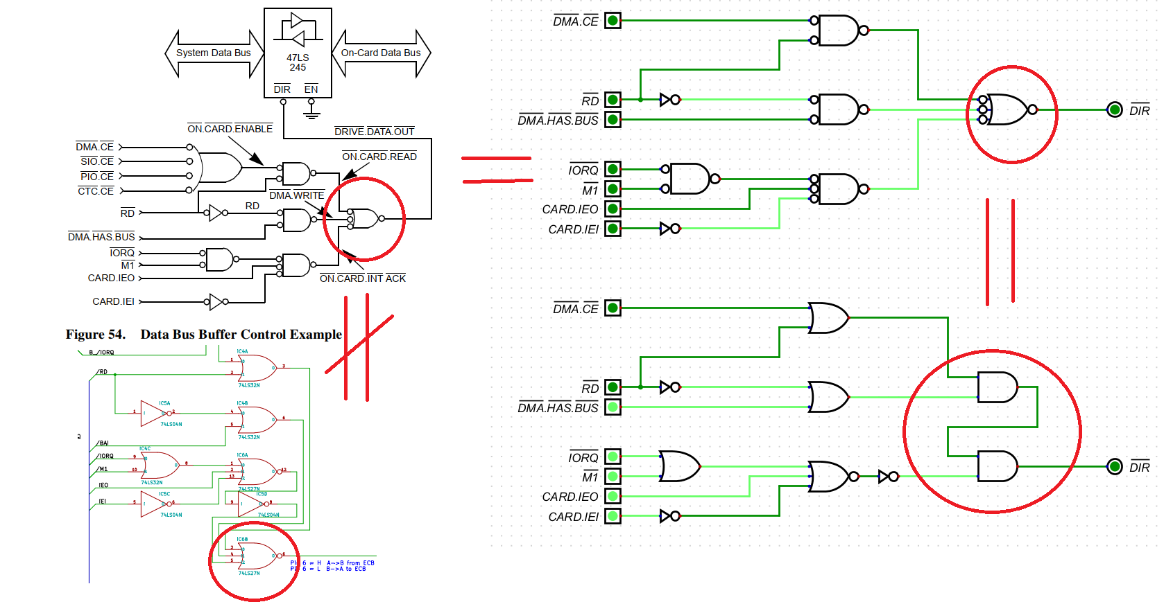

Re: ECB-DMA [message #8760 is a reply to message #8748] Mon, 05 July 2021 07:35 Go to previous messageGo to next message
Well after all the celebration of finalizing all that, I though I would go back and understand and verify the data bus direction logic.
To my embarressment I found that the data bus direction wasn't changing.
So I looked deeper into the issue and compared the circuity against the data sheet. I believe there has been an incorrect logic substitution.
I have patched in a correction using the spare gates and it seems to work, I can see direction changes now. I will confirm if I can do register reads which I hadn't tried before.
If all successful I will post an update.
Best Wishes Phil

Re: ECB-DMA [message #8786 is a reply to message #8760] Wed, 07 July 2021 03:27 Go to previous messageGo to previous message
Hi Phillip
Awesome, this is great work and I am looking forward to robust testing of the new DMA board design. I would very much like to port the design over to the Z80 MBC and my plan is the DMA will be the next board after the Z80 FDC. Speaking of Z80 FDC, I am designing the Z80 FDC to be PIO and DMA compatible with the important DMA signals (TEND# and FDC_DMA) being exported as "flying signals" over-the-top. The Z80 DMA board will be an adaptation of the ECB-DMA board with a corresponding connector.
Probably this is not the greatest DMA-FDC design ever but the goal is to demonstrate it working and if successful we can make further adaptations in the inevitable PCB respin cycle. There are already a bunch of DMA related signals in the Z80 FDC design so I am hoping everything is covered. If someone is knows more about DMA and FDCs would please take a look at these features of the Z80 FDC and also the ECB-DMA and post feedback or send me an email.
Again, this is wonderful and its great to see this DMA issue finally getting its due after literally years of discussion. Great job and keep going!
PS, oh yeah, what I originally meant to say is these complicated direction logic circuits can drive you nuts trying to figure them out and get it straight. For me it was the bus direction on the original Z80 SBC with all the rules for internal and external IO, memory, etc. More recently, on the Z80 MBC it has been the chip select logic on the Z80 ROM and Z80 RAM were an odd combination that even on two separate boards had to work together. What I did was write up logic truth tables in my notes to get all the scenarios straight and ensure the outcome is what I was expecting and wanted to happen. Actually on the Z80 ROM and Z80 RAM boards I ended up putting the truth tables on the schematics because it was so difficult to explain how those two boards interact. You might consider a similar approach to make your design logic more visible and enable others to help you. Just a thought meant to help
[Updated on: Wed, 07 July 2021 03:34]
