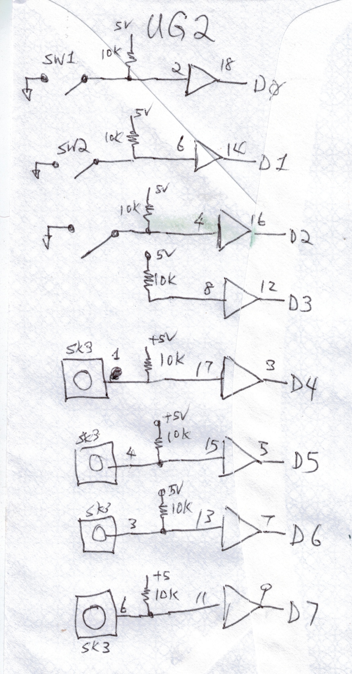

Roger & Gary,
I'm glad you've received the board in great shape. Did you take a look at drive C? Drive C is a RAMdrive backed up with a super capacitor. The capacitor can keep its content intact for well over a week on my bench, but I'm curious whether the anti-static bag would discharge the capacitor during shipping.
I'll answer your question about the switches directly, but it is also an action item for me to update the wiki page with better organized info regarding memory map & I/O schematics.
The hex switch and 3-pos toggle DIP switch are buffered via UG2 (HC244) and appear as a memory location as follow:
DIP SW1 is d0, with 10k pull up,
DIP SW2 is d1, with 10k pull up,
DIP SW3 is d2, with 10k pull up,
d3 is pulled up with 10K,
Hex switch SK3 pin 1 to d4, with 10K pull up,
Hex switch SK3 pin 4 to d5, with 10K pull up,
Hex switch SK3 pin 3 to d6, with 10K pull up,
Hex switch SK3 pin 6 to d7, with 10K pull up,
Note: the 4-bit input value for SK3, d4-d7, is invert of the value printed on the switch.
Attached is a hand-sketched schematic of the switches (You can see the envelop glue lines because it was literally on the back of an envelop).
index.php?t=getfile&id=594&private=0

Re: Porting CP/M 68K to a repurposed ADC Soneplex MPU board [message #3437 is a reply to message #3436] Sun, 10 September 2017 19:10 Go to previous messageGo to next message
The fact there are 7 user definable switch inputs and 8 inputs from DIN connector is quite useful. The software can change mode based on the switch inputs. When I add the Compactflash IDE daughter board I will take one of the DIN discrete input and tell the BIOS that external IDE-CF is attached so to enable CF drives.
In my XBEE application, I use the hex switch to assign address of each XBEE station and the DIP switches for different modes of operation.

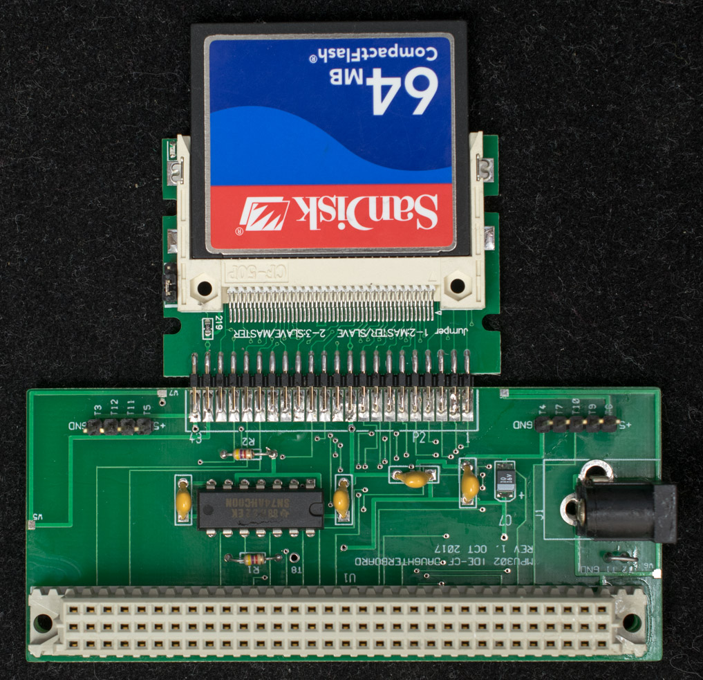

Received the pc board from Seeed Studio this morning. Here is the assembled board and how it plugs into the SPX-MPU board. It appears to be working. The updated BIOS adds 4x 8-megabyte CF drives, D:, E:, F:, G:, to the existing flash drives A:, B: and ramdrive C:. I will update the wiki page with the design files.
index.php?t=getfile&id=620&private=0
index.php?t=getfile&id=621&private=0

The wiki page for the CF IDE daughterboard is completed. https://www.retrobrewcomputers.org/doku.php?id=boards:other: idecf2din:start
The daughterboard works very well. I encountered no problems with different brands of CF. Four additional 8-meg disks are added with the daughterboard so a MPU302 with the daughter board will have 7 disks: drive A and B are flashdisks, drive C is the RAM disk, drive D to G are the additional CF disks on the daughterboard. The current owners of MPU302 need to update their BIOS to accommodate the daughterboard. The updated BIOS will detect the presence of daughterboard and adjust the number of CF disks accordingly. The BIOS update procedure is documented in the MPU302 wiki:
https://www.retrobrewcomputers.org/doku.php?id=boards:sbc:mp u302:mpu302updates
At this moment I have 6 bare CF IDE daughterboards. If you are interested in bare PCB, it is $1.50 plus $1.50 for shipping in the USA. For assembled and tested board, it is $8 plus $3 shipping in the USA.
