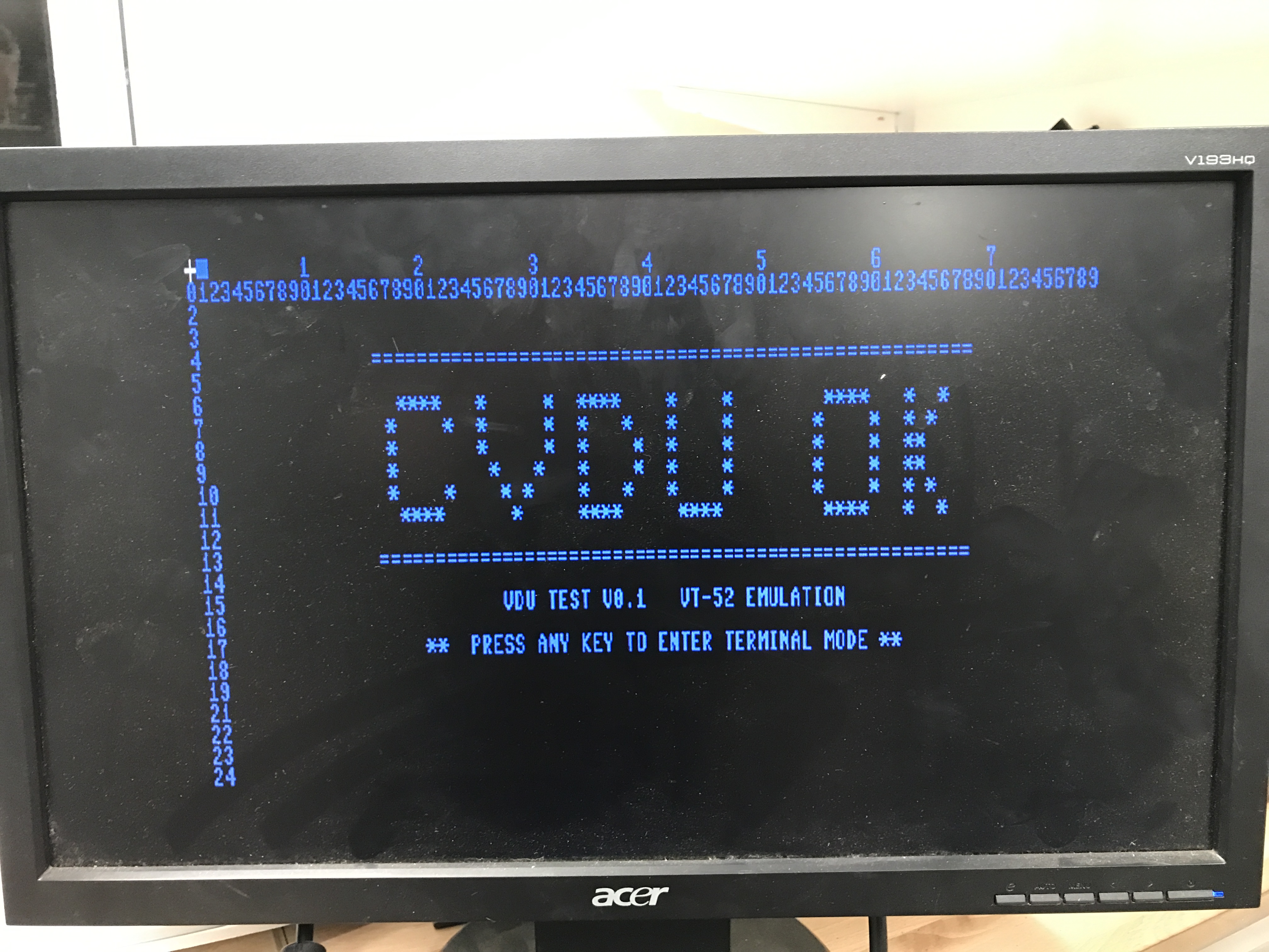

Hi Folks just a quick note in case it helps anyone to say I got the CVDU card working via the VGA style port on an Acer V193HD
When I run CVDUCONS I get a blinking square top right. Any ideas or is that by design? I can't type anything...
(sorry about the edits - uploaded a better picture)
  • Attachment: IMG_0587.JPG
    (Size: 2.05MB, Downloaded 544 times)
[Updated on: Mon, 24 July 2017 05:32]

The CVDU (8563R9 chip) support on RomWBW and SBC-188 produces an EGA timing signal. This is only the second LCD monitor known to sync on that signal:
1. Vizio VA19L HDTV10T
2. Acer V193HD
3. ???
Anyone know of any additional monitors?

The Dell 2007fp can *probably* do it. Mine syncs just fine to 15kHz signals on the VGA port from my Amiga, probably due to the fact that it has composite and s-video inputs.

sorry folks - might be time to get me some glasses, the stylised Q got me. The unit is an
ACER V193HQ (i.e. not HD)
Specification shows Frequency 30 - 80 KHz/ 55-75Hz
