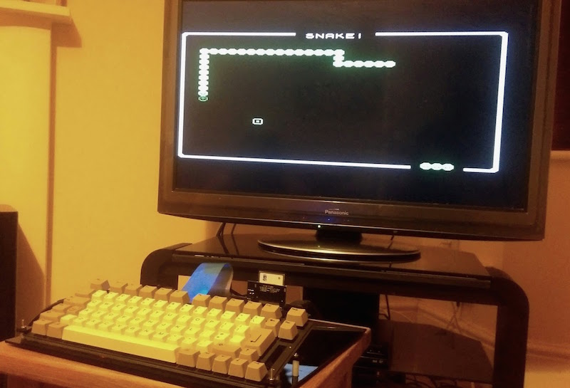

The first is that I really want to write some games for my board. I noticed that the MSX has a decent version of Pac Man, so based on the fact it has roughly the same video and sound, I thought I could write a version as well. So far I have got as far a writing a version of Snake. Smile With the analogue joystick inputs I could also write some cool pong games.

Anyways, here is a few pictures, since this is a whole load of text already.
index.php?t=getfile&id=214&private=0
index.php?t=getfile&id=213&private=0
