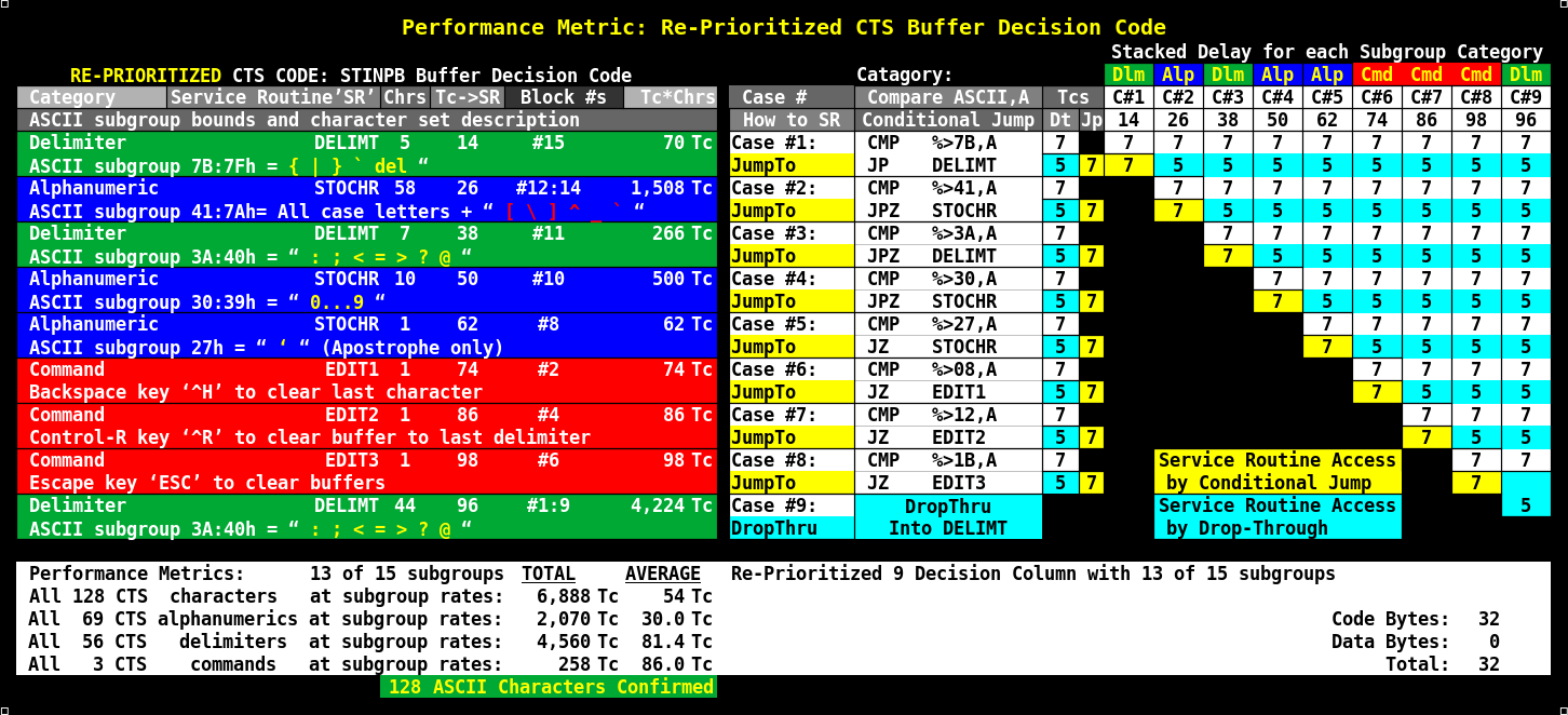

For Efficiency and Speed, Use 8-bit Buffer Constructs Where Possible
The algorithm to convert Text-to-Voice is more than a FIFO buffer. When focus starts of one letter, the buffer will be scanned for letter groupings that might be a pattern for one group allophone. This means that more time is spent in the buffer that is used for Text-to-Voice and some scans will be wasted efforts looking until it can abandon looking further. Due to this nature of multiple scanning for letter pattern scenarios, this buffer should be carefully constructed for efficiency and speed. Whether the special buffer is run in internal RAM or external RAM, it can be constructed to use less than 256 locations. Separating the Algorithm buffer to 16 or 32 bytes would allow it to run quickly. All the math is 8-bit, and the buffer boundaries can be forced by incrementing or decrementing the 8-bit pointers and using a logical AND to remove any out of range values; an automatic wrap-around in the buffer; as one example.
The CTS implementation uses 16-bit buffers and has a flag table to configure its acrobatic algorithm scans described above. The buffer code has to read those flags again when asked to do something. Its big overhead and slows things down. When there is no designated external RAM, the two buffers are created in internal RAM. It uses a 16-bit construct (because it might run a big buffer in external RAM with the same code, if its configured?) The method is to bump a 16-bit pointer then compare it to the over-range value in a 16-bit register pair. If they equal, the buffer needs to wrap-around and another stored 16-bit value is then written over the pointer to make it wrap around. Too much activity when simplicity would be easier to code.
To make matters worse, the CTS code in one of the pattern testing routines, uses the multiply instruction, which run in the range of 44Tc to 49Tc (MPY %>02,B runs in 46Tc) whereas the longest non-Multiply instructions is 17Tc. A x2 multiplication can be done in binary math as a 'RLC B' at 5Tc if the Carry flag is already cleared. Worst case is 'CLRC @ 6Tc' + 'RLC B @ 5Tc = 11Tc.'
In fairness to the original CTS coders, they had a schedule to get the code working so they could sell the CTS. They accomplished that requirement. In addition, poor CPU documentation of an 'interesting' instruction, BR LABEL(B) is poorly documented in all three versions of the CPU manual. CTS coders hacked a routine that worked and moved on using a x3 to jump to a table of 3b BR (Branch) instructions. It works.
In 2024, we have different project constraints and anyone can look at the code and modify it.
This would be a good modification of codespace for 2024+. :)

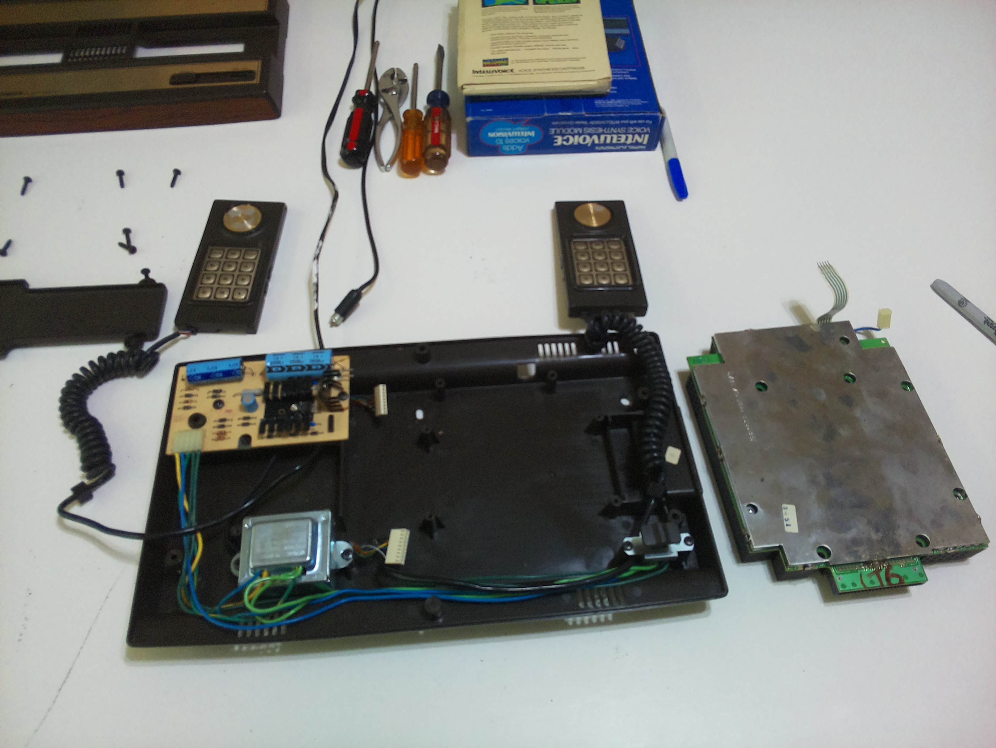

8). Coming Soon... CTS Buffers & A look inside a 'IntelliVoice'

UPDATE: FRI Nov 8 11AM: I think I figured out the paradox of the Question-Mark, among 7 symbol & punctuation characters, that seemed NOT to be buffered. I think they do, by passing through all of the 8 Switch:Cases unaffected and then simply drop through into DELIMT without any hint. If that confirms to be true, I'll incorporate that into my replacement STINPB code and update this message next week.
CTS Buffers: PART 1: STINPB CODE
CONTENTS:
1). Why STINPB?
2). The Default Size of the CTS Input and Output Buffer.
3). Introduction to Subroutine, STINPB.
4). Walk-Through the STINPB Subroutine.
5), How ASCII Characters are Designated by STINPB.
6). Documentation Error on JPZ, "Jump on Positive or Zero."
1). Why STINPB?
I didn't have a plan to follow-up from the SAYOK routine to the unknown STINPB subroutine mentioned in that prior code-block; It just happened because I was looking for more information about the buffers and the way they were parsed when converting from text to allophones. I searched for "input buffer" references in the 2022-Project's added code comments... That led to STINPB. The comments into its Switch:Case logic tapered into uncertainty, and I can understand why... the conditional jumps on the TMS7000 are strange. I decided to update the comments by doing the work to map it out, as tedious as it was.
My purpose for looking was because I had seen that the Text-to-Allophone algorithm seemed to maintain ASCII characters as ASCII characters in the buffer. Considering that the data tables were all index-based for instruction operands in the @Label(B) syntax, it seemed a natural advantage to encode the ASCII characters into a SET.INDEX byte format, instead. That would allow taking the buffered encoded-character and use the high 3-bits as a set designator and the lower 5-bits as a INDEX from 0:31 for 32 possible characters in each SET. I assumed that a lot of ASCII characters would be useless, especially the control characters and some odd symbols that never needed to be voiced.
When looking through the 8 stages of CMP %>xx,A|JNZ LABEL, it seemed like the SET bits would allow buffered letters, unused letters, and editing-commands to be quickly acted upon in large groups, as opposed to the top of the 8 stages being searches about a single character. The CTS code put the biggest block of letters about the bottom of the SWITCH:CASE structure, meaning the most numerous SET of characters that needed to be buffered would have to be delayed the maximum amount of time before they were recognized and buffered. Very bad efficiency.
Thinking of SET bits being (b7,b6,b5) I figured the text-to-voice characters like A-Z, a-z, 0-9, and common symbols and punctuation, would be in four SET using binary 0xx, and special characters would be mapped into 1xx SETs. The code didn't look like the SWITCH:CASE was using the ASCII character set the way I assumed; so I had to give-up or commit to a tedious analysis of its comparison+conditional jumps definition of a set of ASCII characters. I worked on some TMS7000 CPU in a few designs back around 86-89, but that didn't help me fly through the conditional jumps with ease. I did it by making a ASCII table in a spreadsheet, and reading the description of the conditional jumps and the flags and flag pattern oddities.
I worked through it and created a map of the ASCII characters and how they were used, but it didn't make a lot of sense. The control characters were all buffered as delimiters (that would be good if they all were encoded into 1 or so generic delimiters) but the delimited characters were buffered with simply adding B7=1 instead of 0. I can't say yet if the CTS code did that for a good reason, so I have to wait until get through more code, to answer that question.
Besides most or all the control-characters NOT being stripped-out of the buffering, I also found it odd that the Question Mark was not buffered. Voice for a question is often sounded differently. The oddity seemed to be a mistake on my Switch:Case code interpretation. Next I tried doing it a more methodical way, relying on a spreadsheet to simulate the flags and conditional jumps so I could test and be sure how the conditional jumps made groups of ASCII characters to be buffered. I got the same answer using that and it took awhile to get all the mistakes out of the flag rule behavior and then the conditional jump behavior and copy those formulas over to a block were I could insert a value for each of the 8 CASES with their assortment of various conditional jumps, to experimentally find out which pattern created a TRUE or FALSE. I've got the same answer doing it that way, but I'm still not confident for now that I've got it right. I'll post what I mapped out and I'll come back and look at it later and see if I can find a mistake.
Part of MURPHY'S LAW residing in the spreadsheet was caused by an error I found in the 1986 & 1989 version of the TMS7000 DATA MANUAL. The 1983 version had it correct. I describe the error and correction in PART 1, Section 7 at the bottom of this page. The mistake turned a JPZ (jump on positive or zero) into a JZ (Jump on Z, only).
As my purpose was to find out which ASCII characters are used and not used, buffered and not buffered and which invoke special editing on the buffer, I'll describe how the ASCII character set is used, after the STINPB subroutine walk-through.

3). Introduction to Subroutine STINPB:
In the first article about the CTS code, we saw some easy code to make the SP0256 say "O-K". One of the unknowns in that code was CALL STINPB, which is the subject of this article.
Subroutine STINPB's task is to take received ASCII characters, from the upstream serial or parallel port, and to put most of the characters into the input buffer. Some ASCII codes are not placed into the buffer because they are used to issue buffer-editing commands, like (1) Backspace, (2) Clear Buffer, (3) Clear back to last delimiter. They only activate a buffer modifications and are not part of the text that is converted to voice. STINPB does these tasks and executes a CALL RWBUFR to put an immediate character into the buffer.
STINPB is called with newly received ASCII character in Register A. Most of the STINPB code-block is used to recognize single ASCII characters or groups of characters to handle them appropriately. This structure is similar to a C/C++ Switch:Case structure, where a lot of code uses CMP & Conditional-Jumps to route the characters eventually to their correct code-block for action.
The CTS code, in general, maintains all buffered ASCII characters in ASCII form; seems reasonable but not necessarily efficient. When the CTS code (not in STINPB) needs to access information quickly and efficiently, it converts a letter into an 'index' in Register B so it can use "index addressed mode" instructions with their operand syntax: @LABEL(B). For example, to get a single byte of bit-mapped phonetic attribue flags of any letter, A to Z, it encodes the ASCII character into a zero-relative index where "A"=00h and "Z"=19h and places that in Register B. A "STA #LABEL(B)" quickly fetches the letter's 1 byte phonetic attributes without pretzel logic. Index form is also be used to jump to code for processing any letter rule sets, with a BR @LABEL(B). This will be a subject in "PART 2: IMPROVING STINPB."
The STINPB subroutine code-block includes LINE#279->365. The following breaks that down to small code-blocks with a text header describing the activity in the code-block. The listings following that are minimized for web viewing. You can view the full listing with all fields by extracting "The_Reference_CTS_ASM_Listing.lst" from the ZIP-File-01.zip in the second message of this discussion.
4). Walk-Through of the STINPB Code-Block:
Code-Block A: LINES#279->283: Four PUSH instructions save internal RAM registers that need to be restored before returning from this subroutine. LINE#283 clears 2-bits of a buffer control flags in R10, to select input mode, when/if subroutine RWBUFR is called.
STINPB Subroutine Initializes.
; 279:	STINPB	PUSH	B
; 280:		PUSH	R10
; 281:		PUSH	R12
; 282:		PUSH	R13
; 283:		AND	%>F9,R10
Code-Block B: LINES#284->294: This code-block looks for an 'ESC' (escape) character to make the CTS clear the buffer. All other 127 ASCII characters executing only this CMP & JNZ, jump to the next code-block, CASE#2. LINE#287->294 re-initialize the buffer and stack and then jumps to a polling routine to await the next upstream character received by the serial or parallel port.
Switch:Case #1: Does Reg A contain an 'ESC' Character?
; 284:		CMP	%>1B,A		;## CASE #1: Test for an ASCII 'ESC' character
; 285:		JNZ	NOTESC		;## If not, jump to CASE#2. CASE-finding delay through Case 1: 14Tc (CMP@7Tc+JNZ@7Tc)
; 287:		ANDP	%>FE,P0
; 288:		CALL	@INIPTR
; 289:		MOV	%>3A,B
; 290:		LDSP
; 291:		MOVD	R45,R27
; 292:		STA	*R27
; 293:		CALL	@ENINT
; 294:		BR	@POLL
Status: 1 new character done, 1 total processed, 127 still unprocessed and 14Tc total delay through CASE#1 to CASE#2.
Code-Block C: LINES#297->308: This code-block looks for an ASCII Control-R (^R) character to make the CTS clear the buffer back to the last delimiter position saved in a 16-bit pointer. All other 126 ASCII characters executing only this CMP & JNZ, jump to the next code-block, CASE#3. LINE#308 is the final branch to XSTINP, restoring the four registers that were PUSHed upon entry to the STINPB subroutine and then returns to the code that called STINPB.
Switch:Case #2: Does Reg A contain a Control-R Character?
; 297:	NOTESC	CMP	%>12,A		;## CASE #2: Test for an ASCII Control-R character
; 298:		JNZ	NOTCTR		;## If not, jump to CASE#3. CASE-finding delay through Case 2: 14Tc (CMP@7Tc+JNZ@7Tc)
; 300:		BTJO	%>01,R11,LF21E
; 301:		SUB	R25,R3
; 302:		SBB	R24,R2
; 303:		SUB	R3,R52
; 304:		SBB	R2,R51
; 305:		MOVD	R25,R3
; 306:		MOV	%>01,R57
; 308:	LF21E	BR	@XSTINP
Status: 1 new character done, 2 total processed, 126 still unprocessed and 28Tc (14Tc+14Tc) total delay through CASE#1 to CASE#3.
Code-Block D: LINES#310->328: This code-block looks for an ASCII Backspace character to make the CTS remove the last character in the buffer and adjust the pointers. 125 characters are still being delayed until they are recognized at the CASE# that includes them.
Switch:Case #3: Does Reg A contain a Backspace Character?
; 310:	NOTCTR	CMP	%>08,A		;## CASE #3: Test for an ASCII Backspace, BS
; 311:		JNZ	NOTBKS		;## If not, jump to CASE#4. CASE-finding delay through Case 3: 14Tc (CMP@7Tc+JNZ@7Tc)

The inefficiency of this original CTS is apparent in the first four branch-decisions 01-01 though 01-04. By the time the fifth branch-decision begins, the timer has measured 56T(c) and only tested for four characters of the 128 ASCII character set. The remaining five branch-decisions have already accumulated that 56T(tc) delay in their own path to their service routines. The original CTS algorithm-method used is indeterminant, in that it doesn't use the given character to jump to a shorter branch that would more quickly find its service routine. Code that uses the given character to more closely jump to its category recognition branch-decision would be more determinant and efficient, but may consume more code space; there are signs in the original CTS code that suggest that codespace was very tight.
This is why an effective performance-metrics table is needed to compare buffer decision code variants, to identify algorithms that may be worth exploring or rejecting. A previous article about the 'TRAP n' instruction recovered about 128 bytes of code-space, so it is feasible to write new code that consumes some of that recovered code-space. It would be wise preserve most of those bytes for other improvements. This situation is why I decided to dig deeper into the STINPB subroutine and making it more efficient... it can be a learning exercise on coding the TMS7000 series CPU and see the tradeoffs in its instruction set; what it does well and what it does poorly.
The application-note regarding the CTS and SP0, offers a work-around by slowing the baud rate to avoid losing text characters. This suggests that improvements to the buffering of upstream input text characters, and improvements to speed up the text-to-voice processing, would likely reduce or fix the AP-Note problems. A Version 2 CTS code, if ever written, should plan to fix that problem.
COMING UP IN THE NEXT SECTIONS BELOW:
Section 2, "Performance-Metrics for STINPB Buffer Decision Code" will define the performance metrics used to compare various BUFDEC versions.
Section 3, "Algorithm Method 0: The CTS Original: Parsing ASCII into CTS Categories," will define the method used to categorize any of the 128 ASCII characters that may be received from the upstream text portal. Note that the original code is not very efficient in regard to quickly buffering the most used or common ASCII text characters.
Section 4, "Algorithm Method 1: Re-prioritizing Original Buffer Decisions" improves the CTS original BUFDEC significantly and uses the performance metrics tables to confirm it and its a new version that fits in the same codespace. That confirms that significant improvements can be made.
2). Performance Metrics for STINPB Buffer Decision Code
STINPB defines all ASCII codes as one of three categories: (1) Alphanumeric which are buffered immediately, (2) Delimiters which are buffered after being tagged with bit7 and updating a last-delimiter pointer, then (3) Commands that are never buffered and instead invoke a specific service routine to edit the buffer and return from STINPB.

The new version starts processing category subgroups on the high end of the ANSII code values instead of the bottom end as the OLD code above. The OLD DECISION #5 must precede OLD DECISION #8 so that pairing can go first as NEW DECISION #1 & #2. That would push the most of the Alphanumeric to the top of the decision code so that they are buffered much more quickly.
NEW DECISION #1 takes the top 5 delimiters first, then NEW DECISION #2 takes the next top 58 ASCII characters subset=" A...Z [ \ ] ^ _ ' a...z ". Note the six delimiters in between the upper and lower letters. It is assumed that those delimiters are being categorized as alphanumeric for a reason, unknown for now. New code versions, using other methods than this section, will be written to separate those delimiters, but this is just a reordering of the original code so it will use its same 13 subgroups.
NEW DECISION #3 takes the next top delimiters, 7 of them, so NEW DECISION #4 can take the next 10 Alphanumeric, the ten digits, 0...9. What remains of the ASCII table now is four single character subgroups separated by delimiter subgroups which is the way the original CTS code started. NEW DECISION #5 takes the apostrophe as an alphanumeric; all alphanumeric are processed by this point. NEW DECISIONS #6,#7,#8 take the 3 command single character subgroups, leaving only 5 delimiters groups of 44 characters that will be processed by the final drop-through into its service routine, DELIMT.
Here is the NEW version "Re-Prioritized CTS Buffer Decision Code":
;00Tc  xxx:		CMP	%>7B,A	;2b 7t	; NEW DECISION #1: subgroup 7B:7Fh=" { | } ` del "
;07Tc  xxx:		JPZ	DELIMT	;2b 5t 7; NEW DECISION #1: jif >=7Bh to DELIMT as Delimiters
;				(14Tc at jump arrival to DELIMT)
;12Tc  xxx:		CMP	%>41,A	;2b 7t	; NEW DECISION #2: subgroup 41:7Ah="A:Z" + "[\]^_`" + "a:z"
;19Tc  xxx:		JPZ	STOCHR	;2b 5t 7; NEW DECISION #2: jif >=41h to STOCHR as alphanumeric
;				(26Tc at jump arrival to STOCHR)
;24Tc  xxx:		CMP	%>3A,A	;2b 7t	; NEW DECISION #3: subgroup 3A:40h=" : ; < = > ? @ "
;31Tc  xxx:		JPZ	DELIMT	;2b 5t 7; NEW DECISION #3: jif >=3Ah to DELIMT as Delimiters
;				(38Tc at jump arrival to DELIMT)
;36Tc  xxx:		CMP	%>30,A	;2b 7t	; NEW DECISION #4: subgroup 30:39h=" 0123456789 " as alphanumeric
;43Tc  xxx:		JPZ	STOCHR	;2b 5t 7; NEW DECISION #4: jif >=30h to STOCHR as Alphanumeric
;				(50Tc at jump arrival to STOCHR)
;48Tc  xxx:		CMP	%>27,A	;2b 7t	; NEW DECISION #5: chr=27h? 'apostrophe' is an alphanumeric
;55Tc  xxx:		JZ	STOCHR	;2b 5t 7; NEW DECISION #5: jif to buffer it
;				(62Tc at jump arrival to STOCHR)
;60Tc  xxx:		CMP	%>1B,A	;2b 7t	; NEW DECISION #6: chr=1Bh? clear buffer command
;67Tc  xxx:		JZ	EDIT3	;2b 5t 7; NEW DECISION #6: jif EDIT3 to clear buffers
;				(74Tc at jump arrival to EDIT3)
;72Tc  xxx:		CMP	%>12,A	;2b 7t	; NEW DECISION #7: Chr=12h? command backspace to last delimiter
;79Tc  xxx:		JZ	EDIT2	;2b 5t 7; NEW DECISION #7: jif EDIT2 to backspace to last delimiter
;				(86Tc at jump arrival to EDIT2)
;84Tc  xxx:		CMP	%>08,A	;2b 7t	; NEW DECISION #8: chr=08h? command backspace last character
;91Tc  xxx:		JZ	EDIT1	;2b 5t 7; NEW DECISION #8: jif EDIT1 to backspace last character
;				(98Tc at jump arrival to EDIT1)
;96Tc		DELIMT		(96Tc at the DECISION #9 final drop-thru into DELIMT service routine for delimiters.
/forum/index.php?t=getfile&id=3117&private=0
/forum/index.php?t=getfile&id=3118&private=0
The re-prioritized original CTS decision code is much better than the original. It moves more priority characters first. It might be worth seeing if Shadow Pairing would be faster for the upper half of the ASCII table. As stated far above, when 44 Delimiters drop into DELIMT is saves 2Tc of time for each of those 44 characters. Drop-Throughs that 5Tc, Jumps take 7Tc.

Photo #3 (below) shows the IntelliVision opened up with the circuit board or the right, still inside its EMI shielding.
/forum/index.php?t=getfile&id=3122&private=0
