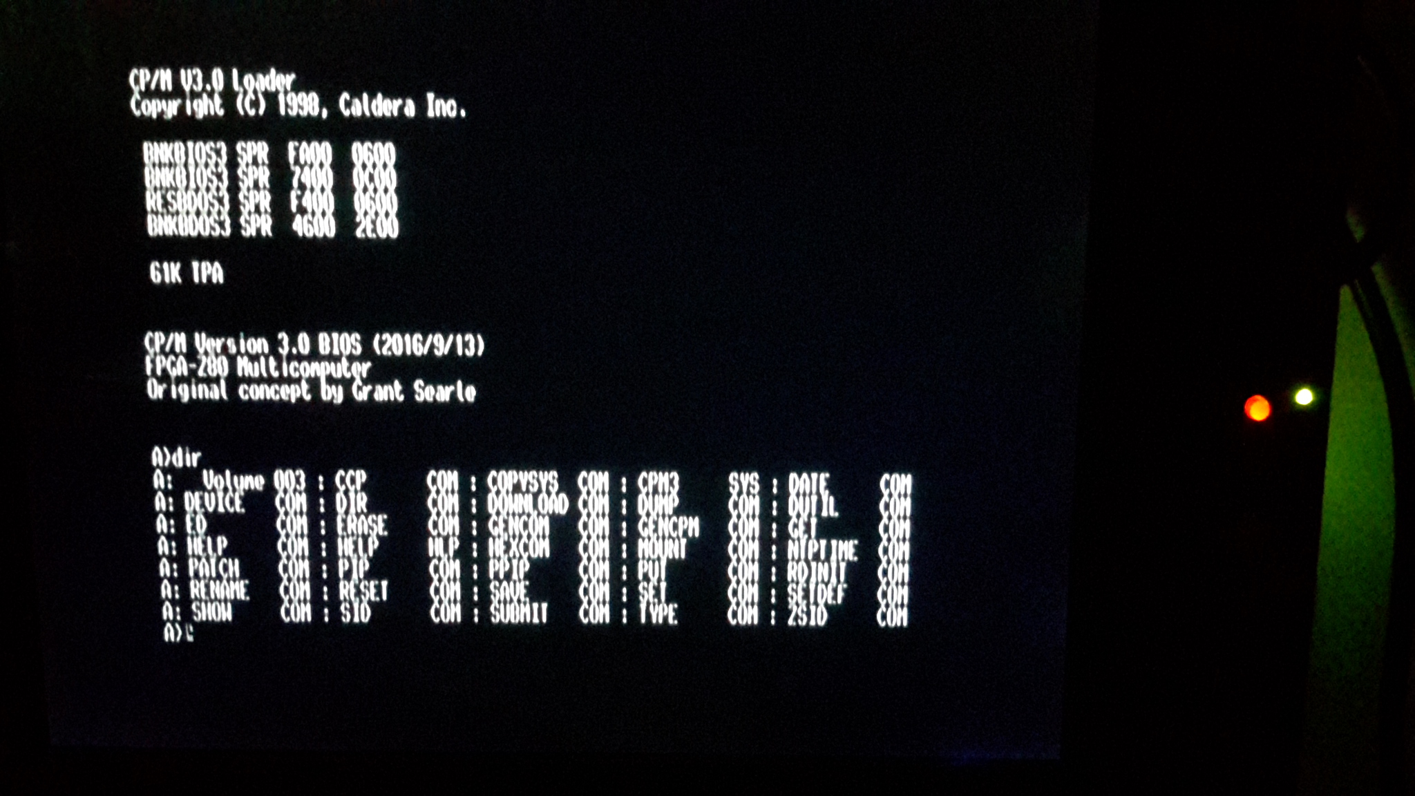

OK, I've been digging around the font question. I know of a rather clean looking 8x8 font for the Amstrad PCW called SanSerif. There's a picture of it in this PCWWiki forum thread I started showing the "standard" PCW font vs. Sanserif:
http://www.cpcwiki.eu/forum/nc100-nc200-pcw-pda600/lousy-pcw -screen-font/
The font comes wrapped in a short program SANSERIF.COM so you just run it at the CP/M command line to get it to take effect. I pulled the COM file, disassembled it, extracted the font bitmaps and generated Interl HEX files using the HxD hex editor. All that's necessary is to place them in the Multicomp\Components\TERMINAL\ directory, then rename them to CGAFontBoldReduced.HEX and CGAFontBoldExtended.HEX and rebuild the design in Quartus.
As I do not have a working Multicomp to hand (it's in pieces pending arrival of parts for the Cyclone II-C board) I can't test the font just yet. It's possible the characters won't look as good as they do on the PCW if the Multicomp's pixel shape is different, but if anyone wants to try, the files are attached.
Re: Superfast Multicomp implementation? [message #5591 is a reply to message #5590] Fri, 23 November 2018 03:20 Go to previous messageGo to next message
rhkoolstar is currently offline  rhkoolstar
Messages: 276
It works. The actual image is a lot sharper...
index.php?t=getfile&id=1148&private=0

I think that'll do nicely... There are a number of other 8x8 fonts that could be used but that's the cleanest looking one IMHO (out of the PCW fonts, at least).

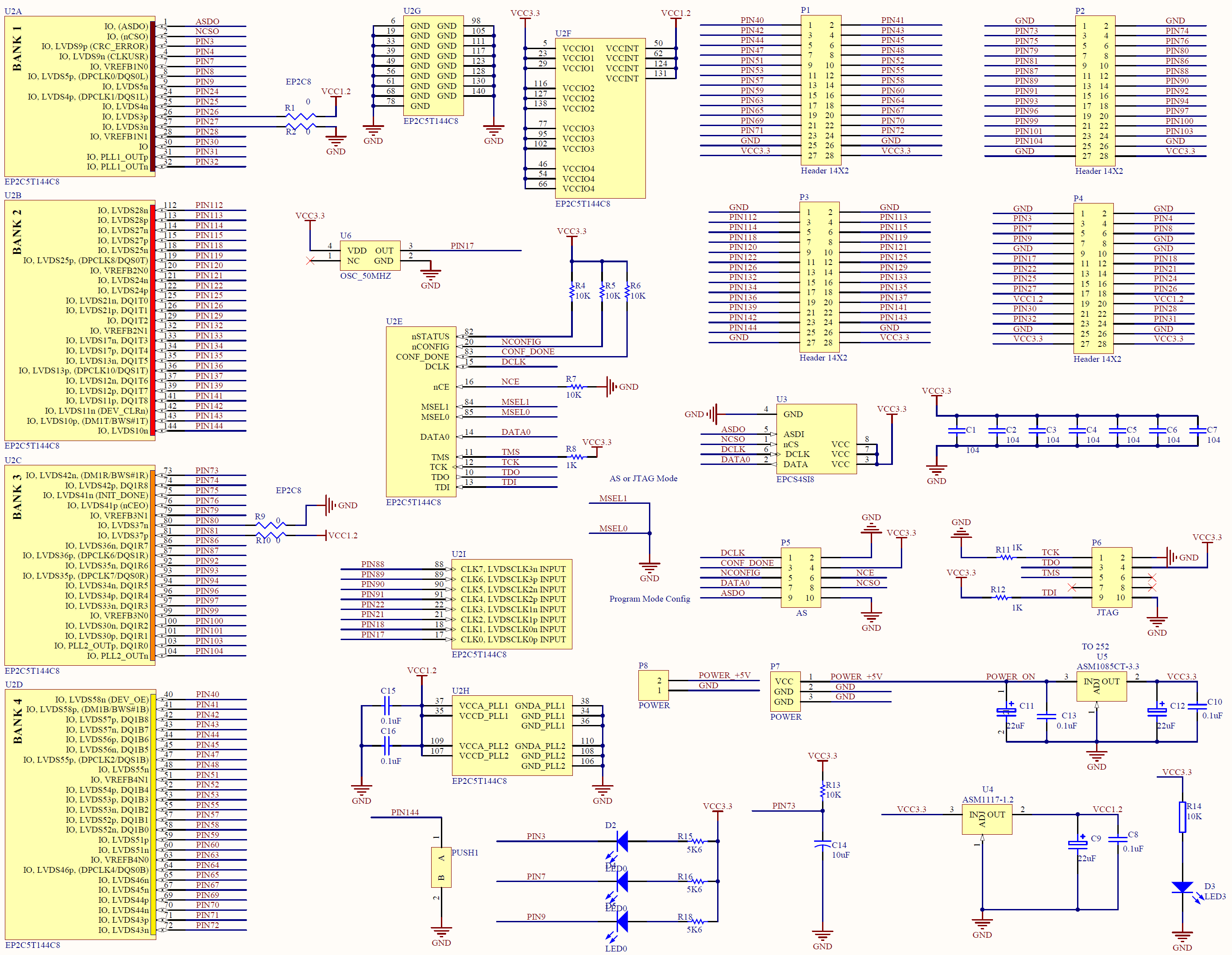

By the way, there are three LEDs on the Cyclone II-C board. The one nearest the SD card is the drive activity light. One of the two others might be a power light. What is the third LED for?
Re: Superfast Multicomp implementation? [message #5594 is a reply to message #5592] Fri, 23 November 2018 06:06 Go to previous messageGo to next message
Messages: 276
Whatever you like. The LEDs are connected to pins 3, 7 and 9 of the FPGA
For your convenience I included the schematics of the miniboard.
